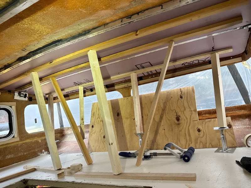

IdahoDoug Posted February 11, 2024 Author Posted February 11, 2024 (edited) Finally getting back to the Sunrader today. With the decision to put two aluminum beams across the sleeper ceiling comes the thick aluminum side plates first. So they went up today and are curing against work on the beams tomorrow. I'm going to try hand bending (well, foot - controlled stomping) as this curve is less critical than the living area ceiling. I have heat lamps on them on the inside and moving blankets hanging over the roof on the outside to preserve heat against the freezing temps. Just before bed, I put my hand under the blankets, standing in 38 degree air and was pleased the outer wall felt warm - so the glue is getting perhaps 70 degree cure time which should have it solid for tomorrow when I will epoxy the beams up like I did back in the living area. Bummed the project has stalled due to cold and such, but hoping this activity will get me motivated again. Great to hear any feedback or comments here as well for that motivation! Edited February 11, 2024 by IdahoDoug Quote
Toycollector47 Posted February 11, 2024 Posted February 11, 2024 I am still watching! I just have no input as I’m new to RVing. Believe me, your experiences are not being lost on me! im better with the mechanical side than the camper side, so this has been a great learning opportunity for me! keep it up! Quote

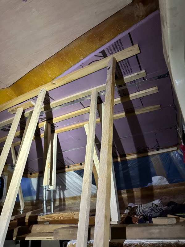

IdahoDoug Posted February 12, 2024 Author Posted February 12, 2024 (edited) Thanks for the props! So the side plates cured over night just fine. Putting the beams up - disaster. When I picked up the aluminum beam, it's sold in a 20 foot length. So they asked how long to cut them and I said 74" which would have given me extra to trim back. If they were going in the back where the other 11 went. Got nailed by the "measure twice, cut once" factor. I missed the fact that the upper ceiling is wider up front in the sleeper, so the two cut pieces are now scrap, and the third longer piece that WAS going to be scrap is now the only beam I could put up today. Argh. Gotta order another full beam just to cut a 78" piece from it and that will take 2 days to arrive. Lesson learned. EDIT: And right on cue this morning. "Sorry, but due to logistics issues we are now out of stock on that item..." Double Argh The gentle stomping got a nice curve out of the beam, and for the second time I'll say to anyone following my lead that you can do this versus all the trouble and time I spent using a high end roller bender machine. Although for maximal/optimal strength you do want the beams uniformly curved. However, I can tell this level of strength is such overkill that a minor degradation would not make any practical difference in handling walking or roof loads, or literally 5 feet of snow. I curved this beam to a 2" peak (measured from the ground to the bottom of the arch). I'd estimate in the sleeper this was flattened a half inch during installation, then headroom minus the I" thickness of the beam itself and I barely got increase in headroom. I figured this would be the case, but I wanted the strength for walkability, and snow load, plus I wanted two hard points to mount overhead storage, and handles to ease getting in and out of the bunk. The factory puts only one handle along the right wall, and it's so close to you when you try to pull yourself in/up it doesn't really help you pull yourself up in one motion. I wanted stable handles at different points for late night bathroom visits, getting over a sleeping spouse, etc. Plus, the incredible strength back in the living area from these beams made me feel if offers protection from something like a falling branch, and laying in the sleeper at night in a windstorm some future night thinking "why didn't I put those protective beams up here where we sleep?" was another benefit. And I plan to make my sleeper hatch that covers the access hole a hinged piece, so I'll be able to use the beam above to mount a stout hard point to hold the hatch open while driving. The side plates may also make for a nice tie down mount some day, simply by drilling all the way through and using a washer on the inside to spread what could be a very considerable load from the outside such as a hammock rope, an awning tie down, etc. Here's the first sleeper beam up: Edited February 12, 2024 by IdahoDoug Quote
IdahoDoug Posted February 14, 2024 Author Posted February 14, 2024 Thanks. Going to put another across and I'm now even thinking of a third one closer to the front. I got up on the roof with this one now cured and was surprised how much it flexes. So I may have made the sleeper roof awkwardly strong. By that, strong, but not so strong I can stand on it. Meaning if I do, the beams may fail and then I've got a mess. So I may have to put further beams up to ensure it's strong enough for a human. Just got back from a drive across state lines to Washington to buy more metal for beams (out locally) plus I picked up a 4 X 8 sheet of Plexi-Glass for the new wrap around windows. Got a few tips on how to cut it from the plastic vendor. They use a custom 60 tooth 10" saw blade. Very coarse and I expected fine teeth but he said those gum up. Hmmm... Got pulled over by state patrol coming home. The Plexi-Glass didn't fit in my classic LandCruiser, which I expected. So I was on the interstate with the tailgate down and the sheet hanging out secured but it didn't look secured. The Washington State Patrol officer was very polite about it and was just worried it was going to fall out. When he saw the hooks on the sheet, all was well. Then I mentioned I thought he was pulling me over because my plate is on the tailgate and he couldn't see it. He deadpanned "Maybe I should write you up for that?" and raised his eyebrows, then burst out laughing. Nice guy. Leaving for San Diego for a week, so my weekend work session isn't happening. Hoping to put up a second beam before I head out, so it will be fully cured before I try the roof again. If I need a third beam in the sleeper, I'm going to need more aluminum side plate - argh.... Quote

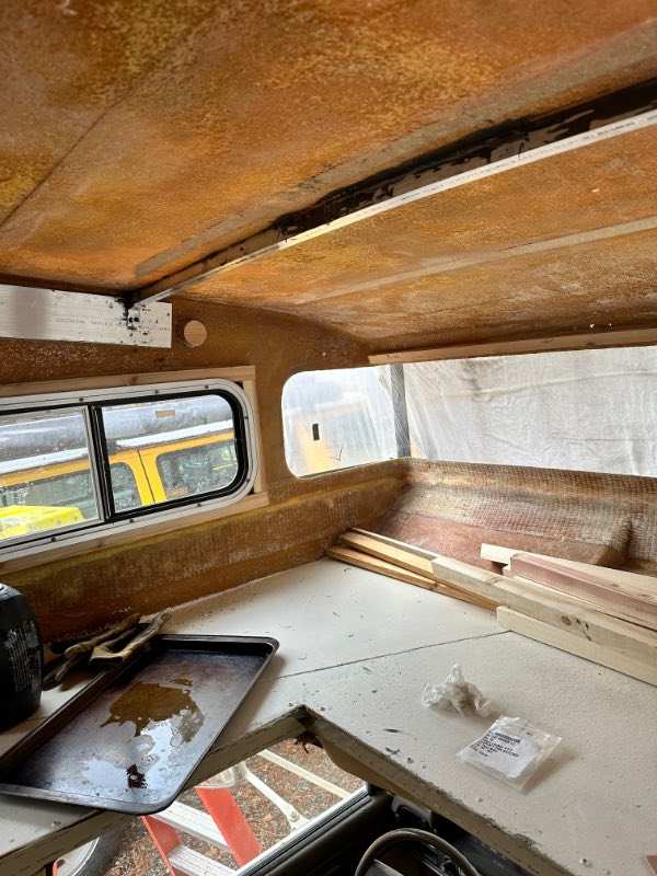

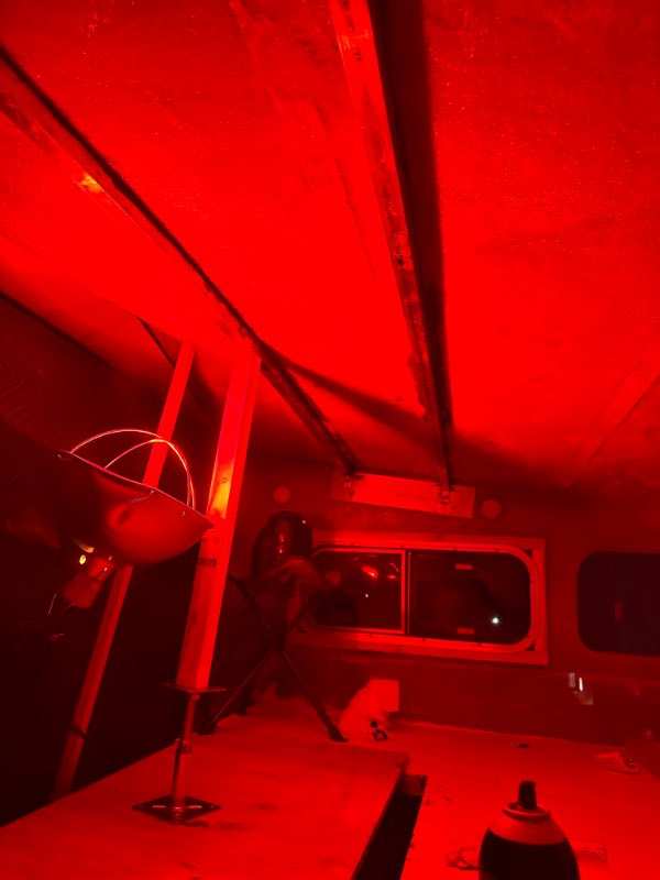

IdahoDoug Posted February 15, 2024 Author Posted February 15, 2024 (edited) Well, out of pure stubbornness, I got out there in the dark and put up the second beam in the sleeper, so when I get back from SD, it will be fully cured and I'll know if I need another beam in the sleeper or not. Pic later as my iphone's photos are not available on the computer yet. I completely screwed up my system for doing these for this, possibly the last beam. Total screwup. It's a bit of a dance once you spread the epoxy the full length of the beam. Working alone, I have to put marine caulk on the screws inserted from outside, through the metal side plate, and through an L bracket I made for each end of the beam. Then I have to maneuver the epoxy smeared beam up atop one L bracket (left loose for space) and then go to the other end, and shove the beam up very hard so I can put it atop the other bracket. To make it especially challenging, I tape a box end wrench onto one bolt out on the outside of the sleeper, so I can install a nut, then tighten it. Repeat for the 2 nut/bolts on each end. Somehow I mis measured and could not push the beam up to get it to line up with the holes. Then the wrench fell off the tape and I heard it clang into the gravel, and I'm standing there unable to let go of the beam to go fix that. You've all been there. Just standing there thinking "how did I get myself into this?", right? Trying to guage how many random tools and pieces of wood I can hook with my foot to bring within range where I might stack it all up under the loose end of the beam, etc. Luckily, my daughter's fiance' happened to arrive and a few shouted instructions through the Sunrader wall later, all was well. So, upward and onward. Edit: The final beam (I hope): Edited February 16, 2024 by IdahoDoug Quote
Ctgriffi Posted February 16, 2024 Posted February 16, 2024 Love seeing the progress—keep it up, sir! It will be amazing to see this thing back on the road eventually, in all its glory! (Great photo ^ too, with all the drama of a Chernobyl investigation, ha!) Quote
IdahoDoug Posted February 25, 2024 Author Posted February 25, 2024 Yes, definitely Chernobyl comes to mind at the moment. So today for the third time (that I recall) I've told my family that this is the "last beam and finally I can start building things in there". I opted to reinforce the sleeper ceiling as the more I thought about it, the more I realized I'll need to install several strong handles on the ceiling so my wife and I can sneak over one another if one gets up earlier to make coffee, etc. Plus the move away from wall shelving for our "night stuff", and of course the obvious safety benefit if a branch falls on the coach. So. How do I know this is the "last" beam? There's literally no more space that doesn't have a beam. I did some quick math for others to know what went into those beams. $5 worth of stainless fasteners on each end of the 14 beams for $140. $20 worth of epoxy for each beam for $280. I've forgotten how much I paid for the beams themselves and the side plates, but it's north of $500 all up. Well worth it, as I can now move about the entire roof, no snow load could collapse it (I don't think 5 feet would do it as the load's spread evenly and would present no point loads, plus it would slough off) from a practical perspective. No flexing to loosen up roof vent or roof A/C. Tomorrow, I hope to get out there and make some serious progress on resealing the side wall windows, installing the foam underlayment on the walls, and possibly end the day with a pink board insulation piece up. Quote

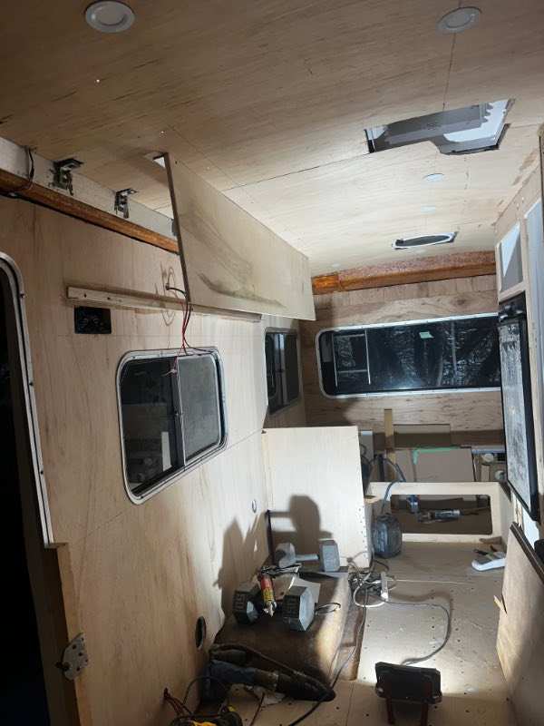

IdahoDoug Posted February 26, 2024 Author Posted February 26, 2024 OK. Cooking with gas now. Realized I could not put the sleeper interior wall fabric up with no new front clearance lights installed. The wires will be covered by the fabric. So I ordered those today. Wow what a painful shopping experience. I stuck to Amazon as at least the products we order arrive soon where other websites are a crapshoot. But can I just say how idiotic it is to be selling clearance lights where you give the dimensions of the product but NOT the distance between the mounting screws? That's 95% of what's offered. Kinda like selling tires without the rim size. That dimension is the FIRST thing you want to know as these are all mounted in thin sheetmetal or fiberglas skins and who wants to drill new holes? Unbelievable. Got two pieces of the pink insulation up as well as the third roof beam - all in 24 hours. Best day of work since December, I believe: Quote

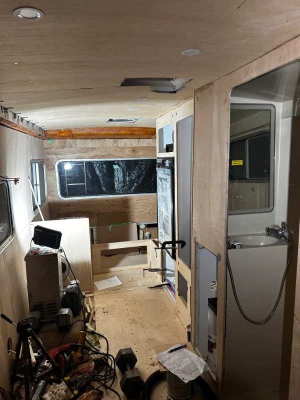

IdahoDoug Posted February 28, 2024 Author Posted February 28, 2024 And finally, the last piece of pink roof insulation is up and drying. One during lunch, one after work. The new front clearance lights arrived yesterday, so I'll install them before covering the wiring with the sleeper wall/ceiling foam and fabric. Can't wait to try stepping on the sleeper roof to see if the pink foam added as much stiffness here as it did back in the main living area. Quote

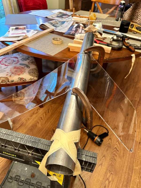

IdahoDoug Posted March 9, 2024 Author Posted March 9, 2024 Today, I cut the plexiglas wraparound windows out. Used a multi tool with a drywall blade per folks on YouTube. Worked well. Now I need to bend them and trim to final shape. There is a protective kraft paper film on it, which I'll have to remove for the bending: Quote
IdahoDoug Posted March 11, 2024 Author Posted March 11, 2024 (edited) Well, I should admit at the outset that bending the windows intimidated me. So much can go wrong and the angles have to be VERY close. I spent several hours measuring things with some findings to pass along. FIrst, I thought "Just bend it to 90 degrees and trim off the rest. Um nope. It's a bit of finagling and finally I started all over once I realized the true challenge. The biggest challenge is defining the center of the bend as it relates to the coach. I ended up using a sharpie and making a few reference points on the old one, then transferring these to the flat cutout. The flat cutout was precise for the long section, but lots of extra material on the short end - like a lolly pop. Once my restart happened, I was confident I'd bend it to the right angle. Then we did some testing: As you can see, I chose clear for my windows. I'm big on seeing things and always have binoculars at hand, special order windshields without the tint band at top so I can see up and that sort of approach. For privacy, I've installed a chunk of wood above these windows so later I will build a single insulated blackout piece across the whole sleeper that flops down into place with magnets for privacy at night. If we later feel it needs a tint, I'll have a tint shop install the perfect tint/heat reflecting product. So I started these tests using those little aluminum nibs as a pressure point on the piece of metal tube I bought - that's what I clamped the still-flat piece to the metal tube we're bending it over. However, the bent section against the pipe went a bit wavy despite our best efforts, and my son came up with the idea of making those wide half moon pieces (chunks of the pipe we were using), to use as clamps on the pipe to force the waves to flatten before it cooled. Worked super well and best was to switch once the part had almost the 90 degree bend we were looking for and then let it cool clamped like that. Obviously we couldn't use the curved parts when the piece was flat, plus the tiny nibs purpose was to let me heat all the plastic, where the curved parts block it and shield the plastic from heat. Make sense? Ask if not. So then we switched to the actual windows. The key is to make a 3D "jig" that the long end will get pulled down to by gravity and rest/stop on something of known height on the floor. We simply used a cardboard box the right height. Then the short end you just push down until you're at about 90 degrees. halfway through this you have to switch from using the little aluminum nibs, to the curved "guides" my son suggested. You'll also see the center section along the metal pipe rise up as the edges are pinched down, and the the heating material wants to expand, so this switch halfway handily relieves that pressure and when you unclamp it to switch, the part settles back down - compression relieved as it can elongate now. In testing we kept hearing this popping sound which we discovered was the plastic wanting to expand against the spots it was clamped to the pipe. Here you can see us halfway through the process, with the heat gun on high: Above, we haven't yet switched from the nibs to the curved guides. Below, now you can see we have switched to the curved guides, finished bending, and the part is cooling. On the near end by the clamp you can see a significant wobble. this was our first full window and we learned how to avoid that on the second one (we're not sure how) but this is a part of the lolly pop end that will be trimmed and if that leaves a little wobble I'll try direct heat with a torch and two pieces of wood to straighten it enough to fit in the rubber seal. Here are the old piece, and the two new pieces. Hard to see the new ones, but trust me - they are there!!! Next step will be to bring them to the Sunrader and tape the long piece in correct position, then mark the lolly pop for final trim. Edited March 11, 2024 by IdahoDoug Quote

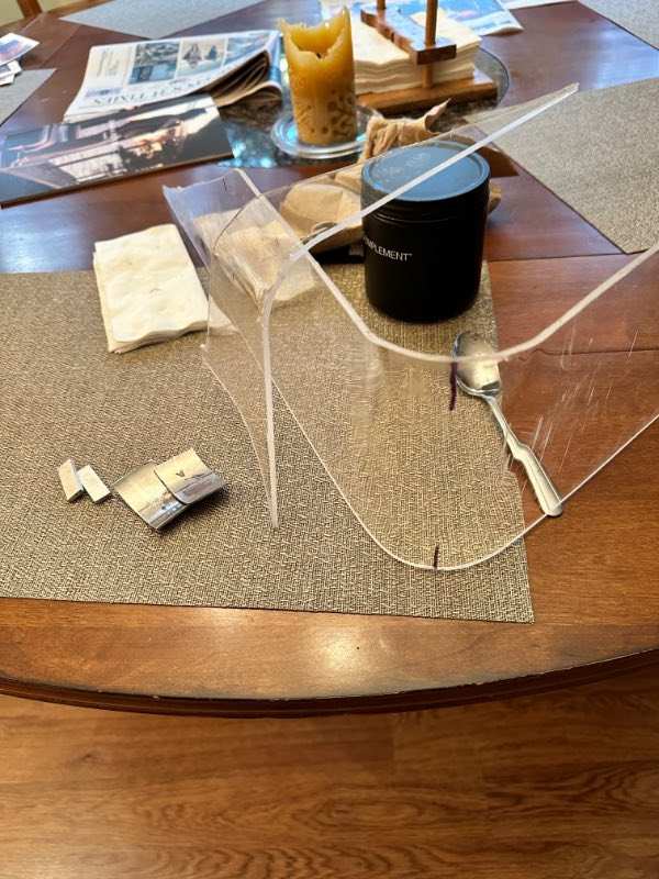

IdahoDoug Posted March 23, 2024 Author Posted March 23, 2024 Well, disaster again. Yesterday, I went out to finish one of the wraparound windows. It's turned out to be a process of cutting it "close" and bending it. Then trimming 1/6 off here, then there. Each trim actually causes the part to change orientation in the Sunrader opening if you think about it. One end rises, the other end drops, and so on. I'm using small chunks of the rubber seal to hold it in place and see where it's still too tight. Anyhow, I was just a bit of trimming away from a finished piece to try putting it in tomorrow when calamity struck. I moved my work table out next to the Sunrader for this fast cycle "trim/check fit" stage. Slightly irritated that it started sprinkling and I wasn't finished (lots of delays), I shoved a couple tools around my work surface and hurriedly moved the piece of foam I was cutting on to protect the table. Window laying on the ground for the adjustment. A screwdriver fell off, bounced once and landed in a perfect gymnastic "10" point down on the window and broke it. Man, this is really testing my patience. I soberly came inside, pulled the remainder of my 4X8 plexi sheet out and cut a new one. Will bend it tomorrow and as it's supposed to snow I will just do other things. Linda's rubber strips arrived and I think they're exactly what I needed, so I'll trim about 10 feet of each thickness into 1/4" strips to match the lips of the seal. Sadly, I also need to pull the trim back around the windows on the inside. I put it there when I first found the seal's gap was too wide, thinking it would help fill the gap. Should have thought that through - it's not firm enough to keep the seal oriented and just crushes. Now its just in the way and freshly glued in my way to boot. More as the story develops - film at 11....... Quote
IdahoDoug Posted March 24, 2024 Author Posted March 24, 2024 Well, I really, really hit a low point here. Every sizable project has these ups and downs. Thankfully the ups typically outnumber the downs by 100 to 1. No idea how I did this, but I cut the NEW window off by an inch, not paying attention to the angle it will be once bent. So, I have some happy news. Yes, you can do all THAT and still have enough plexiglas to cut a fourth wraparound window from a single sheet. Whew. And, BTW, still enough left to replace the door window. I bent the new left window today, and also fixed a wobble in the right window we left out of not knowing what to do with it since it was our first attempt at bending. So, I now have two rough cut, properly bent windows and will restart the "trim-trial fit-trim" cycle all over again but with a better technique I developed. Whew. I'm also going to sell a pattern and instructions for $25 for others who want to give this a go. Two hard-fought items in this will be the proper rough outline of the part, and the critical angle to bend the part. That angle is the franchise, as you'll notice your front portion leans backward, while the side portion is perfectly vertical. Onward and upward. Quote
