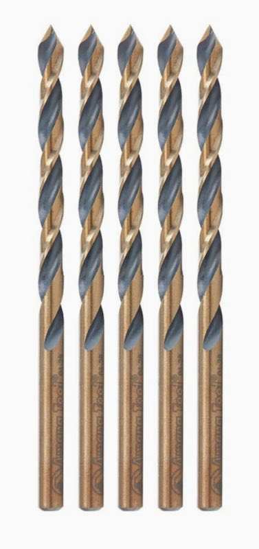

If you’re drilling it, find the right drill bits that won’t cause fracturing when breaking through the material. You can make your own by grinding the point at a narrow angle, more so than the ones below even.

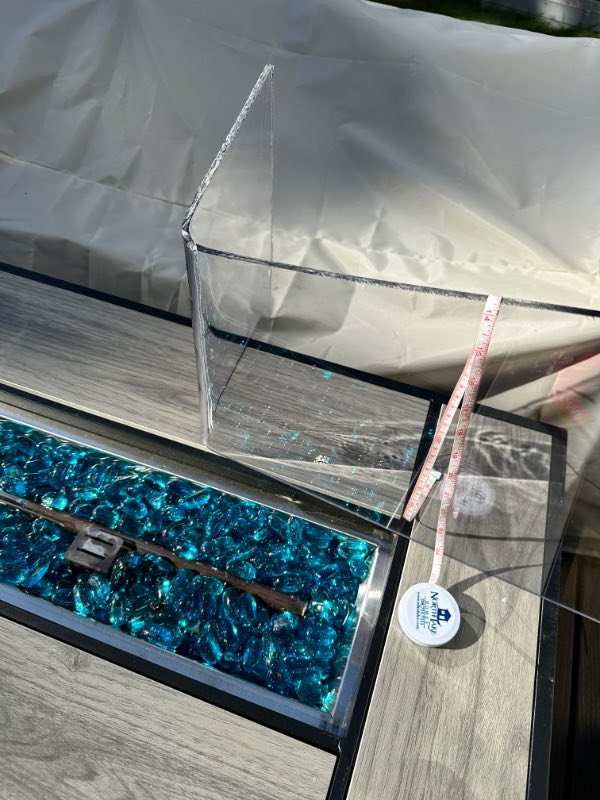

Temperature for forming should be around 370F, and not saturated necessarily, but just enough to be allowed to drape over a form. Ultracal concrete is a great material for that, just make everything oversized and carefully trim later. A sheet of teflon coated fiberglass cloth over the ultracal form prevents any sticking and is a smooth barrier. You will need a trim fixture along with the form to make these.
Another teflon sheet can support the polycarbonate sheet until it reaches TG in the oven, then can drape it over the form, might have to clamp it at the corners to prevent any creeping during cooling.

I do this with the part larger than the final piece, then trim it to my final dimensions after bending. That way, the crucial weird angle (the front portion of the window is leaned rearward) is achieved and bending variations don't ruin it.
Any tips on cutting it?  I used an oscillating tool and several passes on the thinner stuff.  Seems like people recommend a rotary cutter for this?  Thoughts?

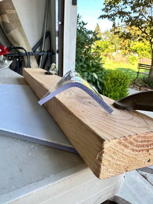

OK.  Got back to the project a few hours ago and here's an excellent update.  Cutting the polycarbonate with a wood blade mounted backward worked great - got that off Youtube.  Super loud - wear ear protection.
I did a very small test bend - just a few inch piece to get an idea how hot it needs to be.  Infrared thermometer said about 275 before it got flexy and I put it down and kept applying heat gun then bent it 90 degrees. I was delighted at the engineer who chose the white protective film as I was able to heat it with this on, and it came off as normal after cooling. That was a terrific development as its easier to scratch than the Plexiglas was:

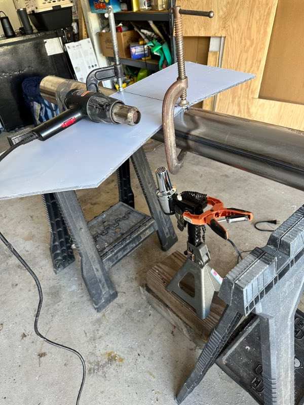

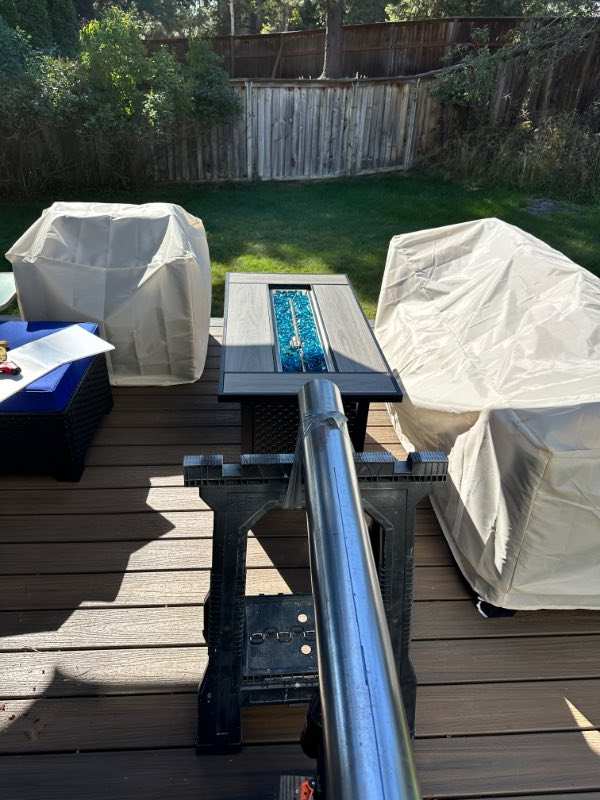

Then, I set up a contraption Wile E. Coyote would be proud of.  Twin heat guns!  I ate and apple and let the bottom one go with a larger test part until it peaked out at 147 degrees F, then started applying heat to the top with the second gun.
Unfortunately, the part peaked at about 240 and I kept at it and could get it no hotter.  Clearly, I was also not keeping all of it that hot as it cools pretty quickly. I was pretty crestfallen and thinking a failure here is going to REALLY set this project back.  I have to get it weather sealed so I can work on the floors and walls or I'll just end up with damage.
Time for Plan M (approx - I've now lost track...).   It will be laughed at over many a campfire over the coming years when pointing at these windows. You see, most people who recently built a deck, and bought a deck fire feature are unaware of its versatility.  I threw the directions away, but could swear when I built it last month there was a footnote that it is also an approved linear furnace to heat polycarbonate sheet.  I will not be checking with She Who Must Be Obeyed on that, but I have a pretty clear memory of reading it.

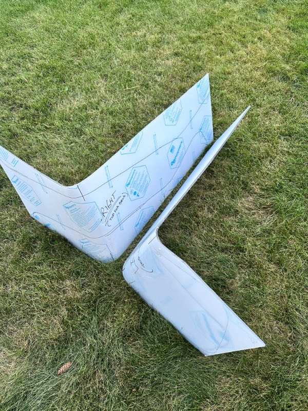

Aaaaaand!  It worked like a charm!  Here's a large test piece on my first try:
So, I'm waiting for my son to come home from a fun Sunday drive to do the actual parts. in the meantime, I'm going to mark the center lines, and such.  Super happy.

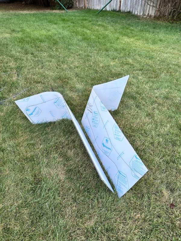

Well, it worked great.  Here are the new rough cut windows cooling in the grass.  Now I cut them to final shape.  In the mean time, I'll test the adhesive, as nobody at the company could tell me if it will work on polycarbonate like it does on glass.  image.jpeg.efedd41486664b50df8b152bfb8e555a.jpeg
Another angle.  The rough cut edges made the above left one look awry:
