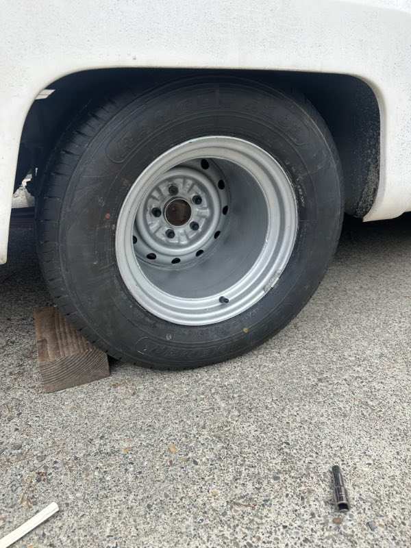

    • Ya mite start here for adapter yokes.
      https://www.yotashop.com/yokes/
      There's these guys also, simpler and cheaper
      https://lowrangeoffroad.com/toyota/triple-drilled-flange.html
