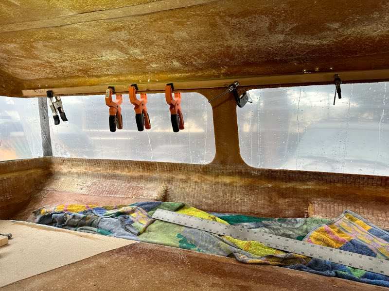

Glad to have that behind me.  I pulled both sleeper wraparound windows, then sanded the sleeper ceiling.  Wow.  Used military desert dust goggles which worked great to keep it out of my eyes.  So much stuff was falling on my face it nearly obscured my vision and when I shook me head to clear it, I could feel it running into my ears, etc.  Miserable.
In the course of this, I discovered a serious issue with the sleeper construction.  The left and right edges of the floor are not caulked.  This allows anything spilled in the sleeper (or window leaks) to get water past the floor panel and down into a large channel that will hold at least a gallon of fluid on each side.  And there's no where for it to drain out.  My plan is to caulk these gaps on both sides, and  ensure that any substantial leak or spill will not cause long term water to sit down there.  You'd never know about this unless you lift a piece of the sleeper floor up.  So, I suggest others remove the mattress and caulk that floorboard against the side.  The front edge is fiberglassed in, so that's fine.
I ordered the EPDM 1 piece rubber window seal and will be sourcing plexiglas and making my own new wraparound windows - bending them over a pipe with a heat gun, then trimming to size by laying the old one on the bent piece to trace.  Anyone see a problem if I bed the seal and window with a modern polyurethane auto windshield sealant?
Some pics.  Had to clean a few inches around the windows so I could tape plastic over them for winter.  That's 30 years of accumulated grundge,  I used window foaming cleaner with ammonia and a scrubby dish sponge.
I know others have simply sealed these up, but I kind of like the trademark Sunrader look enough to work hard to preserve the appearance.  I think the panoramic view while taking a nap will be worth it, though I've yet to experience ANY form of relaxation in my Sundrader!!!!

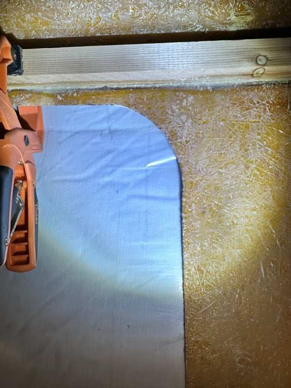

Excellent tip on the dual heat - thanks.  So, my plan is to cut the plexi roughly to shape - leaving several inches in every direction. I'll then bend it to the angle, and it looks like since the front portion "leans back" I'll need to accomplish that so the plane of the side and plane of the front are properly oriented. Then, I'll draw the outline of the old one on the bent piece for reference, cut it down to within 1/2" inch and then continue trimming until the piece is uniformly matching the hole.  I expect this to take a couple hours to shape each piece.
I got the EPDM "Trim-Lok" seal version which has an integrated "key" you pry into place once the window is in.  I agree with you the rubber *should* seal it properly and for decades, but I think I'll put a sealant as yet undecided down in the crevice of the seal.  I am going to be heartbroken if those windows leak and others have had it happen even with new windows and new seals.  I have to admit i may not be any more capable than those folks and the sealant will take up any slack.  Also, there is huge variation in thickness on my fiberglas edges - a quarter inch for a third of it and 3/16 for much of it.  Considering the pressure of driving 65 in a driving rain pushing water against those seals, I just don't want to deal with all the work I'm putting into the sleeper getting ruined.  It's white fabric and may instantly and permanently stain. And considering it's where we sleep, it would be pretty disheartening to arrive somewhere and find we have wet bedding. I may talk to or even pay a window guy (they'll have tools I don't) to put them in once I cut them to size.  I live in a small town where I may take only $50 cash for an experienced window guy to do it after hours if I come to him, etc.
Take construction paper and tape it to the old window, mark it and cut to shape. The you can lay the pattern on the flat plexi and adjust the size to your plans.

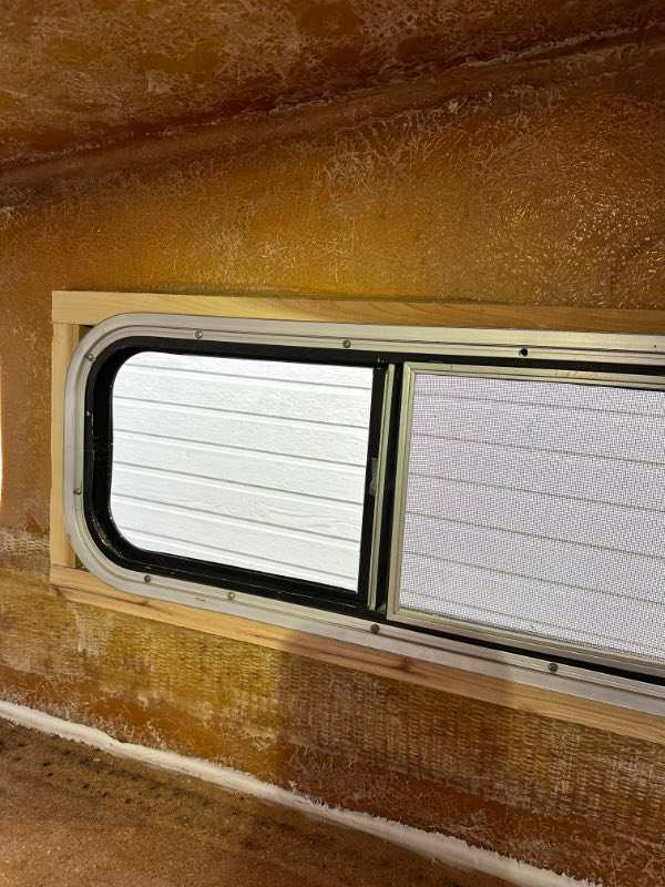

Which windows? The space required on my side windows is 7/8" for the aluminum interior trim.  This pulls the windows hard against the exterior for a good seal.  So, I got some 7/8" cedar to use for the window surrounds. Is that what you were asking?
In case it's the wraparound windows you're asking about, yesterday I found a local source for the plexiglass, so I'll go buy a 4X8 sheet there for $120.  If I have enough left over and the fit is nice I think I'll make a second set and sell them here to defray some of my project costs.
I've been noodling on how to make window covers for the wraparounds.  I want that front wall to be a thick cushion of insulation when covered as my wife will sleep on that side.  So, I'm going to put wood strips above the windows before I cover the walls with the foam and hull liner.  Then I'll make a multilayer fabric insulated/padded full length cover, attach its upper side with a full length piano hinge, and use magnets to hold it up against the ceiling when not in use.  At night (or sunny days to block heat), it will simply swing down against the front wall, and its bottom edge will be held tight by the same magnet strategy.  This has been holding me up from trimming out the sleeper area as I have to decide this, mount wood, then cover it.  Can't put the sleeper fabric covering in place, then tear sections out to mount something.
I also had to decide where the reading lights will go and put wood blocks there to screw into, make provision for a sturdy handle for us to use getting in and out and mount wood blocks there to screw into later, decide about the little shelves in there for reading materials, cell phone holders, cell phone chargers,  a place to plug a marine rubber bladed fan in and something it can mount to for hot nights, etc.  It's been a pain and has held me up for a few weeks now getting all this straight in my head.  I think I've got it mentally drafted now, so time to draw it out, then epoxy wood chunks, and finally put up the fabric.
I also need to build the square filler panel that fills in the sleeper hole as mine came without one.  Anyone have a photo of how Sunrader made that thing?  Is there a metal strip around its edges that lays down against the floor to prevent the wood filler piece from falling through?  Or?....
Yes, Doug, the side windows. My sleeper side windows and the big cabin side windows appear to be the same thickness inside the trim flanges when screwed together bare, 7/8". The inside aluminum flange is exactly 3/8" and my sleeper side windows, (still mounted and sealed) have a hair less than 3/8" showing. I've been testing with a piece of 1/2" foamular @ different spots, including the back window,( mounted yet with flange installed), and if I put any kind of paneling 1/8 minimum, should be tight and close to seating the middle frame. Not to belabor the point, just more info.
So, slightly MORE stack height (panel plus seal, etc) is OK. Problems happen if there's not enough stackup.  Then the screws will draw the inside aluminum down and bottom out on a short stack, and not pull the outer seal of the window against the coach outside wall.  Worst case is you'd need longer screws.

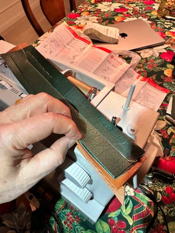

Wow, just as I suspected - some other craft/skill folks on here.  So, the plan was to oil my wife's 30 year old machine, get a walking foot (helps) and see if it could handle the leather.  No dice.
So I picked up a Singer Heavy Duty, which I watched a knowledgeable guy online test severely, and then disassemble to find it was indeed a well found machine.  Metal frame, bearings where others have bushings, metal parts where others use plastic, etc.  I owe the guy.  For a mere $199 at my local  Jo-Ann's I snagged one, ran back home and an hour later had it set up.  Here's a picture of it's work:
I didn't know diddly about sewing after a 50 year hiatus, but it sewed a perfectly straight line, didn't miss a stitch, or even change stitch length a whit!  Didnt even need help self starting, and you are looking at 2 layers of the nutmeg leather I'm going to use and 2 layers of the marine grade vinyl I'm using for the welting (the green is not what I'm using).  So, I'm in business!!  Tomorrow I'll buy 2 full hides, the foam and the blue vinyl I'll use.  Yahoo!!!!
i would like to suggest you make the stiches longer (less stitch per inch) . what i see is an easily ripped seam on vinyl and leather
Not that I know anything about sewing, but my wife has been doing it all of her life. I agree with extech about the stitch length and also, try using a bigger needle and heavier thread for more strength. Not meant to criticize, I think it's neat that you are willing to tackle this part or your build. I'm lucky, I would let my wife do it.
Hey, very much appreciate the stitch length comment, Extech.  You guys are correct - I reset it and researched and that's the right way to do it.  I also got a bigger needle, and 2000yards of 92 thread.  With me, don't EVER not say anything concerned I'll take it wrong.  My approach to life is to always voraciously process advice as someone's input to make me or my project better.  It's kinda sad society in general has made us all sensitive because people do not take advice well.  However, consider me an old dog who LIKES new tricks!!

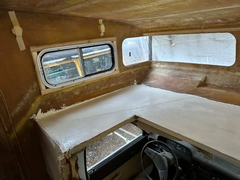

I got back on the sleeper today.  Made the decision to install aluminum beams  on it's roof also - primarily to install a handle, and use as a structure to install some ceiling netting above our heads to hold cell phones, books and such up out of the way.  I was going to do a shelf, but it would interfere with the insulation layer, foam layer and padding layer enough that would have diverted too much time.  Overhead netting is a better move as you can look up and see what you need to grab, vs feeling blindly up on a shelf.  Plus underway, nothing will fall, again vs a shelf above our heads.
So I decided where the gooseneck reading lamps will go and glued up mounts (tape is holding them in picture) and painted the "floor" with Kilz to block off a bit of mildew there.  I replaced the far corner of the floor with new, caulked the edges as the factory should have, and now its painted.  Before doing that, I decided where the two roof beams will go and reground the with the sander to be sure I will get a secure grip with the epoxy, then vacuumed the entire ceiling and floor before painting.  This sleeper is driving me crazy, frankly.  Thinking of ways to cover the windows, power for cell chargers, reading lamps, new wraparound windows, the ceiling, etc.  I'm starting to ratchet down some of the details in favor of keeping the project moving. I need to insulate it, and install the ceiling and wall upholstery, so I can install the piece of wall behind the bath and reinstall it.  Those two wall surfaces come together.
