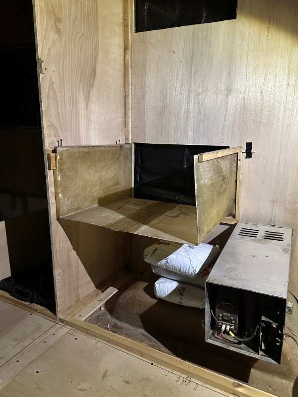

  6. So, I am looking for an igniter for my furnace - original type with 2 wires. My 1982 model is an NT12LE, and I bought a 525019 igniter off the Suburban website. It's got the same two wires, the same bolt pattern on the mounting plate, and the same 3 prongs on the furnace side (2 igniter prongs, 1 temp probe prong). Has anyone else been able to find a source for these? Mine works, but we plan remote trips and I want to carry a spare. Thanks in advance.
  7. Whatever you choose, buy a couple extra against the possibility one or more fail and the exact model is no longer available to replace. They're pretty cheap.

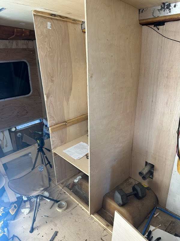

  9. That's a clever idea - gave the oil time to thoroughly migrate into the bearing. So, today I got the 90 degree wall next to the bath unit mostly done. It friction fits in place and is held in by itself. I need to paint the back side of it, and cut a hole for a 120V wall plug. I'm putting one in the master closet (this is the forward wall), so we can charge things in the closet like laptops and cell phones out of view. Everyone seems to want to charge their stuff out on counters, but if I'm away from the vehicle, I'd prefer some concealment. This will have several USB ports as well as house current. There will be several other outlets around the RV as well, of course. Looking forward to installing this soon.

  11. Good point. I opened the burner up last night and it looks brand new - zero soot or blackening. Wonder if it was barely used since the vehicle has only 32k on it? I'll look at the fan/bearing very closely. Even light use would not make up for bearing grease/oil that's hardened with age. Perhaps I can sneak a lot of oil in there. I have a device that helps lubricate bearings by pulling the tiny rubber seal back and pressurizing it. Yeah, looking for a quiet motor.....
  12. Pulling the heater apart to do some maintenance on it. Brought it to an RV dealer, hoping he might have some NOS dual wire igniters. Mine works fine, but I want to clean it inside, check for leaks, eliminate the gas on/off switch, lube the fan motor, and carry a spare igniter. I believe I found one on eBay - will be here next week. Mine worked just fine before I gutted the Sunrader. I will clean the glass view port, the burners, put new gaskets on the access plate and igniter, and it should be good for years. He knows classic Suburban heaters and says the NT12LE is a very solid and dependable model. He gave me valuable suggestions to refurbish it for long term durability. It's a pretty simple appliance, really.
  13. Wow, looks like you're doing more than "thinking about it". It's done!
  14. Thanks. Fortunately, it's the kind of hobby vehicle I can physically enter to work on, lending itself to a couple years of on again/off again work. During this, our daughter got married and I finished restoring an '88 Supra, plus built a very large deck. As many of you know, sometimes a project gets exciting and rivets your interest again. That's where I am right now. Here's the other wall abaft of it, precut and ready for install. Don't be impressed that I did that so fast - I cut those out last fall and they sat as I realized I had to do the bathroom wall first. The skinny piece sticking horizontally out is a chunk of the baltic birch ply I'm using. Wanted to see if I left the right amount of room for a right angle wall to fit between the bathroom wall, and the unmounted wall - it's a friction fit! (for that, I'll take a bow...) Now I need to service the furnace, and lay out some new plumbing. Kinda bummed the water lines need to go right through the box where I'm installing all the electronics, but it can't be helped. Power center, fuse box, inverter, charge manager, etc. I may find a way to use a split PVC pipe or similar to isolate the water lines as they pass through there. Can't imagine having $4000 worth of electronics ruined with a simple water leak.
