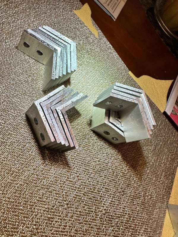

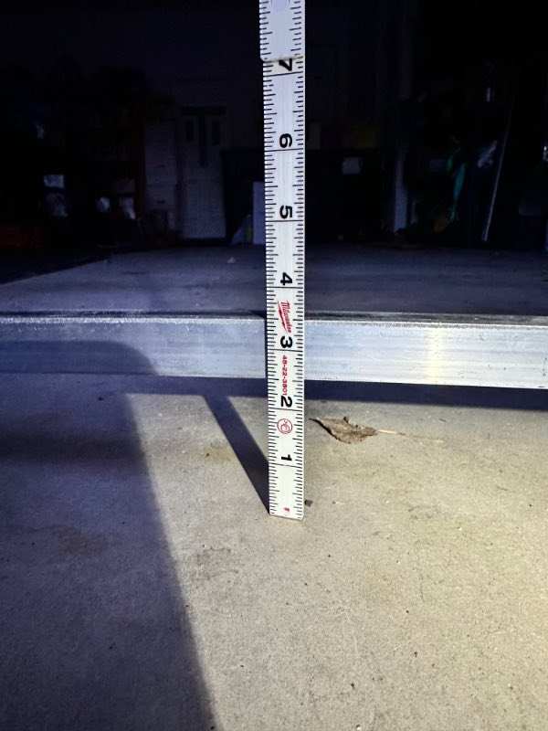

Super cold here this evening and all I had time for was to test fit a roof beam, and make the 22 brackets that will connect each beam's end to the sturdy aluminum side plates.  Here are the 1/8" thick brackets, drilled where they'll attach to the wall, and bent slightly greater than 90 degrees to match the upward slope of the curved beams as they arrive at the plates.  Once the beams are resting on the brackets, I will drill the final hole that will connect the brackets to the beams to augment the epoxy:

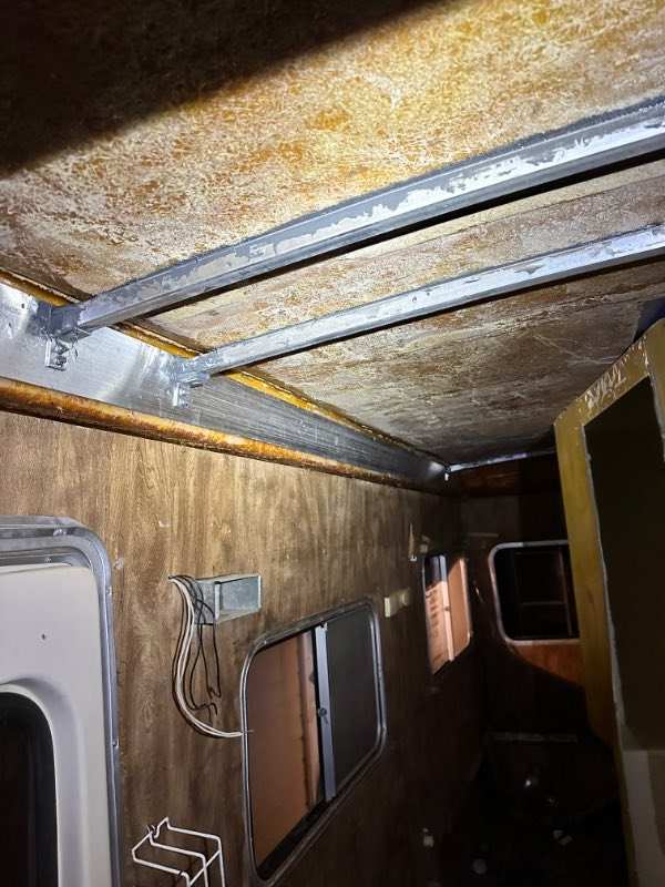

Well, I installed the first 3 roof beams today after many false starts and changes in direction requiring hardware store runs for different fasteners.  Originally, I wanted to avoid drilling any holes in the roof or sidewall, but it was not to be.  The beams terminate at a thick 10' aluminum plate and I'd planned to drill and thread into this for the vertical loads of the beams.  However, the thread tap has a taper on the business end as well as a pointy nose to stay centered in whatever work you are doing.  As a result, I could only thread the aluminum plate about 2/3 of its depth and I was not confident that reduction in fastener connection would handle the heavy roof loads I have in mind.  So, off to find stainless hardware and marine bedding compound.
I drilled clear through the plate and fiberglas wall, used washers and now there is a solid mechanical connection of the beams, as well as a full length epoxy joint against the roof, and further epoxy where the beams meet the walls and thick aluminum brackets I made.  It's an upgrade in strength and ironically solves a conundrum I've been mulling.  After the beams are installed, I wanted a way to know EXACTLY where the beams are in the event I want to drill into them later for a roof rack, roof hoist, roof tie down anchor points, etc.  Now the two screws at each end of each beam solve that handily.

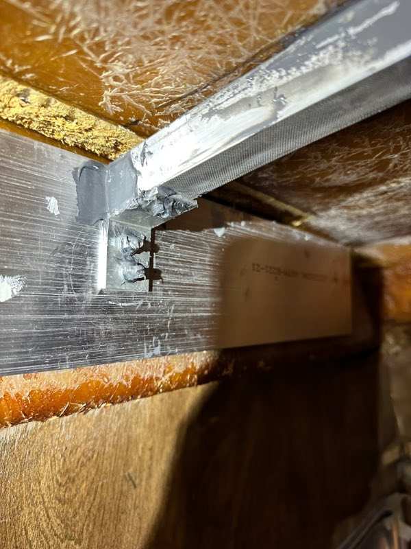

So, here are the front two beams:

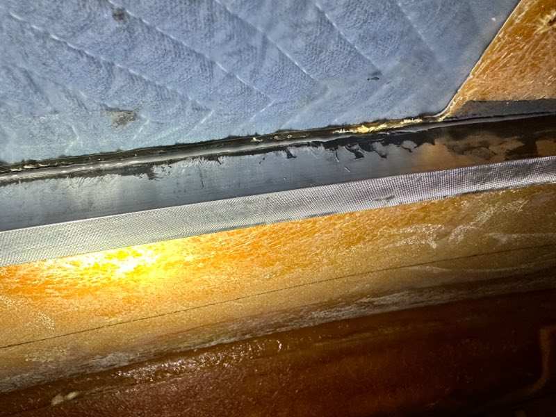

A closeup of the beam/side plate joint.  Note that I smeared epoxy all over the joint to further stiffen it up, lock the fasteners in place, and I hope to never hear so much as a beam creaking when I go over twisting bumps, etc.  Nothing worse than a creaky roof, and this should prevent any movement.  At the end of each beam, just before install, I shoved a teaspoon of epoxy into the hollow beams, knowing the epoxy would flow against the side plate to provide an even stronger and immobile overall joint.  Each surface was roughened with 60 grit, then wiped with brake cleaner for maximum adhesion:
The sides of the beams have random smears of epoxy on them, as I deliberately bedded them thickly with epoxy to account for unevenness of the fiberglas roof surface to achieve a 100% solid connection between - no air pockets or low spots in the uneven roof that are not full of epoxy the entire length.  So, it naturally dripped down the sides and I scraped off the excess as I will be putting Foamular insulation tightly against the beams and want a smooth side of the beam - not rough drips of epoxy.
Here you can see the "squeezeout" of epoxy at the rear vent hole - indicating full contact between roof and beam.  There is clear plastic over the hole, and the blue fabric is a moving blanket I have up on the roof to hold in some heat tonight to cure the epoxy.  I have a couple of electric heaters running full blast and it's keeping the space at 70.
I could have kept putting up beams, but I quickly discovered adjacent beams will cause interference.  I put one in the rear, then moved the rams to do another and noticed it was starting to lift the fiberglas off the still wet roof beam.  So I went to the front and put two beams in that happened to play well with each other, plus I did not use the ram to lift.  My new technique is to manually shove the beam up, mark where the bracket will hold it, drill and mount the brackets, then insert the epoxied beam into one, leaving the other bracket secured loosely by one bolt.  With one end in a bracket, you just push up the beam hard enough to get it into position for the other side, swiveling that loose bracket into place and resting the beam atop it.  Then install the second bolt in the bracket to secure it and wait for the excess epoxy to finish squeezing out.  Scrape that out and repeat.   So on my next session, I won't be using the rams to lift the roof as they interfered with the wet beams, and will be able to move along more quickly.  That will be a relief as I am also regularly banging my head on the low hanging wooden rams.
What I like most about this solution is that the beams don't reduce headroom at all if someone plans to replace the factory roof insulation as I am.  The 1" Foamular will be quite an upgrade compared to the then-state of the art of styrofoam, and when that's done I will have a uniform surface to glue roof paneling against.

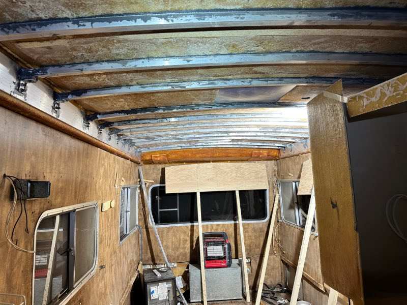

And the roof beams proceed apace.  Here's looking rearward with 3 beams in place up front, one at the extreme rear, and the ram is holding the roof up in position for the 4th beam from the front, which is at the rear of the forward roof vent opening.
Wahoo! 4 beams left of 11.  The actual installation time is averaging about 1hr, 10 minutes.  Here are the steps, after of course bending them, cutting to 6', making the "L" brackets, obtaining the epoxy and obtaining the 154 stainless fasteners.
1 - Trim the ends of the beam to fit the exact spot so it will sit up there friction fit.  I am using a chop saw with an aluminum blade, and the rough angle on the saw deck to match the slightly angled tops of the walls drawn on paper and taped on the deck as a reference line for trimming them.  Takes about 4 cuts as you carefully zero in.  Cut too much and the ends will not be tightly against the heavy aluminum side plate. You want them to be in actual contact as to flex an arch, you have to spread the ends.  Don't give them room to spread.
2 - Shove the beam up as high as it will go, and mark that highest level with a sharpie on each end.  Choose a bracket for each end and mark them "R" and "L" as my drilling holes in the bracket aren't perfectly consistent.  Hold them up and mark on the side plate the center of the holes for drilling.  Drill the holes all the way through the wall on both ends.  Go out sided with brake cleaner and clean the area around the holes.  Get a bolt/washer, coat the washer with 3M Marine Bedding Compound and go back out to put them in from the outside.  You'll need a ladder on each side. Put a box end wrench on one of the bolts of whatever bracket you'll install first - I always did the Right ones first.
3 - Back inside, put the Right bracket up, install the nut and tighten it against the wrench on the outside. Go back outside and switch the wrench to the other bolt head.  Back inside, tighten the second bolt so that bracket's secured.  For the left one, only insert the lower one all the way, and make it finger tight so the bracket is hanging upside down and switch the wrench to this bolt.
4 - Mix a full pair of the large tubes of JB Weld Original epoxy.  No fast cure version - the strongest original formula is their best.  Wipe all around where the roof beam will touch the side plate, the bracket, and INSIDE the end of the roof beam with brake cleaner for max adhesion.  Spread the epoxy about 1/8" thick the length of the top surface of the beam - stopping a couple inches from the ends as it won't contact the roof.  Put a thin smear on the underside at the ends where it will mate with the bracket.  Save a thimble full to put in each end of the beam, which will flow toward the wall and provide even more adhesion.
5 - Place the beam in the right side bracket, and keeping it properly aligned, lever the beam up against the roof, with your eye and hand at the extreme left end where you'll be prevented from perfectly centering it by the lower bolt holding the bracket loosely.  Once it's pushed up above the bolt, move the beam to center it above the bolt.  Now swivel the bracket up under the beam while shoving the beam very hard to flex it beyond where it will rest, then let it down onto the bracket which is now properly positioned.  Tighten the lower bracket bolt, then go back outside to push the upper bolt all the way in and switch the wrench to the upper bolt.  Back inside, tighten the upper bolt.
6 - The bracket will have another hole you'll insert a screw in to pull the beam and bracket tightly together, but you haven't drilled the hole into the bottom of the beam yet as they need to match up perfectly and now's the time.  Drill the hole in the bottom of the beam and install the screw.  Watch how as they come together a satisfying smoosh of epoxy comes out, showing these parts are mated for life.
7 - Now check carefully along the roof/beam mating surface to see that all along the length you also have a nice smoosh out of epoxy - indicating there is no air between them, just soon to be permanent bonding from the epoxy.  Use the scraper to remove the excess because you don't want that lumpy ridge up there later when you're fitting hard foam board between the beams, and you have a use for that excess.  Scrape the excess back onto the pan or whatever you are using to mix the epoxy into.  If you find a spot without good squishout, just jam some in there.  Do this on both sides.
8 - Now take the excess epoxy and make nice fillets where the bracket and wall plate meet, smear some around all the edges where the bracket meets the beam, then put some on the bolts/threads so nothing can vibrate loose with years of happy Sunrader motoring ahead of you.   If you were using the wooden ram to push the ceiling up (you'll use it at first but less as the roof is being held up by more and more beams), take pressure off it so the full weight of the roof comes down on the beam and it's at its natural resting place.  Trim any excess squishout.
9 - Go inside and use warm water to clean the epoxy off your hands, clean the mixing plate and your scraper and set it aside to dry.  Now do this 11 times.

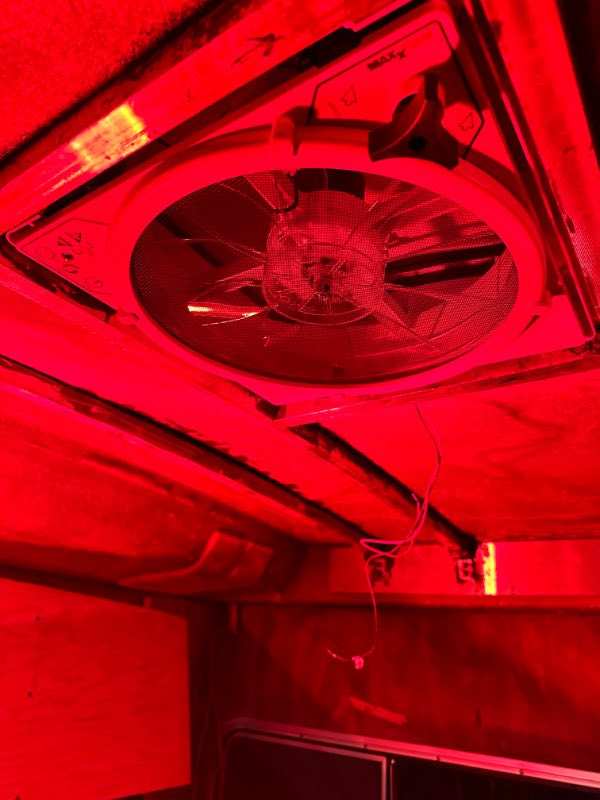

Then adding an electric vent fan in one hole vs plain one it came with, so a few more pounds!

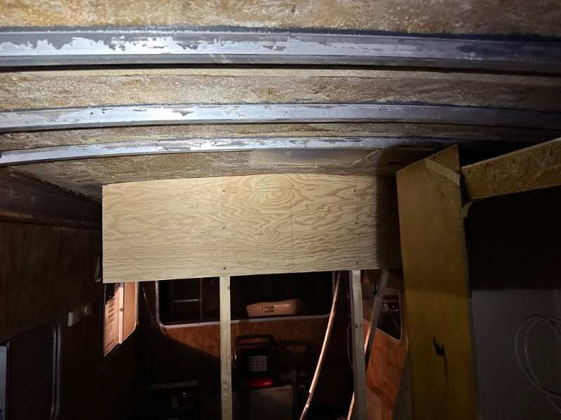

Well, super happy to say that all 11 beams are up.  The last 3 are now curing.  Tomorrow, I'll put the aluminum struts around the vent holes the new vents will screw into for a stout frame.  Sunday I may mount the MAXX vents.  I'll have to gin up a cardboard box with a heater in it up on the roof to get the self-leveling goop to do its thing.  Heck if I can find a big enough box, I'll be sitting up there IN the box working on it!
Here all the beams are up.  The wider spaced ones are where the two original vent holes are.  All told, I probably have about 40 hours into this solution if I include shopping for the aluminum stock, driving 150 miles round trip to bend them, fabricating the brackets, sanding the inside of the roof to prep it for fresh epoxy and the glue for the foam panels.  Probably going to add another 10 hours for gluing up those panels, but stopping  on the roof before that, as I need to mock up the interior a bit and see if I'm going to anchor cabinets into the roof beams.  Once I cover them up, I won't be able to install a strong "L" bracket, etc to anchor something.  Tonight's achievement:

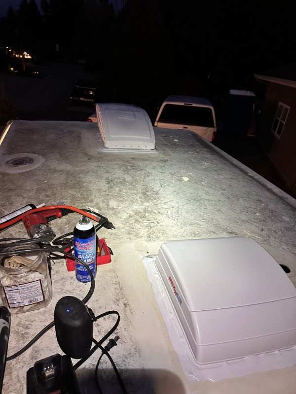

Today was a bit hectic as wanted/needed to get the roof holes filled with the two MAXX vents, and I ran out of butyl tape.  Had to drive to the "big city" of Spokane, WA to find some in stock.  I did manage to get them both in. Finished up by headlamp:
That white stuff is Dicor Lap Sealant, which is designed to flow slowly and flatten itself out.  I was worried about applying it at 35 degrees but it seemed to flow about as fast as the many videos I watched about using the product.  I hyper prepped the surface by cleaning it down to the gel coat, then a light sanding for some "tooth" and a wipe with brake cleaner.  Pretty uneventful install, though I broke two drill bits, and snapped two screws on the more basic vent.  The screw quality was much nicer on the mack daddy powered vent I installed on the rear - appeared to be stainless fasteners where the basic vent screws were merely coated. And weak!

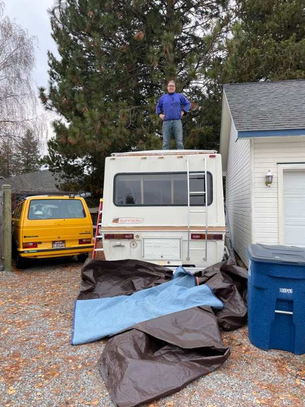

Here's some good news:
I walked all around the roof and my 180lbs didn't flex it anywhere!  The added framing around the two vents made a big difference as those roof beams are 14" apart (vs 10" for others), and I'm happy I have achieved my goal of a walkable Sunrader roof.  Sure needs a cleaning up there.
Now I can relax a bit, with 6-8" of snow hitting for the first time of the season starting Saturday.  The roof is waterproof and can handle even a severe snowload.  These are MAXX Air's 4 season versions and they also don't need a winter cover and will operate in the open position even in the rain. Having the vent holes stoutly framed will also avoid the failure of a vent that is pushed out of square by heavy snow, and breaks its seals.  You'll see I added fore and aft beams to the holes, which are both screwed into the cross beams and epoxied to both the beams and fully potted in epoxy against the roof. I stood on the vent frames and they feel solid.   Here's a shot of the interior.  The red is a heat lamp I have on both vents to help the Dicor continue to cure. I'm sure it will take a week to fully cure, though when it has a good "skin" I'm going to put heat directly on it to help it finish.  I want the skin as I'll use fabric to insulated it and don't want prints in the material.

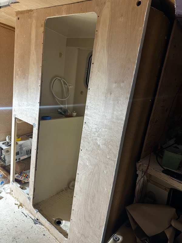

I'm not sure what step is next.  I think the floor, but I need to take a wall panel off to see how much room for insulation I have.  I think it's only 3/4" - anyone know?
Just got back from a specialty plywood store and I'm pretty excited I found some nice 1/8" plywood to use for the roof and walls.  I also got 3 sheets of marine grade plywood for the floor.  I've decided not to tear the entire floor out, but instead will be screwing and glueing down strong 3/8" marine grade plywood.  I don't have any serious rot save a couple square feet where the fresh water tank sat.  The rest of it's just slightly wavy here and there and a trouble spot near the left wheel well where the plywood oddly curled up a good 3/4", but back under the cabinetry.  So, I'll cut/grind that down, then hose down the floor with Loctite's MAXX adhesive and to to town with some wood screws to simply add a layer to what's already there. A little shocking at $700, but this will cover all walls, the ceiling and the floor so it was a LOT of surface area.
Somewhere in the forum there is a floor repair post. Glued the new plywood down and then drilled 3/8 holes through the new wood and 2/3 of the way through the old floor, made the holes in a grid. Jack the old floor level then coat 3/8 dowels with epoxy and drove them into the holes. Let everything set up, flush cut the dowels and then sanded the floor.
Very rigid
Idea is new screws will pull out of the old floor, hammering the epoxy coated dowels in forces the epoxy everywhere into cavities in the old floor, much stronger.
EDIT found it...https://toyotamotorhome.org/forums/index.php?/topic/10066-87-sunrader-floor-project/#comment-93485
Edited by WME
Thanks for finding that.  Looks like he had a different objective in mind where he just wanted a strong (vs spongy) floor and was OK with a non level/wobbly floor.  Plus his bonus of not removing the cabinets.  I've done some research on foam and adhesives and suspect he dissolved huge chunks of the styrofoam under there by injecting the resin into it.  There are not many glues/adhesives that don't dissolve styrofoam. I want to preserve mine.
My goal is both a strong floor and a flat floor, so I think I'll stick with a fairly traditional plan of laying marine plywood down on the existing floor with a thick layer of high end Loctite construction adhesive, then some screws to pull them together into a VERY stiff laminate.

PS Also, I continue to be completely satisfied with the roof strength.  Today, I realized I need to cover/insulate the outside of the roof again.  Soon I will be pushing pieces of glued foam directly against the fiberglas, and the new insulation itself will prevent the heat of the interior from reaching the fiberglas/foam junction to cure the glue. So if it's 30 degrees on the other side of the fiberglas, the glue will be 30 degrees and take time to cure. Just before our first big snowstorm, I realized today I'd better get up there and lay down some moving blankets and foam, then cover it again with a tarp so this insulation stays dry and effective.  Now the heat in the interior from my portable heater and heat lamps will be able to warm the fiberglas roof somewhat.  As evidence, the interior was at 53 degrees and with no changes, it's now 70.5 degrees.
When I did this, I hopped up there with impunity and did not have the tentative "is this going to hold me or make a big crack sound?" approach.  Just hopped up there and whacked around with a broom and brushed off the snow, briskly stepped around pulling up the tarp and hopping over the folded edge, etc.  Totally solid! Super stoked.

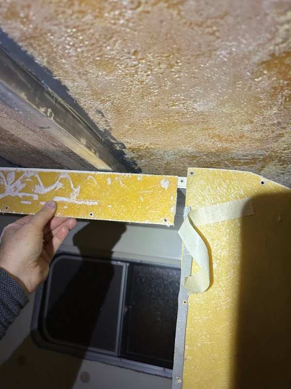

Today I got the first few insulation boards up on the ceiling.  The fit is what I'd hoped in terms of the beams and insulation being the same level.  Should make for a good process glueing up the interior wood paneling. Unfortunately my plan to use 3M HD 90 spray on contact adhesive did not work out.  Even though it says OK for some foams it's not OK for this.  Reverted to using the Loctite which unfortunately makes it a days long process of gluing, propping up and curing, then moving on.  Versus a couple hours of slapping foam chunks up there - argh.

I will also have a couple hidden low LED strips under counter edges to have a red night light setting for those 3 a.m. bathroom trips.  Getting old is not for the faint of heart!

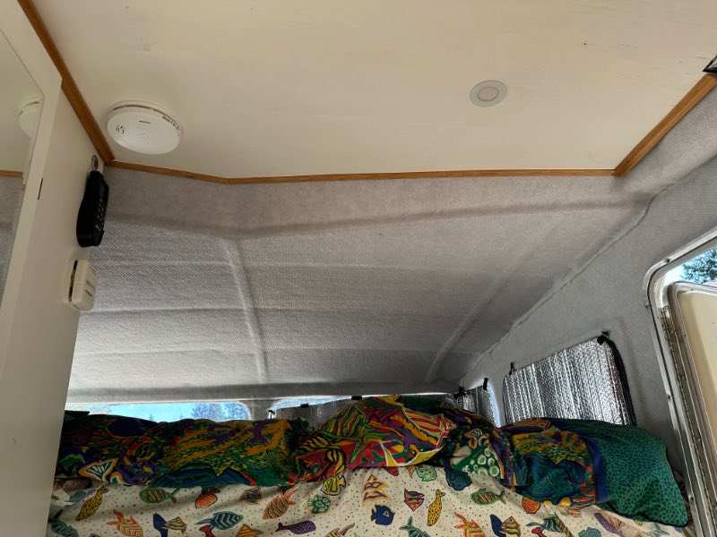

So, I did some experimentation today with the 3M 08074 Trim Adhesive the engineering line recommended, and the 1/2" R-Tech styrofoam with the reflective foil on one side and the polypropylene on the other face.  I wanted to confirm the glue would not attack the poly (the foil actually has a clear polyprobylene layer over the foil) at all, and that it would be a solid choice for the following tasks:
1/2" R-Tech to cabover sleeper roof
R-Tech to 1/2" open cell foam
1/2" foam to Sail-Rite white hull liner fabric.
Total success!  The 3M did not attack the R-tech poly.  It gripped it so tightly, pulling the hull cloth off tore the foil layer off the foam core.  Same with the foam - tore the foil later.  And the foam to fabric was and excellent bond also - tearing off foam when separated.  So, I'm happy and the cabover ceiling will get 1/2" insulation, then 1/2" foam, then the white hull liner fabric.
