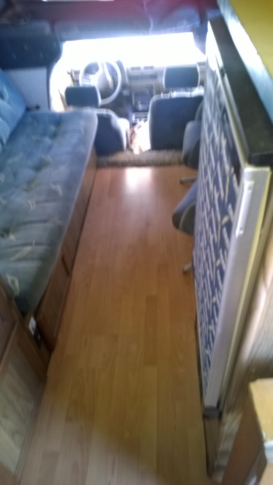

sdboltdude Posted April 29, 2014 Posted April 29, 2014 Installed hardwood floors yesterday will finish up today so much better then ugly carpet.. had to cut off seatbelt bolts too rusted other then that not too much trouble so far so good.... Quote
