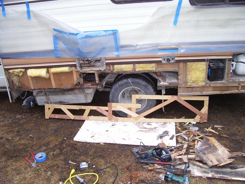

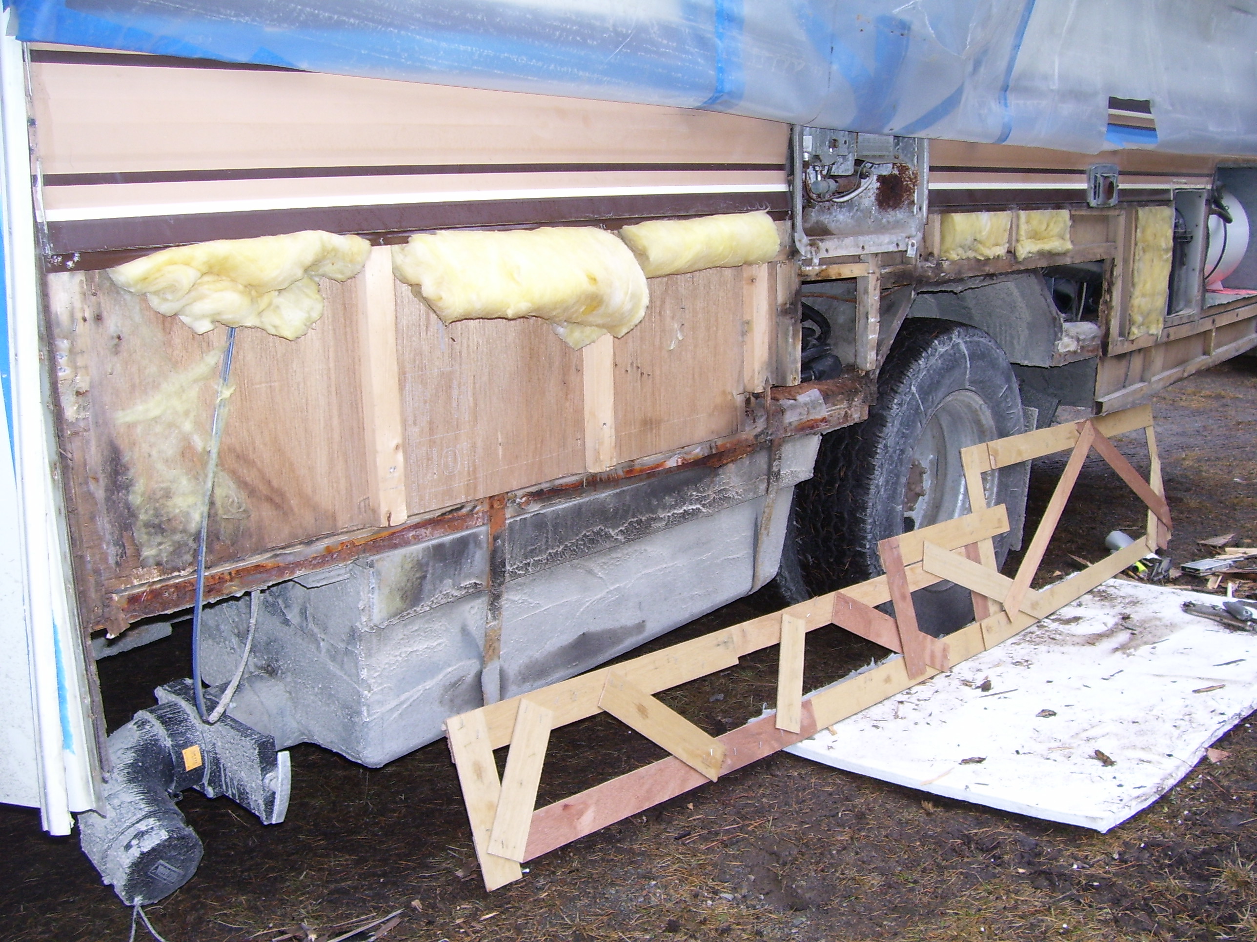

I did the same job you're doing on my '85 Dolphin a few years back. I didn't have to remove the tanks to fix the rotted wood in the wheel wells. I removed the outside aluminum skin from the side to expose the rot and then was able to repair the wood from the outside. If you go this route (and I think its the best way) you'll be able to see how the tanks are attached and maybe just replace the old strapping one at a time to make sure you don't lose a tank somewhere down the line. The photos show the tanks and strapping but not very close up. The wood wasn't rotten all the way up so I was able to join new wood to the old with epoxy and a 45 degree bevel cut on both pieces. The lattice looking thing is 1/8" door skin that I used to make a template for the new wood. I made the new wood out of solid 3/4" plywood and painted it with epoxy and then grey paint to try and keep water out of the wood. So far so good-no water has gotten at the new wood. When you remove the aluminum siding, handle it very carefully because the longer pieces are flimsy and will bend and kink when you take it off. John
