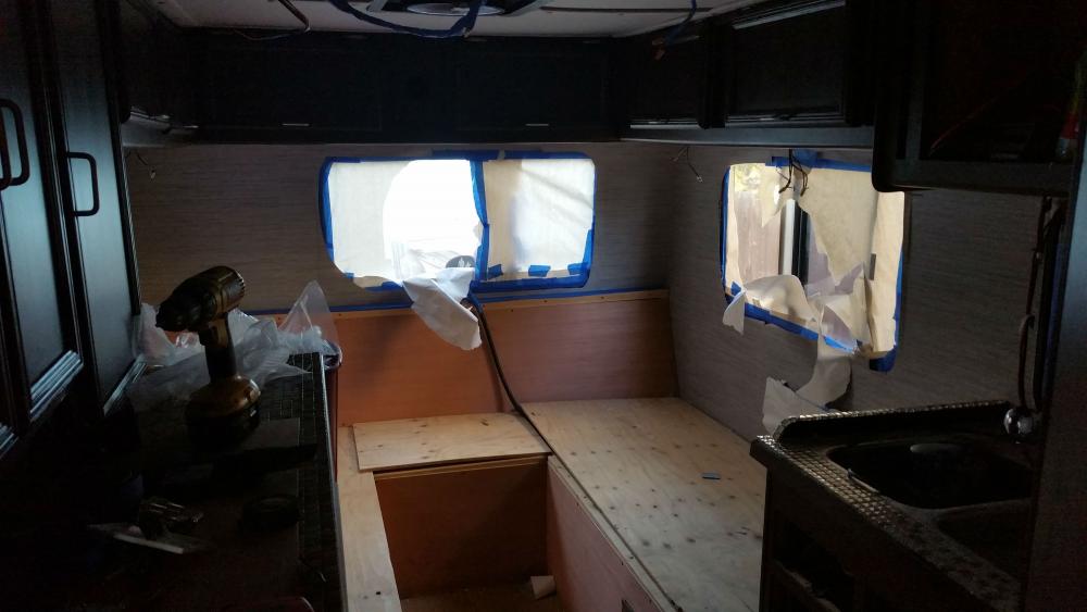

Please pardon the mess.  Big boulder items done.  Yay me.
Wallpaper in.

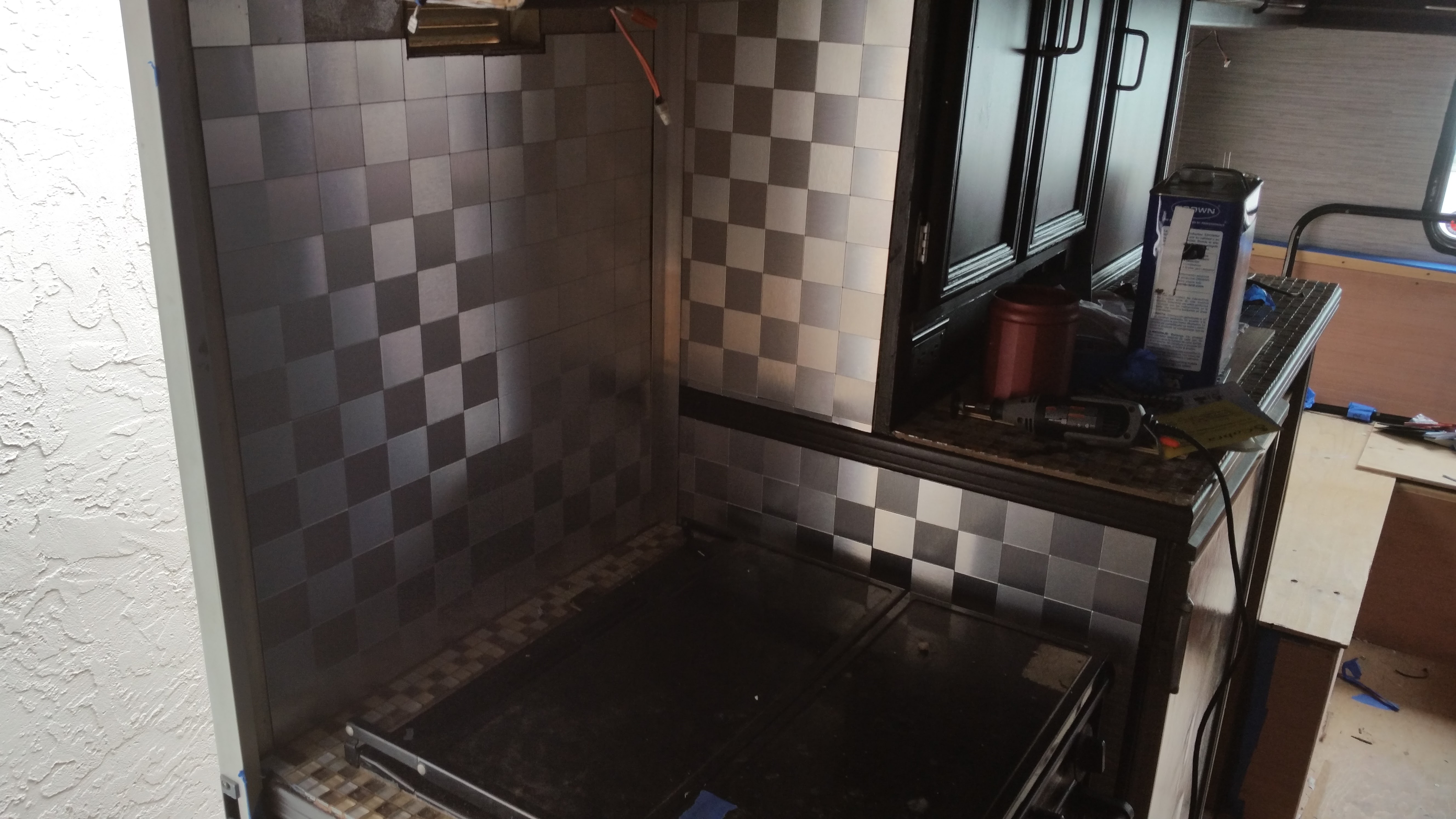

Sink area done, with inverter switch and solar remote controller in the wall.
Stove area done.  Vent hood was also rebuilt with new wiring/switches/LED light and installed.  No photo.
