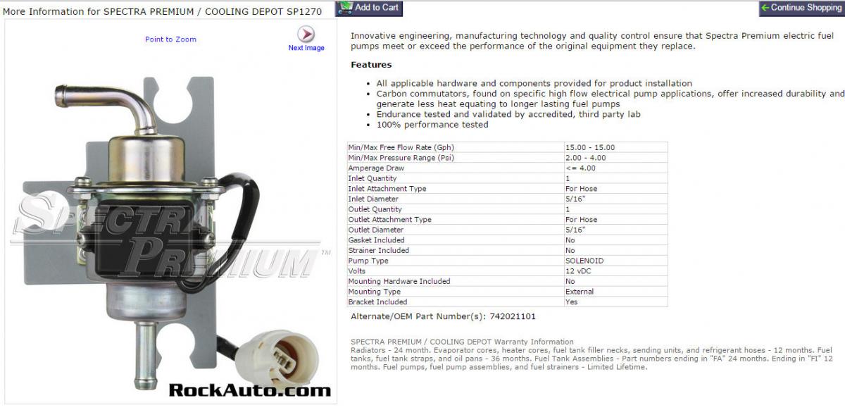

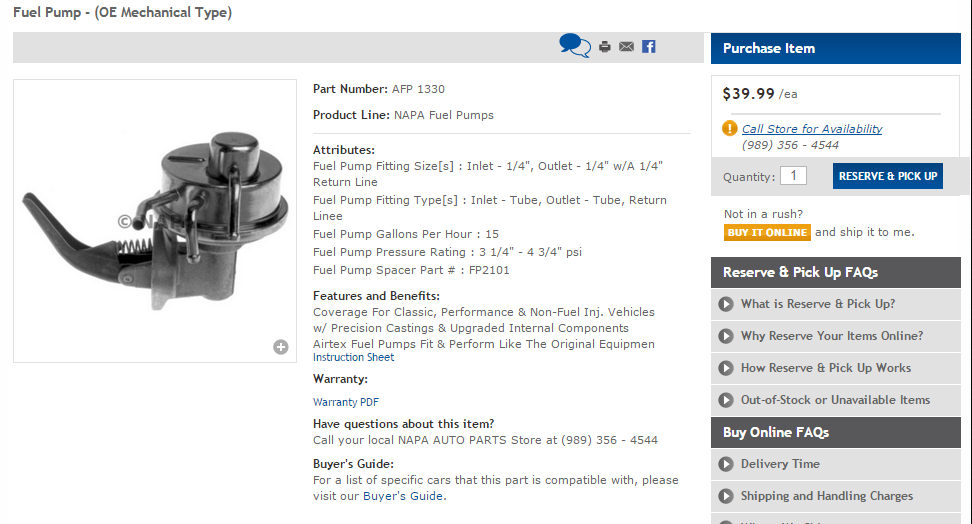

zero Posted August 18, 2015 Posted August 18, 2015 Here are some pumps that are low pressure (4.5 PSI max) and are suited for your Toyota. None or suited to be under the hood except the mechanical pump or the two Walbro reciprocating pumps that are very pricey. You cannot go by what some auto parts stores listings show as adequate. Many are incorrect. Especially from NAPA. Quote
