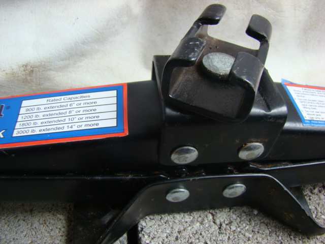

  7. After reading the posts.......when I put one scissor jack under the front frame and start turning the crank I can lift the opposite front wheel completely off the ground as well as the wheel next to the jack. I have to really pay attention when I snug up the jack under the frame when leveling it. Looking below the front doors and behind the wheels is where I place the jacks. Looks like one of the previous owners put a jack under the body and bent it some before realizing it was bending the body. I make sure it is under the main frame.
  8. Both leveling and stabilizing too. Very effective. Think I have been using them for 5+ years, no problems. I use a piece of scrap wood, size approx. 4"X8" X 1/2" under each of them to keep them from sinking in to the ground. I carry them inside and put them on at campsite and remove them before leaving. I was just showing what I did not trying to upset anyone. Hope you figure out a solution that works for you HAPPY NEW YEAR to all the Toy owners πŸ› οΈ
  9. OK. I didn't spend all that $$$$ and needed it quick. Two self-threading bolts and two pieces of flat bar steel.
  10. I made these and put them on end of frame toward the bumper so the stabilizers would just slide upon them to crank up or remove in just a few minutes I just use these on the back and use 2 more placed under the frame close to the front doors for leveling I think they were about 18.00 each from Harbor Freight
