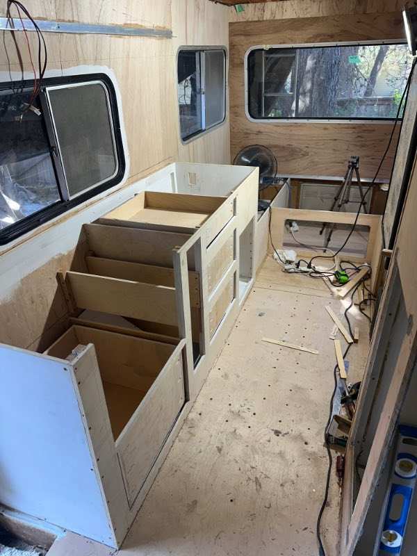

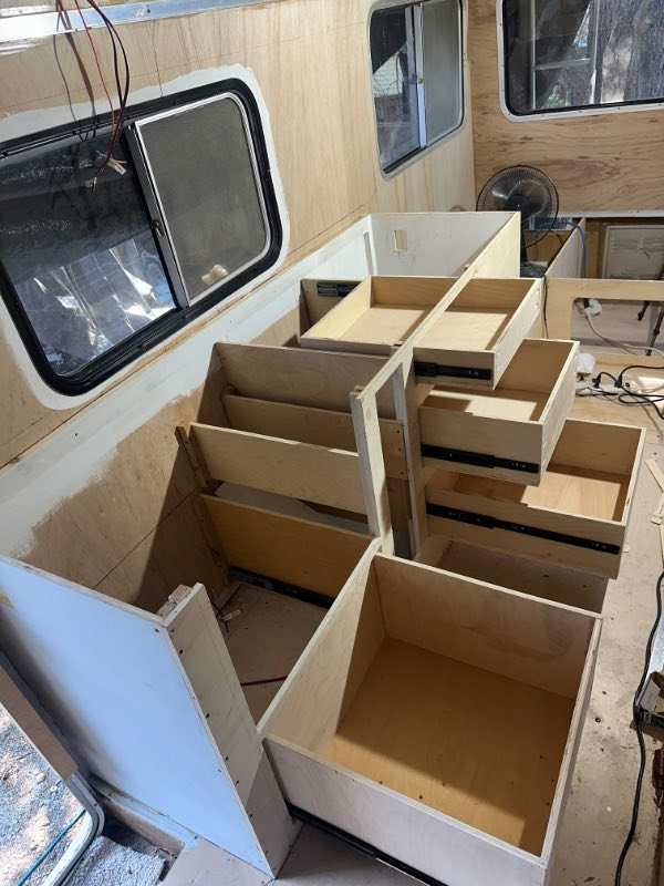

Drawer boxes mounted on soft close slides for the kitchen side. The factory drawers only went a little over half way to the outer walls, and these go all the way. Big increase in usable storage. The drawers all go full extension like the bottom drawer in the photo - just for illustration:
And all closed showing how they encompass the full internal space:
Three smaller drawers done, now working on the intricate slide out "pantry" thing. You have to kind make an exoskeleton verson of a tall skinny drawer so you can take things out of it from both sides. This pocket screw jig from KREG is pretty cool, though not foolproof. Since everything I do is getting both screws and glue, when I put the screws in, the glue acts like a lubricant and the parts move unless they are clamped very hard.

Today I finished the first drawer box - the huge one under the stove for big pots and pans and baking sheets. Sunday I hope to do all 4 of the other ones including the complicated slide out "pantry". Then I have to try some fancy work for the drawer faces that hide the drawer boxes. The drawer slides arrived and are they heavy! Recommended by a guy on YouTube who does cabinetry.
That is a full size clipboard and 8.5X11 paper for scale. Its sliders can handle 110lbs of weight. I reimagined the storage from the factory, which was already large. I eliminated a lot of upper storage cabinetry and found at least 15% more total storage by resizing the cabinetry. That opened up the feel of this Sunrader quite a bit, and the storage spaces themselves are larger. That may seem counter intuitive, but if you own a Sunrader, imagine how much more open it would feel if a lot of the head height storage were eliminated, and that cubic feet of storage were slid down the walls into slightly larger cabinetry and under the rear dinette as well as also optimized. That's what I did, except for the cabinets over the kitchen which were kept, but shortened and made about 30% less intrusive, yet more useful. The direction is to make this vehicle capable of extended self supporting trips like a year long foray to South America or similar, and I think it's there. There is also a hidden safe, and of course the heated BMW M leather seats will make long journeys more comfortable. Here's the largest drawer, which is still curing and needs to be sanded and painted:
