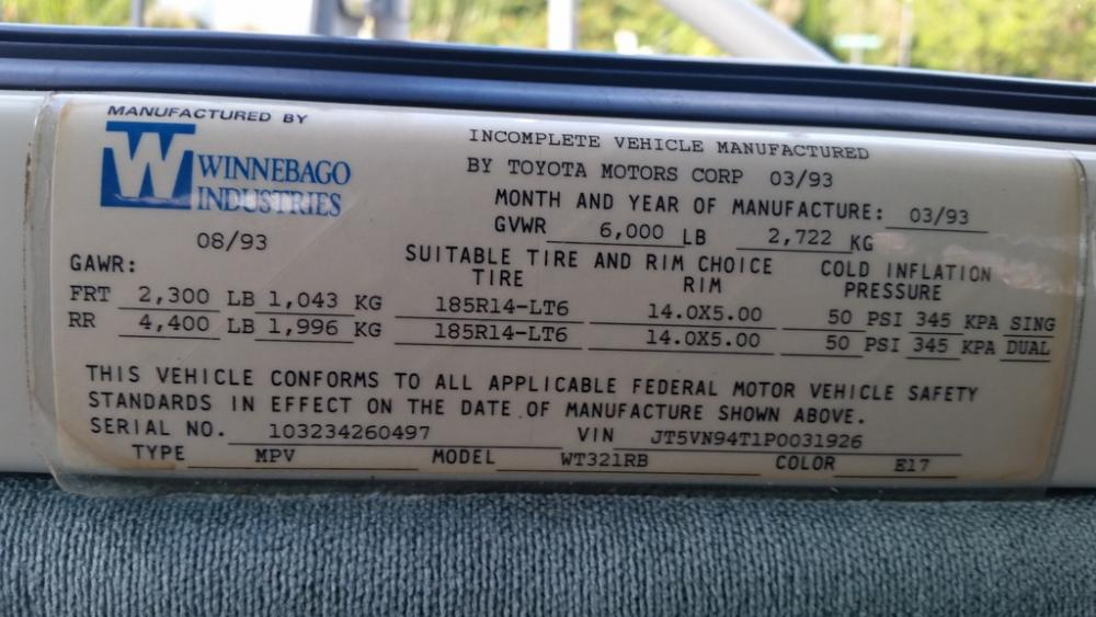

Hey guys. Can someone explain the above mention of tire psi being 40 front and 45 rear? I have all mine set at 36 as that's the recommended according to the chart on my door. 83 sunrader 6lug rear 5 lug front. These are what I have. 6ish months old https://m.tirerack.com/tires/TireDetailsServlet?tireMake=Yokohama&tireModel=Y356&partnum=8R43568
Link to comment
Share on other sites
The numbers on the door was for the pickup before the home was added  to the back.  I run 45# on the front and 50# in the back . I have the yokohama 365 on mine too.  Was Highly Recommended by the late Sunrader  Bob. He was the Toyota motorhome guru !
Link to comment
I don't know about all Toyota motorhomes, but Winnebago at least added their own stickers with tire pressures indicated. I don't know if other manufacturers just left the Toyota stickers.
'Correct' inflation pressures have been discussed before (often) as well as Load Inflation tables.
Where is your sticker located? I wonder if I have one. overall concensus is my tires are way under inflated lol.

Ok I will bump mine up. I wonder why different pressures in the front and rear? Interesting.
Link to comment
Tires are designed to the most efficient profile for stopping, traction, braking, resisting hydroplaning, control etc.  This profile is altered by the addition or subtraction of weight, which can be compensated for by changing air pressure in the tire.   Best I can describe it,  HTH   Jim
Link to comment
Good enough for me!
