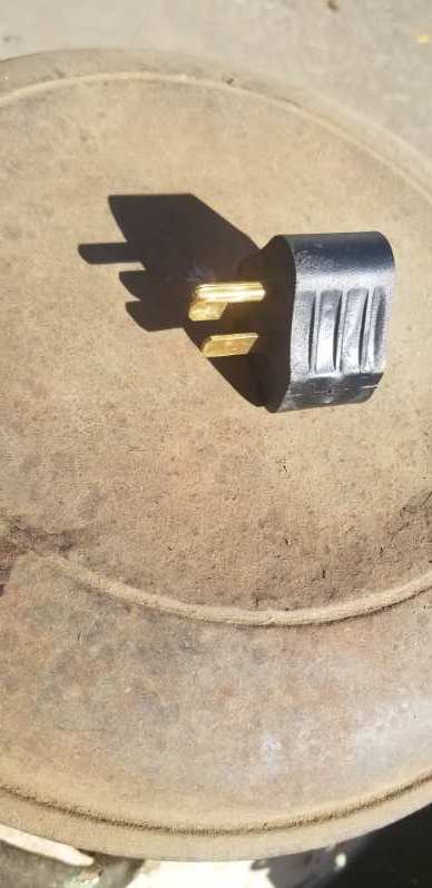

Plain Jane Posted September 27, 2021 Author Posted September 27, 2021 Sooo, here I am on the Dolphin's first camping trip to test all systems. Plugged the brand-new plug into the campsite power in the receptacle that took it and ... nothing. It's still a lovely night and don't need the AC, so have given up for the night, but ... WTF? Quote
john*thomas Posted September 28, 2021 Posted September 28, 2021 Did you test the A/C before hand? It could be a bunch of things. Fuses, plug. power source, A/C itself, etc. Can you plug something into a receptacle and see if it works? Quote
Plain Jane Posted September 28, 2021 Author Posted September 28, 2021 Power worked fine off the truck battery - all the lights came on when I started the engine. Have combed the manual and can't find out where the fuses are located. Quote
V6 Seabreeze 92 Posted September 28, 2021 Posted September 28, 2021 When you plug in at the power hookup Box at campgrounds Often the power switches are at OFF position. Just flip them to ON. Could be a simple fix. Quote
