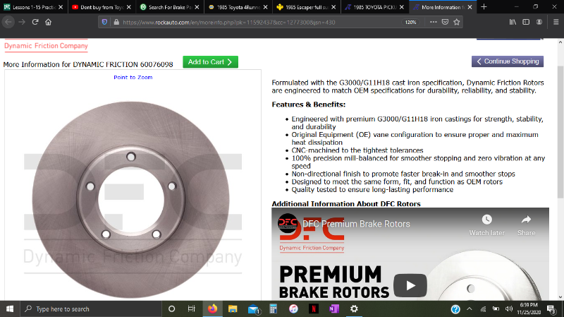

hamkid Posted November 26, 2020 Author Posted November 26, 2020 The gallon of brake parts cleaner is sorta pricey, do I have to buy the safety solvent? What exactly does safety solvent do? Also, these rotors are on rock auto for $18.30. Should I even bother with turning the rotors? Quote
linda s Posted November 26, 2020 Posted November 26, 2020 I can't imagine why you would need a gallon. Also you have to be really careful with brake cleaner. Can't touch anything rubber , ball joints and all the bushings, and wear gloves and face protection if your laying on the ground trying to clean something. Extremely toxic. I bought one can when I did my Ford brakes and there is still a bunch left in the can Yes those rotors look good and probably cheaper than the cost of having your old ones turned Linda S Quote

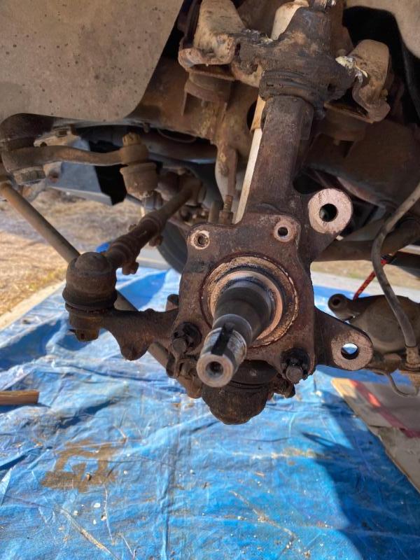

hamkid Posted November 29, 2020 Author Posted November 29, 2020 Thanks! I removed the upper ball joint and the upper arm bushing bolts. Before I go any further I need to ask about Camber adjusting shims. Not sure where they are or what they do. The manual says to record the thickness and position of them. Please help. Quote
Ctgriffi Posted November 29, 2020 Posted November 29, 2020 So you’re planning on removing the upper CAs? The shims are small (~1” square) thin and roughly u-shaped with a tab; they will usually be straddling the two bolts that hold the upper CA in place, on the back side of the frame bracket. When you start removing the two bolts, the shims should be able to be pulled free. Record how many were in place on each bolt; these things keep the front wheels in proper alignment by slightly adjust the position of the upper CA. (Alignment recommended after this is all completed anyway, however.) For what it’s worth, I didn’t try to replace the bushings in the upper arms: most folks agreed it was a PITA, better to just replace the whole unit. Quote
Ctgriffi Posted November 30, 2020 Posted November 30, 2020 I think... 1) the bushings in that CA look like they’ve been replaced recently, so maybe just leave it alone... 2) The two bolts pointing right at the camera/phone in the second-to-last photo are the ones that release the arm, the ones with the shims on the backside. Quote
