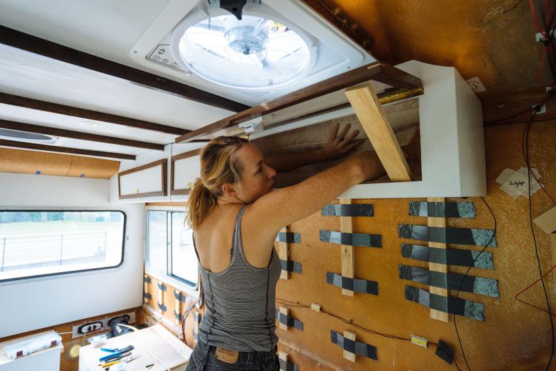

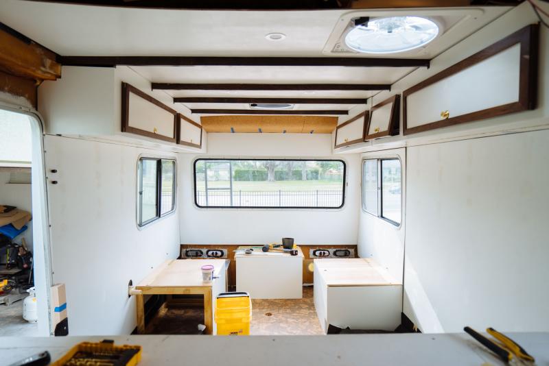

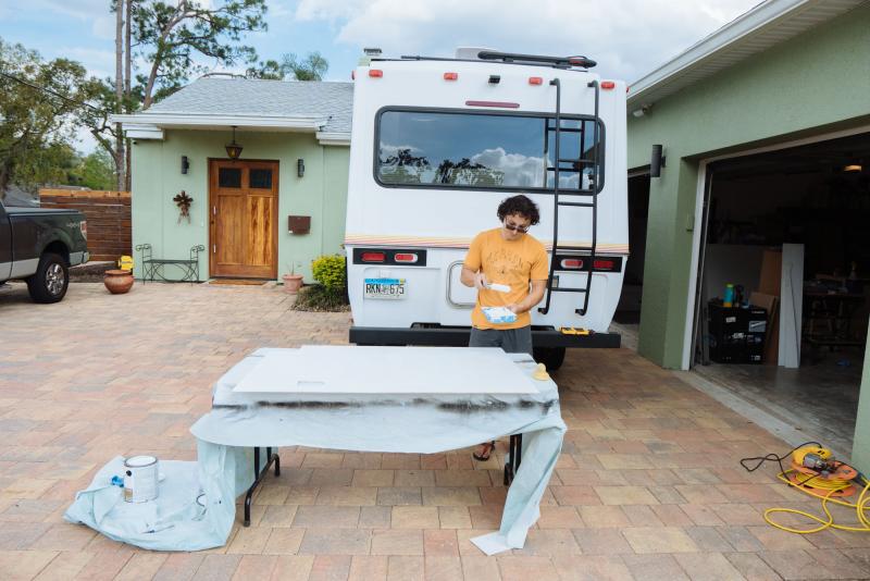

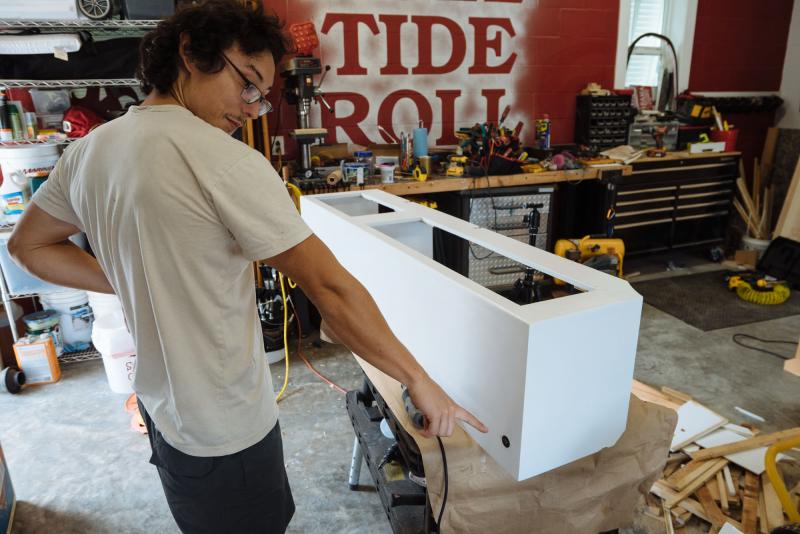

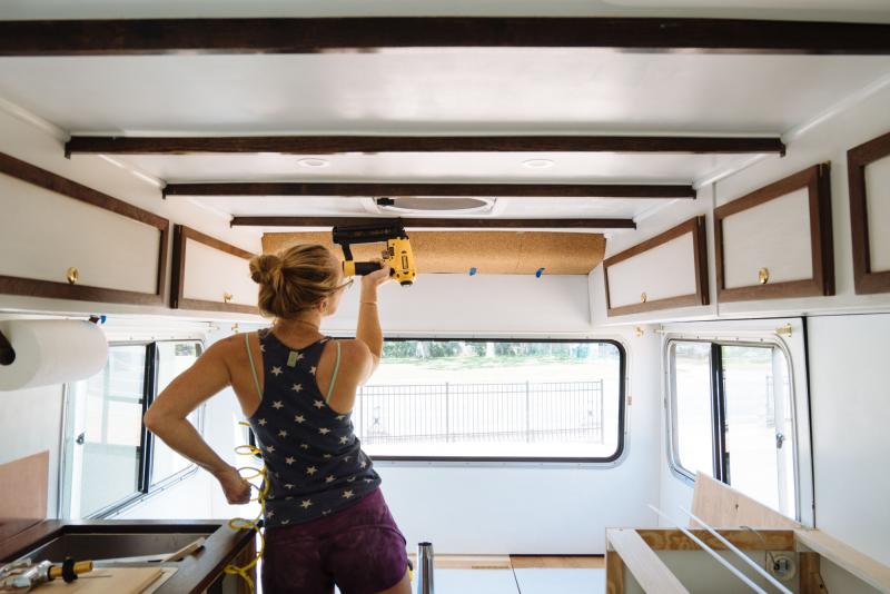

Okay so back to it. I'll pick up with work on the upper cabinets. We decided to model these after the original design but opted to have them open upwards and have hydraulic arms hold them in place so we wouldn't be forced to hold them up with one hand. We also changed the design a bit because on the driver side we extended them all the way to the bed. We were able to do this because we eliminated the bathroom. That's right. No bathroom. We're young-ish and have been living on the road without a bathroom for a while now so we decided the storage was more important to us. Inside the cabinets we wired in LED light strips to illuminate the interior of the cabinets.
MAK01356.jpg.60239b8ae32b8d6a6d04682a0310cc37.jpgMAK01374.jpg.bda41d6d2d4496b0181d84012dc9e4ba.jpgMAK01373.jpg.27966db092a7f8c042eec36e7ac8a5ab.jpgMAK01290.jpg.c8ce1ef6547f1fb80c2cca3fc52682fb.jpgMAK01478.jpg.a50a3d9b1b7a615ae263b23e0aac28cf.jpgMAK01468.jpg.54435621a2c1d5ec7d955c1d49849cfa.jpgMAK01467.jpg.a1ec56942f5177072fd21b6f799ae01f.jpgMAK01479.jpg.267a091d8eba4899dc3daca161431466.jpgMAK01488.jpg.f4073b32ce4489754e12a70b028d2488.jpgMAK01494.jpg.51037dcd3dd35a5888e540f994710874.jpg

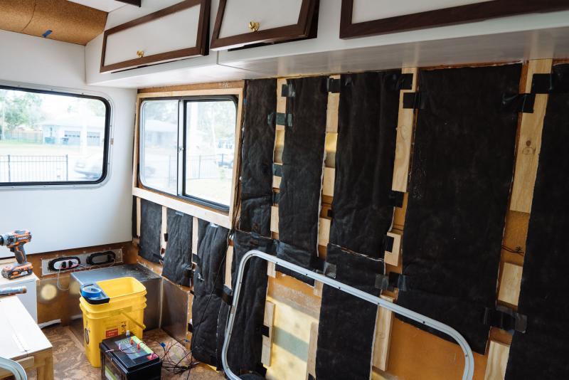

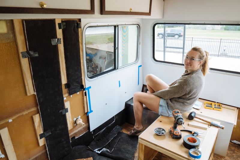

Next up was the back wall. We started by adding in some "studs" and then insulating with thinsulate. Then we cut out a piece of plywood, painted it (several coats), and finally installed.
MAK01370.jpg.4df331900c7075fbbaff5e9c2afc485c.jpgMAK01388.jpg.2295dcc8899174ab7ff7a85b89b6c80a.jpgMAK01404.jpg.c18c728e9d08993cd345439864f3f4d3.jpgMAK01450.jpg.d1cb1004bc8a3651936bd3e53bd531dc.jpgMAK01455.jpg.4c5973fc6e109fcb07a2966388977c16.jpgMAK01464.jpg.c35e19fe9f99bdafe78588b618306ff3.jpg

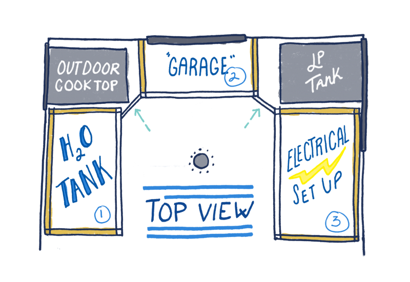

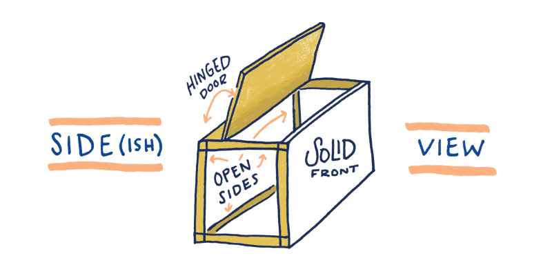

As we breezed right through making everything look easy (completely the opposite) we moved on to the back seats. We drew up a plan and then started construction.
TopView.png.4aab40aff5046fe0ea7723cc7f64931e.pngSideish-View.png.3d7ca5ba0f94dd6d6551cda1f586e527.pngMAK01474.jpg.317fa7d5b6749f97922d8dc24a5860ff.jpgMAK01503.jpg.955e4051847af5c0124ba951efeb3e52.jpgMAK01510.jpg.6a0a26e0290dfd336f2fd893b4546030.jpgMAK01512.jpg.71e184f28857f2b8ba97de358f13bd97.jpgMAK01526.jpg.9181a43607470885fc6748d2713559f1.jpgMAK01533.jpg.1f190c4d05f3230da965561ec3b88741.jpg

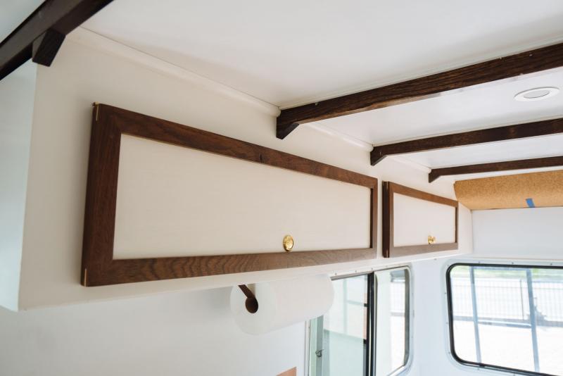

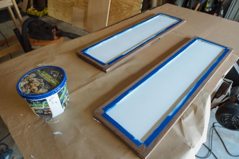

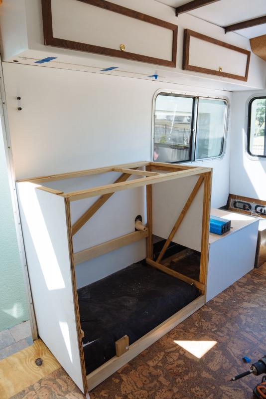

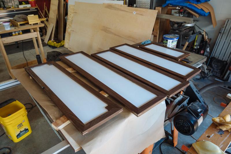

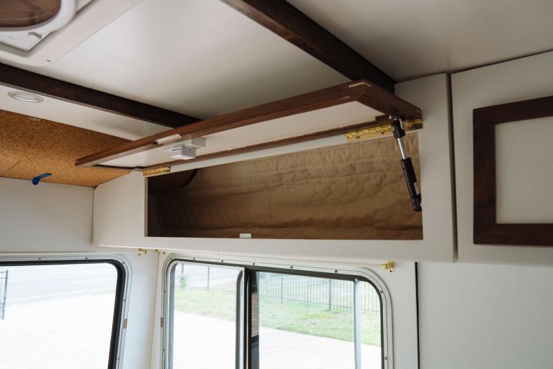

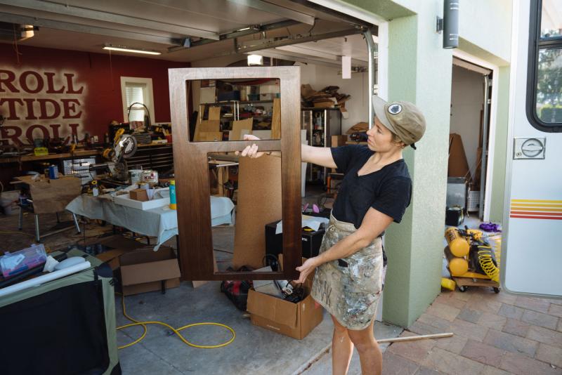

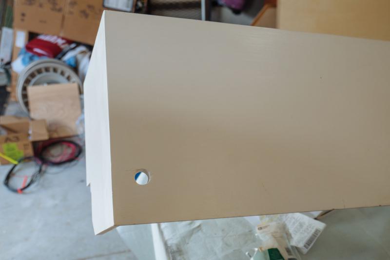

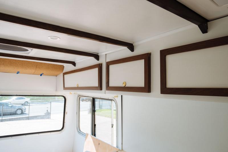

Back to the top cabinets! We moved into installing the doors and button latches. The doors are attached to the cabinet frame with piano hinges. The button latches ensure that they don't open up while we're driving.
MAK01625.jpg.ace01be90de44fc36807a629ad01800d.jpgDSC09847.jpg.e3f779e222f82108408529810696ddc6.jpgDSC09819.jpg.3b842b4eee1c3c1e54df6ce02965fca3.jpg
Once everything was put together it was time to install them!
DSC09889.jpg.1e128ed193a184e9ea4564374ca1c55b.jpgDSC09895.jpg.770e7144a70ed96f9c065177c80f0af2.jpgDSC09930.jpg.fa07afbfe3e62853e6fa991e8bf03f27.jpgDSC09932.jpg.7b61c785f923655e2b0f97d42f9859f9.jpgDSC09938.jpg.fadff1429f941fa5adb415dad4c407bc.jpgScrews.jpg.1064633c50186866c98510376531ebdc.jpg
Don't worry we insulate that wall in the back of the cabinets (still to come). Back to the back seats. For these we also used piano hinges and hydraulic arms to hold them up. This made it way easier to access the storage underneath them. We added finger holes so that they could be easily lifted and painted them white. We also took this time to drill pilot holes for some of electrical pieces that would be mounted on the inside of them.
DSC09912.jpg.25de875763ae3f46822bcce73e842fd7.jpgDSC09924.jpg.17755b54a89ecb0849de1a8bda5fd96e.jpgDSC09941.jpg.1052d0e5a168bd684c98b763333107f9.jpgMAK01542.jpg.5fb4949f7775922f1341c1df8de5211e.jpgMAK01658.jpg.b40c8381f20812f7da87e8b4eb91f2d7.jpgMAK01687.jpg.7f980e9381b46d4f32e837c80ced7f4b.jpgMAK01705.jpg.9e1eb65d916acc7b4daf5eabcc8db1ec.jpg

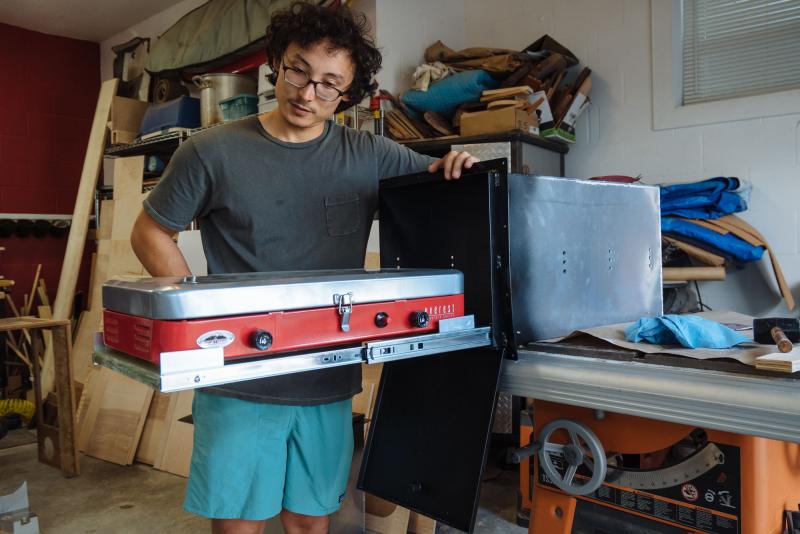

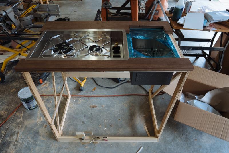

Then we switched our attention to our outdoor kitchen setup. The plan was for one of the exterior boxes to have a camp stove on some heavy duty sliders and somehow it all worked out as we planned (woohoo!).
MAK01534.jpg.c9bc897fe2769c3c5b06c9f615b51cd9.jpgMAK01554.jpg.5b92b2b159f1c0bf9eece57b13750f0f.jpgMAK01565.jpg.bb4a10eda13d0b8e9f6d6816e35553c9.jpgMAK01569.jpg.e9d1fdde34df9b06cb0fdc0a8ba1689c.jpgMAK01573.jpg.e026235e308798853aadbe386354ce5d.jpgDSC09873.jpg.9522e82ac84fd10e359c76f66eedf665.jpgMAK01577.jpg.8130a8d3b18b58b8bc83ff247f3a04e0.jpgMAK01637.jpg.901e5b107ddc9e4dfc2992d42f0ffd46.jpg

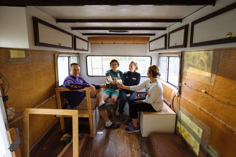

Then we took some time to celebrate these small steps that would eventually lead us to our goal.

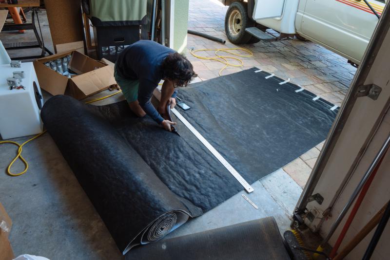

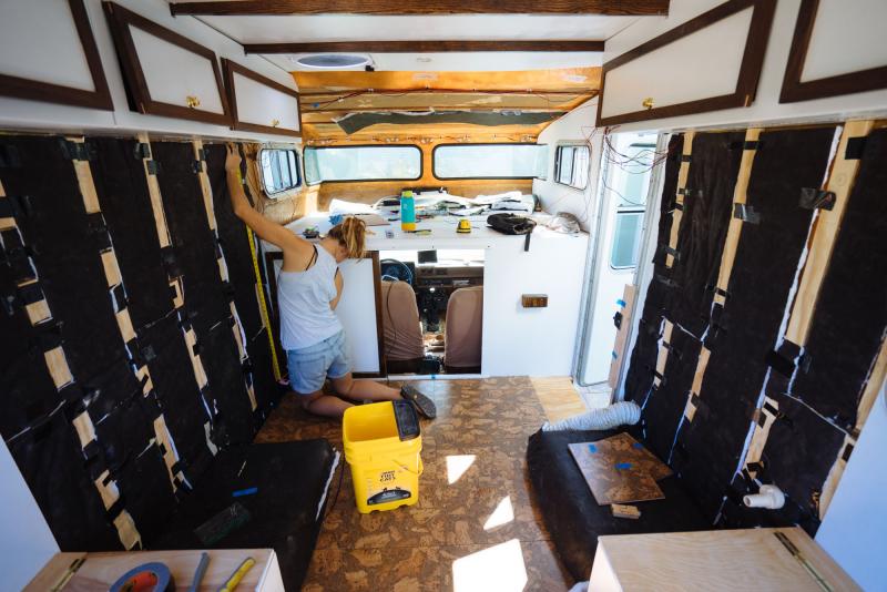

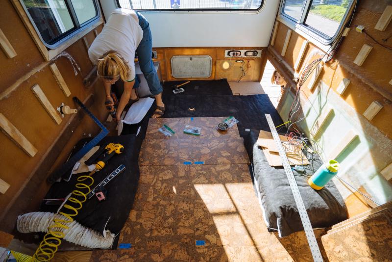

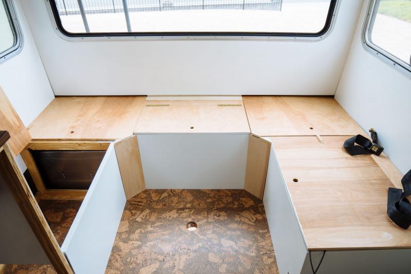

First up in this installment is insulating the floors and adding in our new cork floors.
MAK01722.jpg.b131d0a0db69244025ef1edac2aa0830.jpgDSC00045.jpg.4c4af65ab6405a1445b903ebf931f2a6.jpgDSC00053.jpg.bd705db162831881f82dfc31cc49eae1.jpgDSC00062.jpg.abd39af82424ecf11acb135ee77e3924.jpgDSC00067.jpg.40b7eb90a8edff0c1df57d432861ad2a.jpgDSC00079.jpg.ce0b5fd8c659c0f096575b466dc0d05e.jpg
After the floors were in, we went to work on the rest of the walls in the back half of the camper. This was done in the same way as the back wall, so we added studs, insulation, cut the wall piece out, painted, and then installed.
DSC09986.jpg.2fa1ac35b1776dce153e33c112a4df9e.jpgMAK01769.jpg.597e59a2dd28d02f8681165a2a3ab49e.jpgDSC00115.jpg.279db26238d63565075125278ef99498.jpgMAK01713.jpg.1d090df871a5eb23c602a54ea76df660.jpgMAK01848.jpg.671de62dfa8a538b2c92f54ddc49675c.jpgMAK01775.jpg.75d2067ab7983fd78d1e778ae1973bfd.jpgMAK01861.jpg.00b82303dc367b9690dce7ac6536a15b.jpgDSC00119.jpg.e42702ec092633601ca9bf12057b84f3.jpg

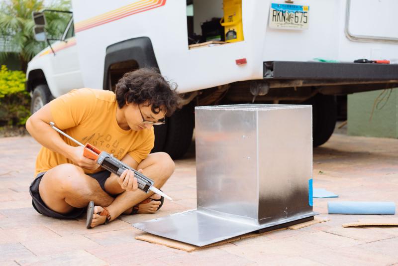

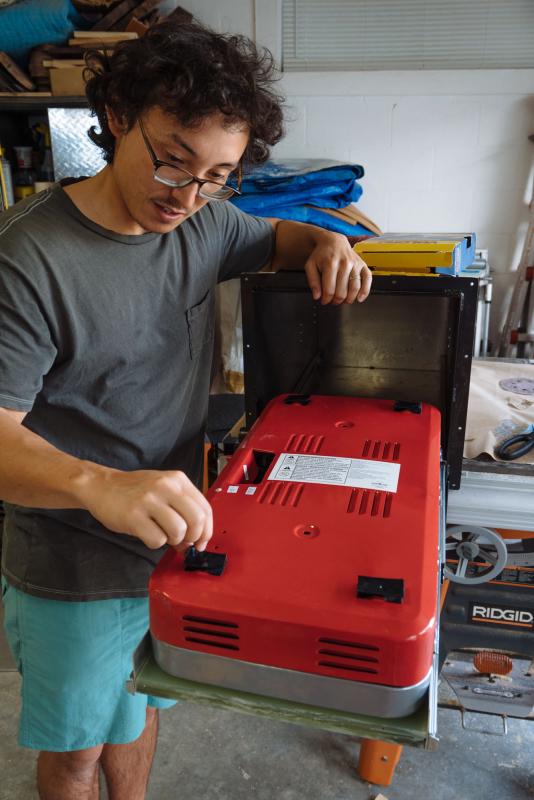

Next up: Working on the propane system. This began with installing a new regulator since we dropped down to one propane tank. When we installed the new regulator the old propane tank wouldn't fit (doh!). We decided it was about time to upgrade the tank anyway. Initially we went to West Marine and bought a tank that would fit but soon realized that it wasn't meant to lay on it's side so we returned that one and ended up ordering one online that was specifically for laying horizontally ($$$). Unfortunately, we don't have pictures of the new tank until the whole thing is done so you'll have to wait on those for now. Once all that was figured out we were able to install the box that would house the propane.
MAK01797.jpg.62db0338d4955ac5f52a1ed783a16f79.jpgDSC00084.jpg.fd389cfc98dd15b403585f8fd49066ea.jpgDSC00100.jpg.9ee062c503f0dfa0c2854d152985ccc0.jpgDSC00107.jpg.b95afed5bd877bf61e8c28ff244b187f.jpg

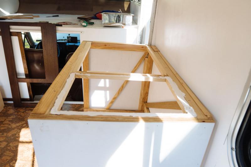

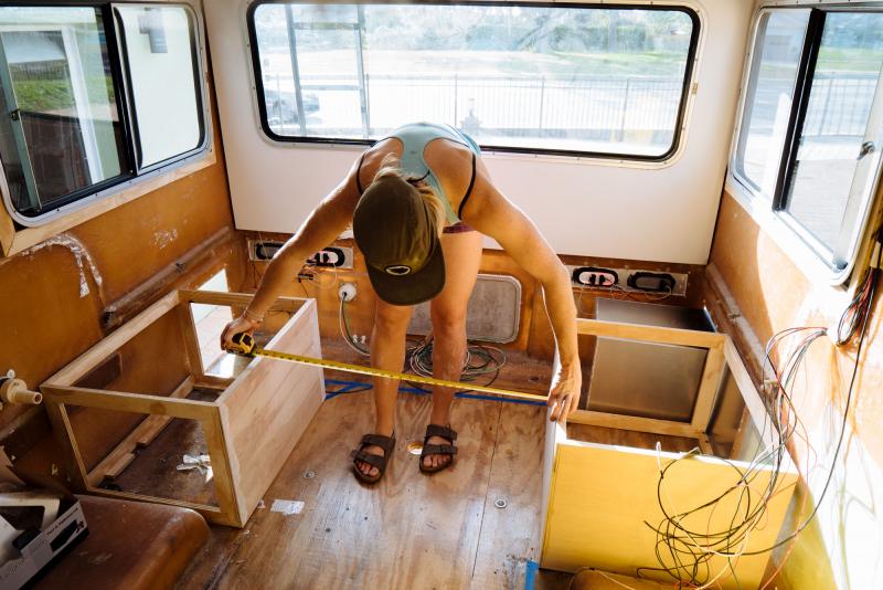

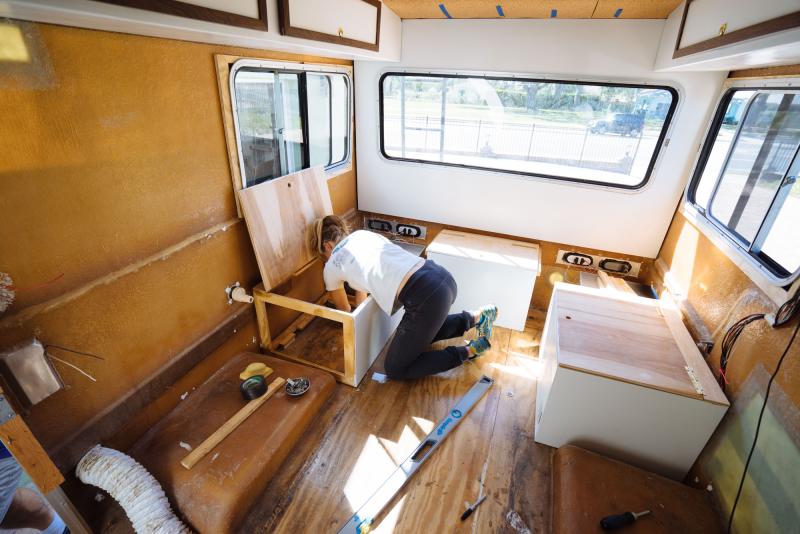

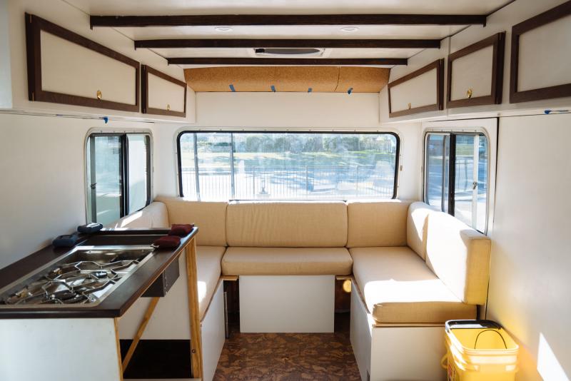

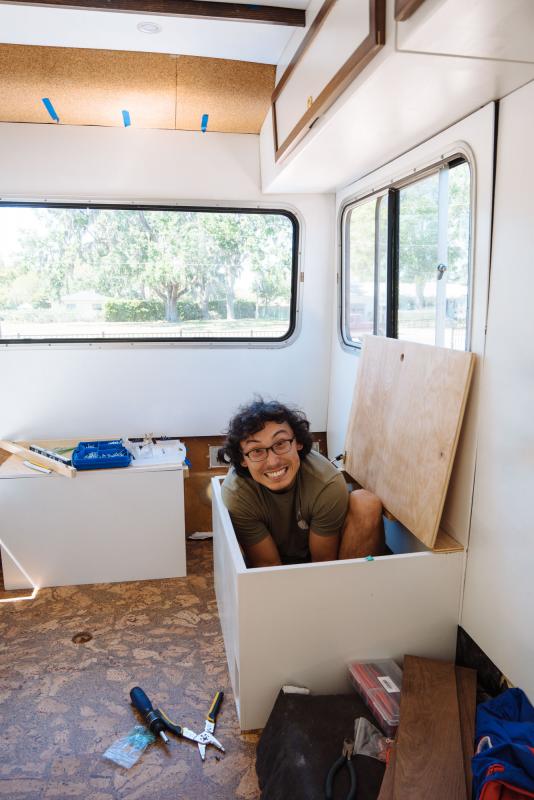

Moving back inside, work commenced on the passenger side lower cabinets. This would be home to our stove top, sink, trash, and more storage.
Kitchen-Diagram.jpg.97cc391797860674d1683585a236fcfc.jpgMAK01813.jpg.afc1ca0948cb9e282d87d7b296aa90ea.jpgMAK01790.jpg.9188307ed810a41b8106c3f4b9669e3b.jpgMAK01829.jpg.a521a50806c02eaba6d5c307af9890f3.jpgMAK01838.jpg.909b12ebf78afc1c8ad4efbe995d331c.jpgMAK01854.jpg.57a3c1470cead10821b1142a7daedafb.jpg

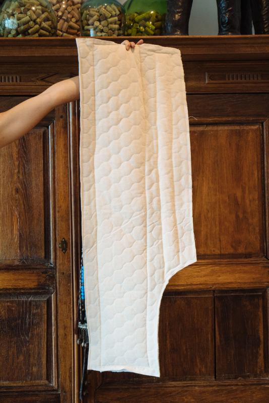

Lastly for this post, MAK sewed up some insulated covers for the insides of the upper cabinets. She used a thick quilted fabric as well as more thinsulate. It was then adhered to the wall with velcro so that we could remove them to access wiring if we ever needed to.
MAK01405.jpg.c239309976bc4c806e11dc31e530120d.jpgMAK01426.jpg.7060a26485d842af308c02a80cf3a26f.jpgMAK01597.jpg.06d973a8cc8aa487efe2bb54b7ab8d9b.jpgMAK01599.jpg.ebb1ebcb518fa341d164e08bafac7712.jpgDSC00010.jpg.689b735f4abf75760b6c26778d39a562.jpg

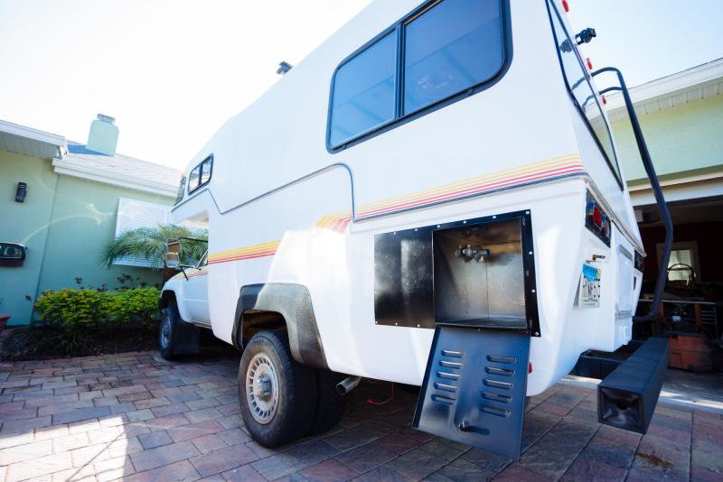

Starting this one off with some work not done by us. Since we created a permanent bed structure we had some exposed plywood hanging out right over our heads. That wasn't going to cut it so we took the car to a professional upholsterer to take care of that and the wall at the front windows. Added bonus was that inside the cab the new fabric would allow us to stick our patch collection to it. We also installed the front wall panels on either side of the bed.
MAK01879.jpg.db958117cd3b4096d59ef5366b27946a.jpgMAK01960.jpg.76ab489fc90f9b9414ed4447ee7fa83b.jpgMAK01872.jpg.a0cc9f1399fed468250f46fe25263810.jpgMAK01977.jpg.98171a7935f3b23553a4c1096d3d05a2.jpg

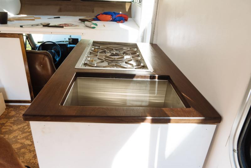

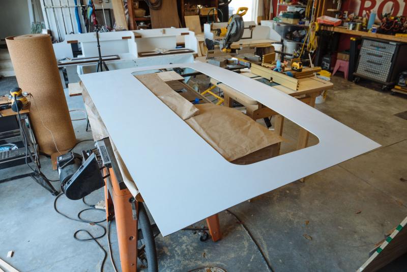

Back to the kitchen. MAK finished the countertop with some poly and it looked fantastic. We installed the frame into the camper and started the final assembly.
MAK01886.jpg.e9a6aa11d3a45b97f03d4574a4d50585.jpgMAK01939.jpg.95663cf128d32388b93b1a7af0744f7e.jpgMAK01910.jpg.79f6fb07ea371279a41324b7d0328197.jpgMAK01937.jpg.1cc9e2a8accd11df4b40439dc88395a0.jpgMAK01948.jpg.109f5b61a218b51fbc928ea13b07b83f.jpgMAK01949.jpg.fa18e30fc10c8ee0b7334ae702f477b1.jpgMAK01950.jpg.d5d63531ce03a957d82685f7025ba0f8.jpg

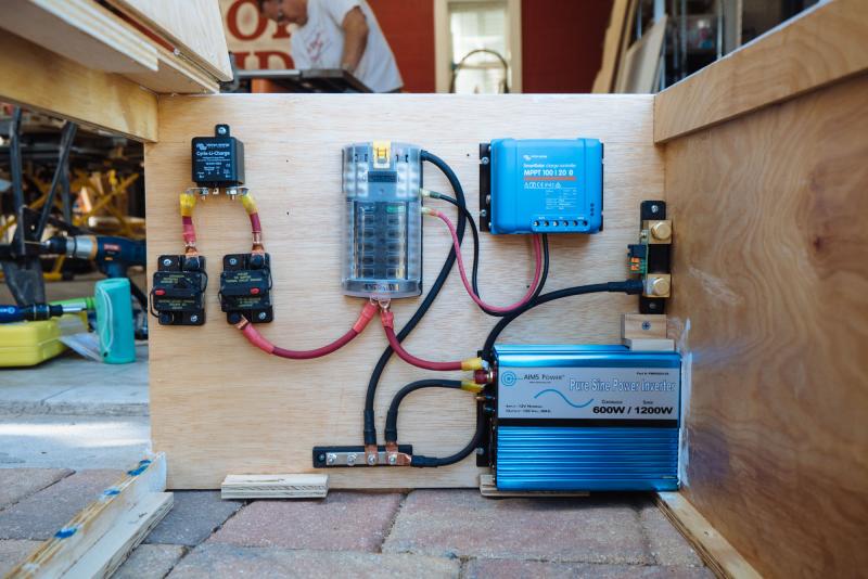

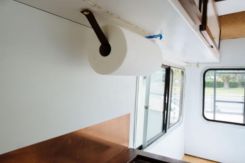

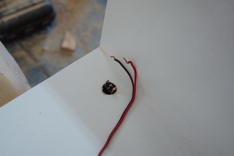

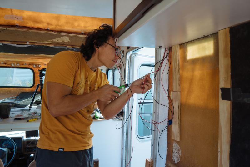

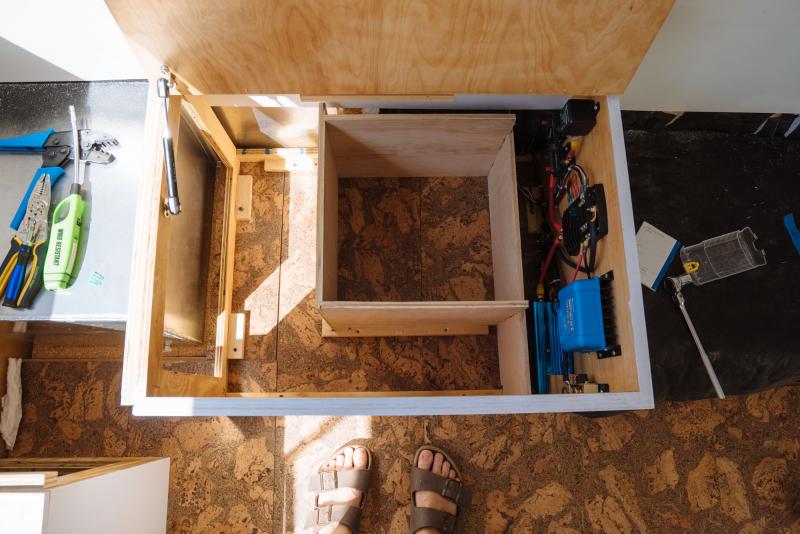

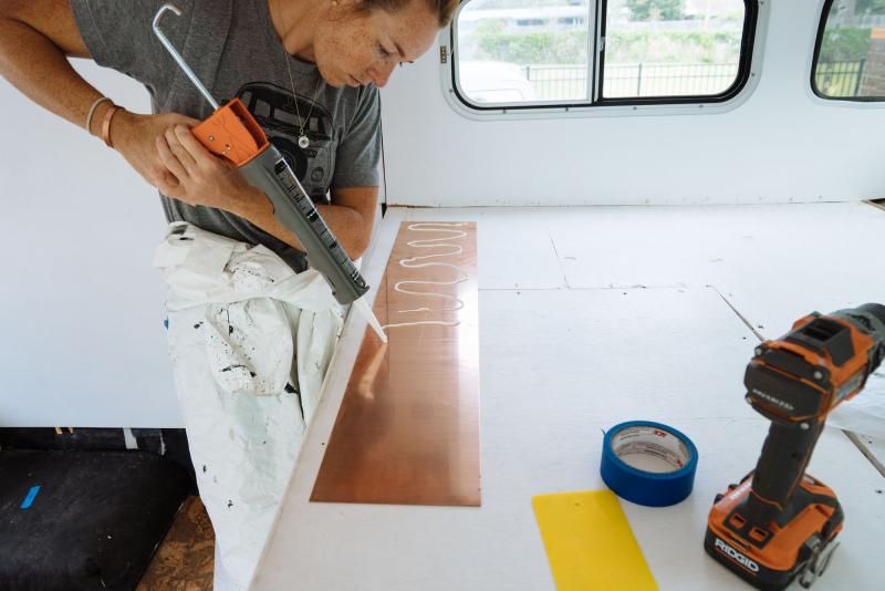

I continued to work on the electrical system by installing the components inside the back seat and doing some of the connecting. I also replaced both starter battery terminals as they were badly corroded and I suspected it was the cause of some weak starting.
MAK01896.jpg.73b3f8258c7d85e630286e5047d26b6d.jpgMAK01904.jpg.91da44f81d44b4eef4807a7af5cad4ed.jpgDSC00154.jpg.faaa8c4c6d3d7ac76922b259204ed1a7.jpgMAK01918.jpg.bc89df950407bd184717cb273c9cb658.jpgMAK01930.jpg.4c139fba3bbc98edb5eeb20c185312e1.jpgMAK01935.jpg.b063019c3149b32f2983c7abc9d91680.jpgDSC00187.jpg.18b87b0510904e8b7dc258268cb110b9.jpgMAK01985.jpg.69c4f992fd5231105136d8fda4bdb8de.jpgMAK01957.jpg.cf7fe0ce7f3b17719696cb85619db0f5.jpgMAK01959.jpg.8b03890e8c3aa544b7ac8901a441bb41.jpg

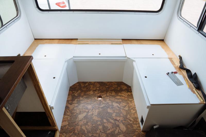

With our slightly altered design of the back seats we also needed some new cushions. We got some foam from Amazon and then cut them to the right size. Then we sent them off to an upholsterer to get a fresh new look.

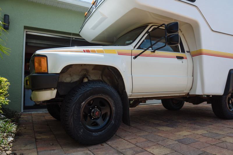

On to wheels and tires! Picked up some new 15" wheels and some beefier tires. We opted to go with 15"s to make things as easy on the engine as possible. In hindsight, maybe the 16"s would have been better because there are more options for heavier duty tires.
MAK01993.jpg.ab2d97c064962fe1ca62f4273abc0542.jpgMAK01998.jpg.606fbcc3b60e3d146bb2f8136a54a3b8.jpgMAK02110.jpg.6106cb7c93bad28384c49047a7ea3c39.jpg

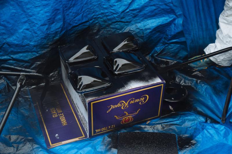

The next task was painting some of the accessories black. That included the sideview mirrors (seen above), and the table leg holder.
MAK02039.jpg.ce6ea578c3d8286ab0070e5fe6a8fcaf.jpgMAK02037.jpg.9d8c0a6efcde53e9ead765013d66239e.jpgMAK02051.jpg.5900ce304867e9a6b9191eec4d3a8fe4.jpgMAK02052.jpg.607ed580eb7f3220da2a0aa181145d08.jpgMAK02106.jpg.2e895e364cc806d1e190892dca006df3.jpg

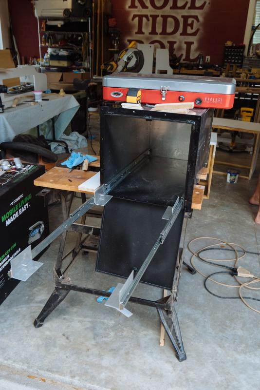

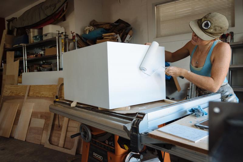

Then it was all hands on deck for getting the drawers for the lower cabinets done. At this time we also installed the faucet. The fridge got 150lb over travel sliders. That way it could come all the way out of its space so that it would be easier to open it.
MAK01970.jpg.0f1a9cad975e570f2e3f7100d49b3811.jpgMAK01975.jpg.cbc973a6320fd7170d1837beb84c29e4.jpgMAK02077.jpg.0c0ba5a5f2f6b00f80a1a3b9a90d0848.jpgMAK02080.jpg.b8342d20454c263455b9f83a335b3dae.jpgMAK02102.jpg.1ac082c3239146ffffc237117d98b437.jpgMAK02103.jpg.8061fea3b1bcb6d21ee6afd7e9f04f25.jpgMAK02105.jpg.5898a1f69fbb9e0153bcb6980fa1d21d.jpgMAK02100.jpg.549dbbee049c98cf916a353dca225efc.jpgMAK02147.jpg.a4361bb45a58b52565683abb98bdccc3.jpgMAK02149.jpg.b125395718568e038b4cfd6377ed4bbe.jpgMAK02211.jpg.fe963676169571ba6c53211c529aef67.jpgMAK02185.jpg.a88dfdc50ef092bef7cee7df19259818.jpgMAK02452.jpg.c56db3b736f9d812af3ac78bd2aed9bb.jpgMAK02462.jpg.68d8e9205c443a2426f878d47efe7a80.jpgMAK02485.jpg.ac2a2b2459704a42ea5874675bbf5d00.jpgMAK02497.jpg.4da79f0e710fe492bf5a621da203b29f.jpgMAK02498.jpg.1f9a9a659e7d7ae60a8994a393a6b236.jpgMAK02459.jpg.29454ed0032e6149ea6b49895354af38.jpg
MAK02686.jpg.31575e32603a62eb75c7faeb1963d6f4.jpgMAK02743.jpg.8e1c9d11e9d693fbb5560d88a113dfcf.jpgMAK02753.jpg.66cf2ec4d2d3c674fd40db48416372cd.jpgMAK02759.jpg.ac39c9cb0b3f8928270dd23a6de2df11.jpgMAK02773.jpg.c7d4eee85dfea3770090437730a94187.jpgMAK02834.jpg.dc34deacd3eac8c9488e4d5d4db1ae5a.jpg

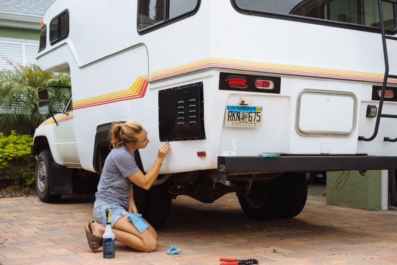

I ran the propane line to our stove from the regulator.
MAK02626.jpg.4763293f662bf690262c983fc76286c2.jpgMAK02699.jpg.1af65576497bfe0244e66c34cc38d50c.jpgMAK02707.jpg.df28a46a57f923c36db2aa164850ccfb.jpg

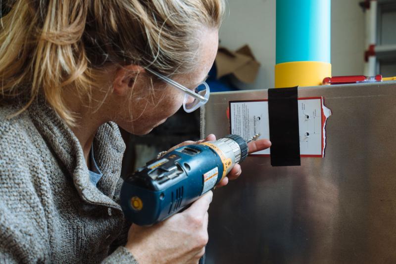

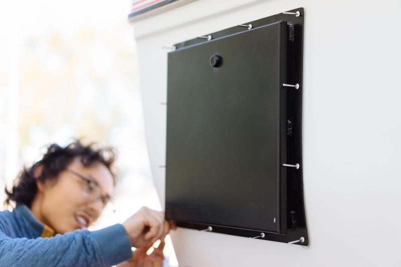

We then worked on adding new sensors to our grey water tank, sensors to our new fresh water tank, and installing a panel to keep track of them. This panel also is the home of the power switch for the water pump.
MAK02524.jpg.16ff34f963573f54849238f85a1f57ac.jpgMAK02526.jpg.ec8875906114deea7e46fba6fe70384b.jpgMAK02551.jpg.840ab3290911e9a73dff5ddd9c2c7faf.jpgMAK02564.jpg.01a2a21d9cf58d6f1dbf058026d7c2c8.jpgMAK02576.jpg.4b5d47286f4d84d7f3abf2b7c324cdee.jpgDSC00618_02.jpg.22283573921b0b642102790652187414.jpg

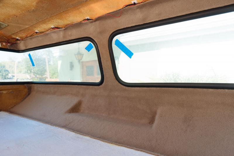

At this point we had a few areas of exposed fiberglass on the interior still. We had been dreading tackling these areas as they weren't super straight forward. Eventually we powered through with a lot of help from MAK's father.
MAK02629.jpg.a5c3d6bbdd0c65c10c5a9cfd778ef7f5.jpgMAK02632.jpg.2d00c018a51c90b806a28da848e546f6.jpgMAK02713.jpg.3a069011dfc0f4f2d016741add156224.jpgMAK02739.jpg.b7cc62565834391a48cfb86d520612f9.jpgMAK02741.jpg.62714616b06245cf071f4ba57de88320.jpg

For those interested in nerding out over the electrical system, I wrote an in depth post about it. It covers everything from solar panel to battery monitor.
http://www.boundfornowhere.com/blog2/2018/its-electric

What paint did y'all use for the body? What about the fenders and ladder?
We used Pettit EZPoxy paint and primer for the body and Raptor Liner for the fenders and ladder. Details on the process and links to products can be found on our blog.
Links to paint and primer can be found at the bottom of this post that details our painting process:
https://www.boundfornowhere.com/blog2/2017/build-out-week-8-9
Links to Raptor Liner and details on the process can be found in this post:
https://www.boundfornowhere.com/blog2/2018/build-out-week-10
