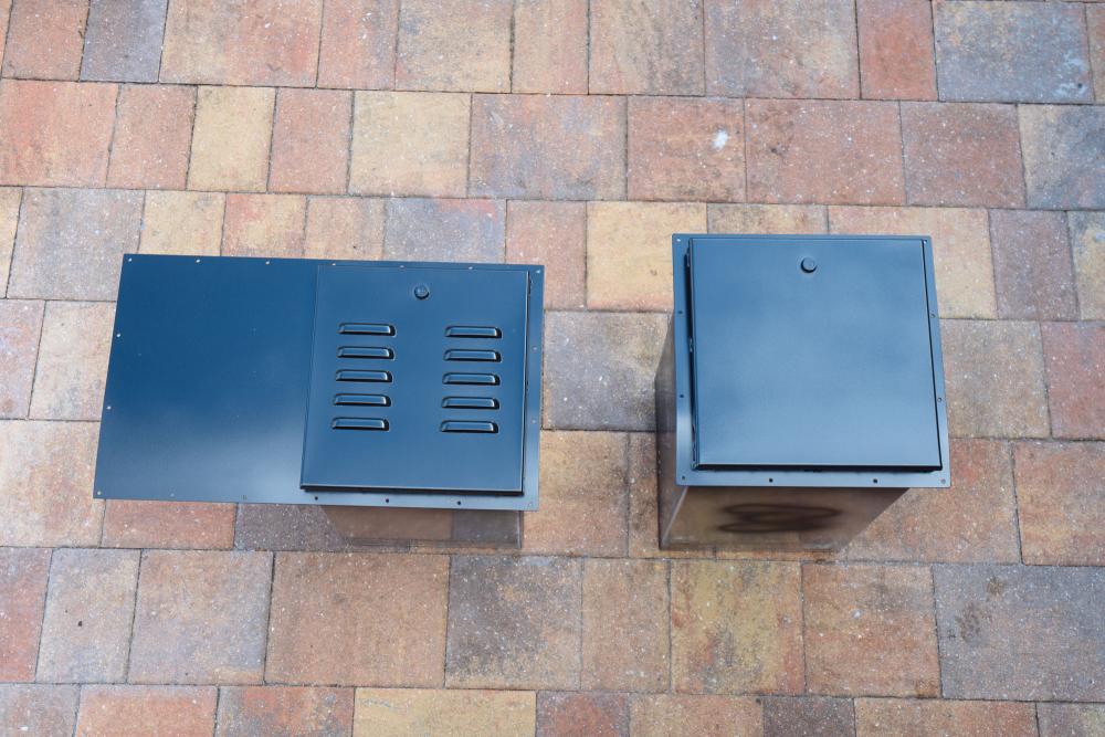

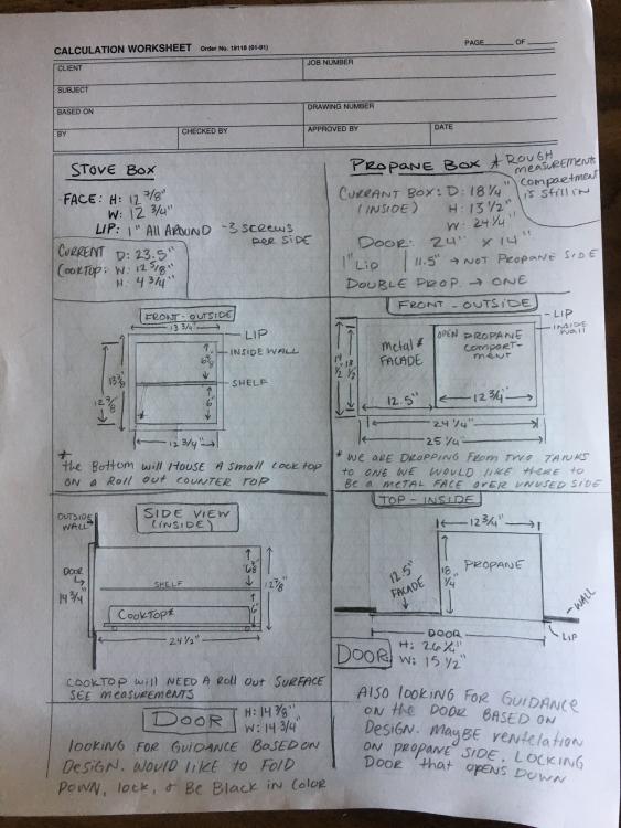

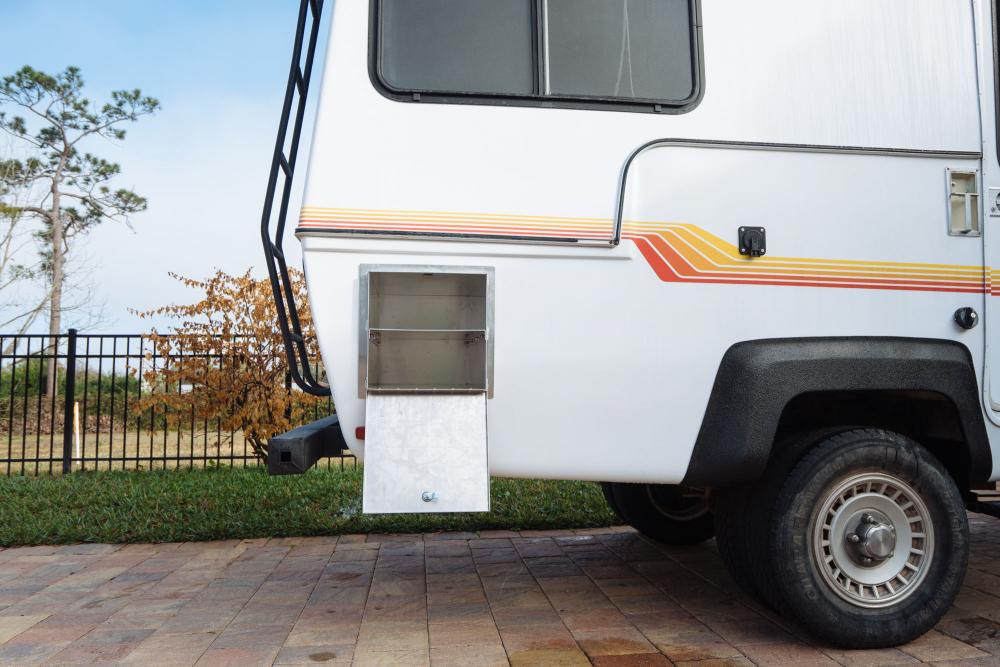

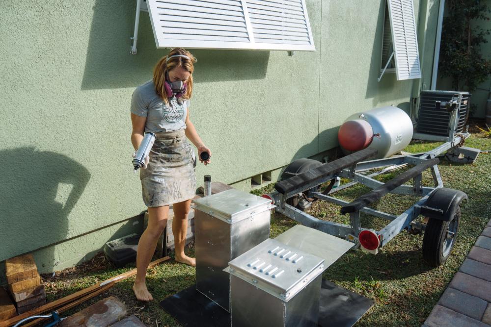

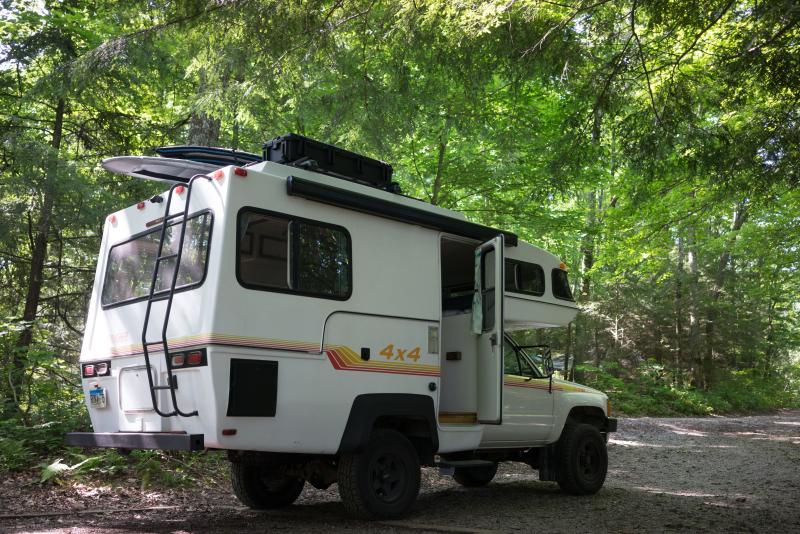

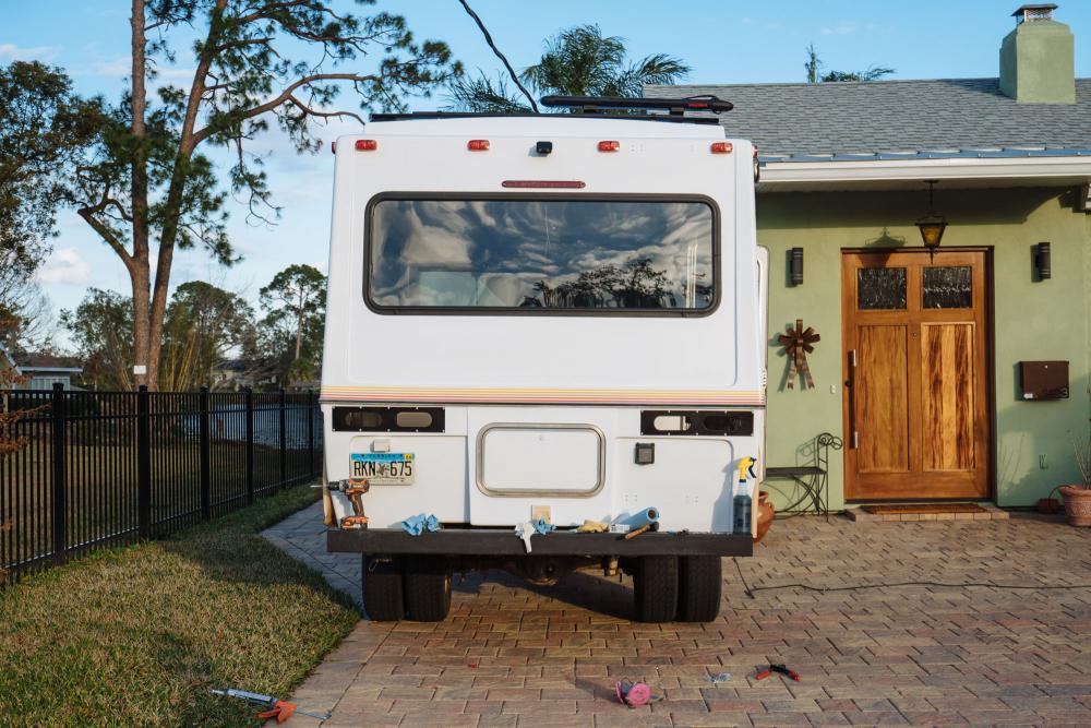

Alrighty! So Amelia's exterior is just about finished now. All that's left are the exterior hatches/boxes that are on the sides in the rear of the camper. Previously, one held the hot water heater and the other held two propane tanks. We won't be doing it the same way (as is becoming our style). After living in our Vanagon for two years we got used to living without certain comforts so we won't have a water heater (or a shower for that matter). In the vacancy left by the water heater we will be putting a pull out cook top (for outdoor cooking) and storage. On the other side we will be going from 2 propane tanks to 1. The only thing using propane will be our cooktop on the inside so it will be plenty (fridge is electric, no water heater, no furnace). By going down to one propane tank we also get back some storage on the inside. We drew up some plans for what we wanted and worked with a local metal fabricator to bring our vision to life. They did a killer job! The boxes are made of aluminum and they both have cam locks. We got them as bare aluminum so we needed to drill holes in them and paint as well. To install them we used rivets and Sikaflex to create a seal.
Sketched plans
MAK00979.thumb.jpg.5ef41a99774569335dc737265ae9b931.jpgMAK00982.thumb.jpg.347fdc8dc991b4ac5cea9a7619d977cc.jpg

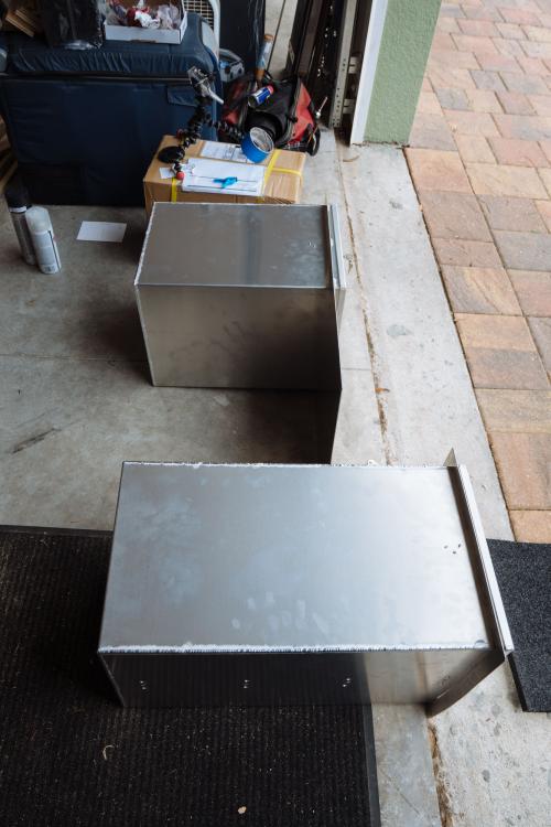

Back from the fabricator
MAK01023.thumb.jpg.7263fba389e88b7af769e10e3c8988c6.jpgMAK01028.thumb.jpg.ce3f364d534c344834a8385350667971.jpg
Test fits
MAK01036.thumb.jpg.e2a5ef0cc721f34fc549f4fdb45a27a6.jpgMAK01038.thumb.jpg.b74feaf20099509cbdc198594a4b072c.jpg

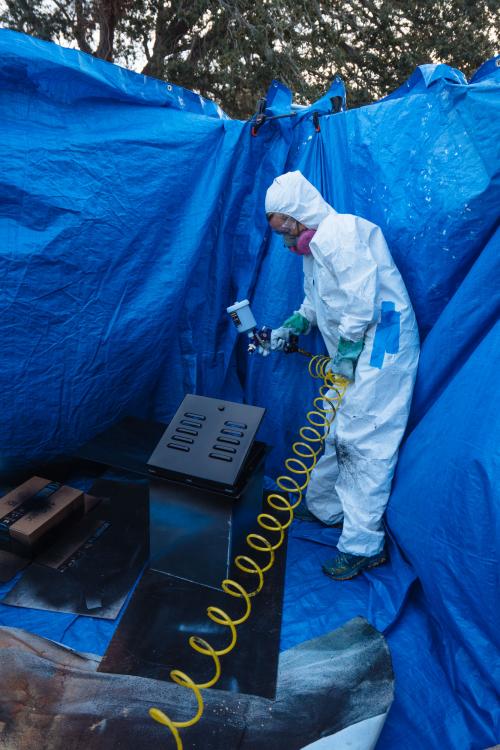

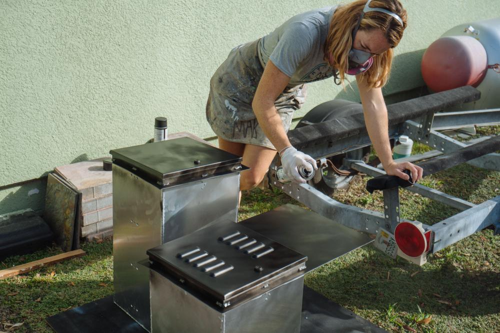

Primer
Drilling holes
MAK01070.thumb.jpg.f68ea50c5c4023845df9cd6dc26de611.jpgMAK01086.thumb.jpg.50e0a32728421afa5487136bc1ee6f39.jpg
Paint
Looking sharp!
MAK01546.thumb.jpg.139e8b2f5f9d79538c36417203dd00e1.jpgMAK01565.thumb.jpg.c993d548f819ef6cd06aeb7997ab8869.jpg

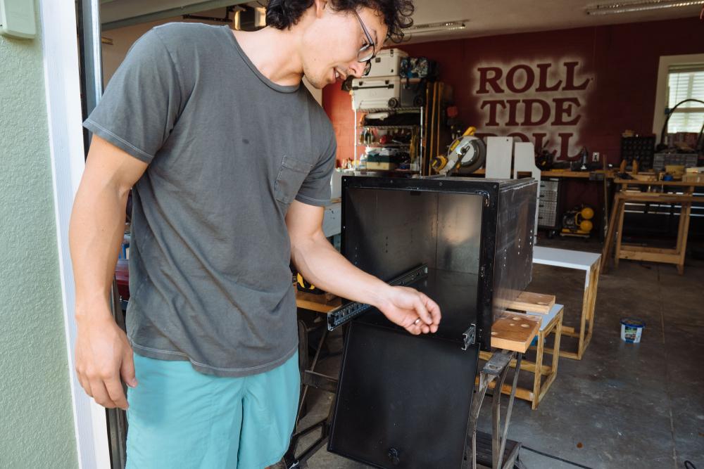

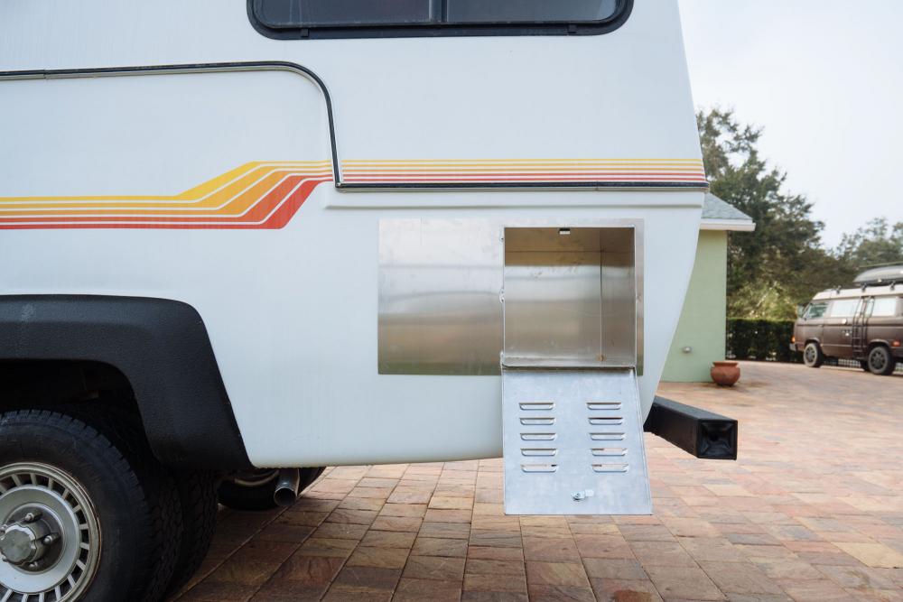

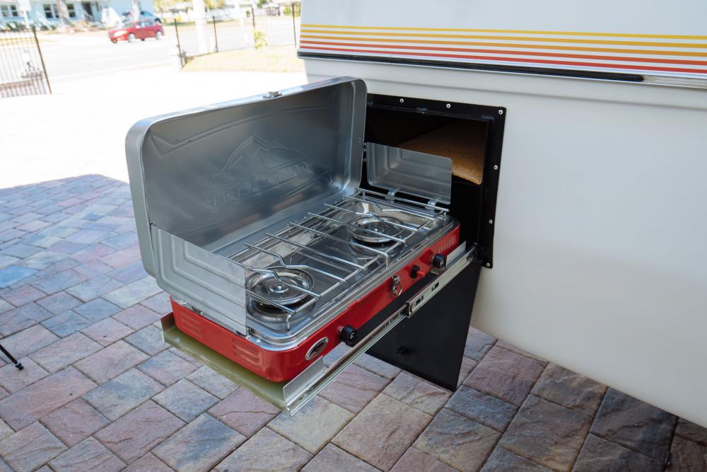

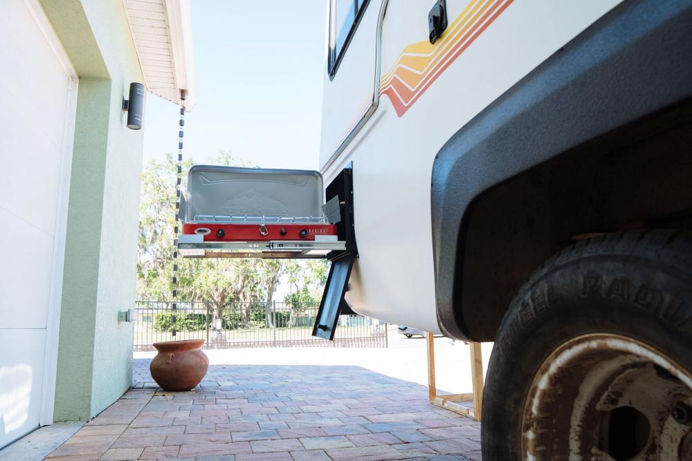

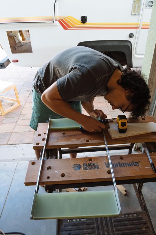

Getting the sliders and bracket ready for cooktop
Finished support for cooktop
MAK01637.thumb.jpg.165d85b5af703d0ca1daf5d0c90784fd.jpgMAK01641.thumb.jpg.c4ddceeccf3a1ac8810519b09e593ada.jpg
All done!
In their homes!

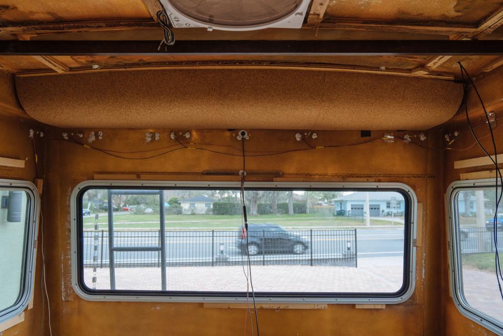

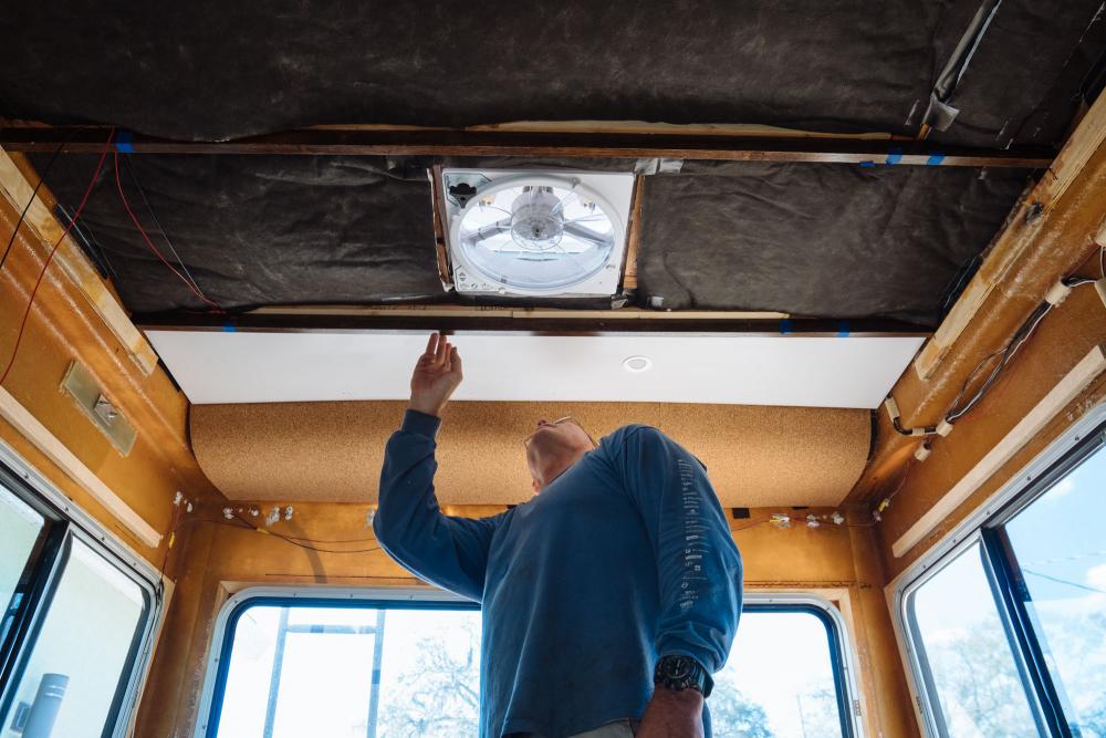

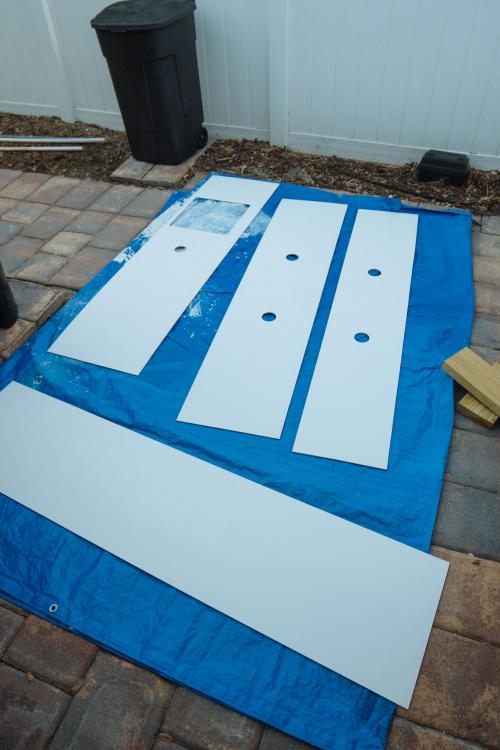

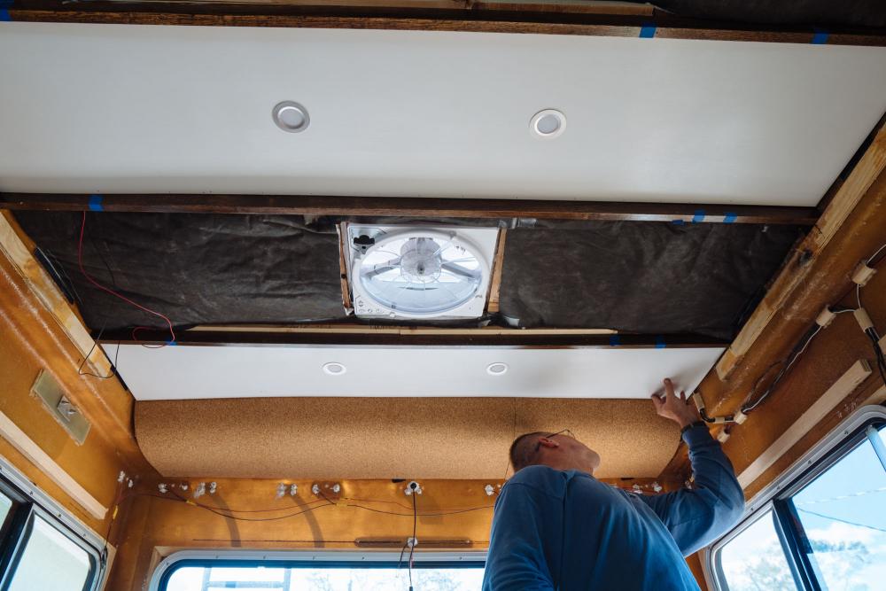

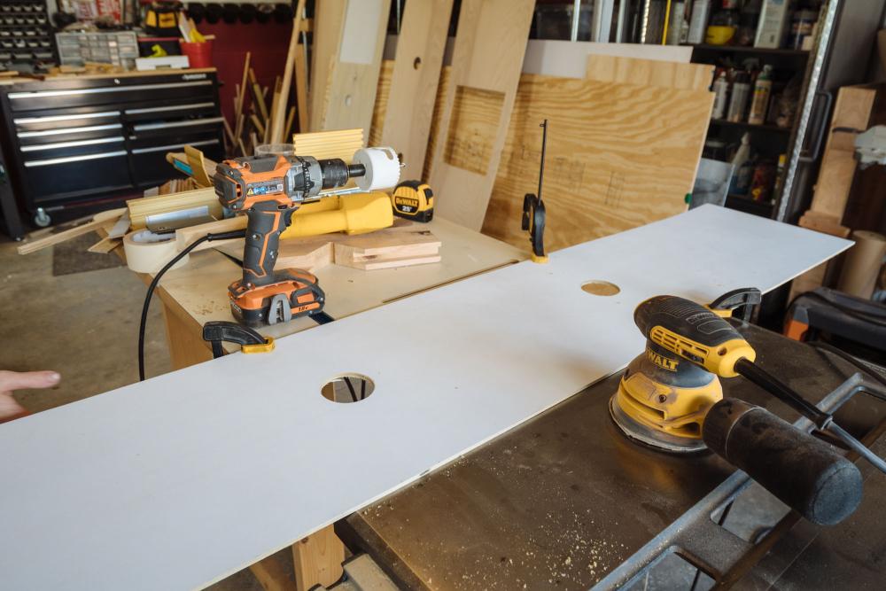

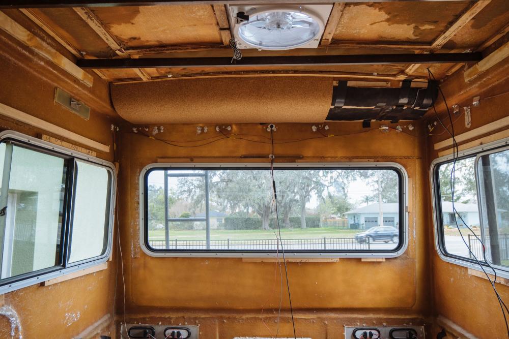

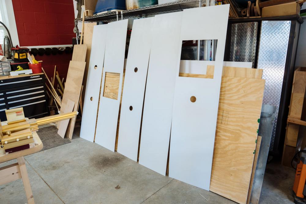

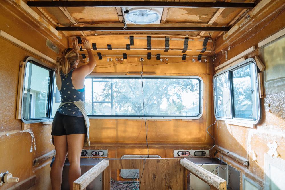

Amelia's starting to look good on the outside, but the inside needs some love too. Up next for us was the ceiling. The first part we decided to tackle was the weird bit in the back. It's kind of a rounded step and was previously covered in carpet which makes sense since carpet is flexible enough to follow the curves of the roof. Unfortunately, carpet isn't a part of our design plan so we needed to figure something else out. We started by adding some supports, then insulated, and covered it with cork underlayment. The cork is flexible enough to follow the curves and will compliment our floors, which will also be cork.
MAK01209.thumb.jpg.62832004282abeffb402d65d6511bbed.jpgMAK01214.thumb.jpg.0b3d9ed5e7fdf54a94696405738691ef.jpgMAK01217.thumb.jpg.c165a2f2ed10b37bf413b7528f275960.jpgMAK01225.thumb.jpg.a72305140cbfb216575e47358ff5c77e.jpg
All covered up!

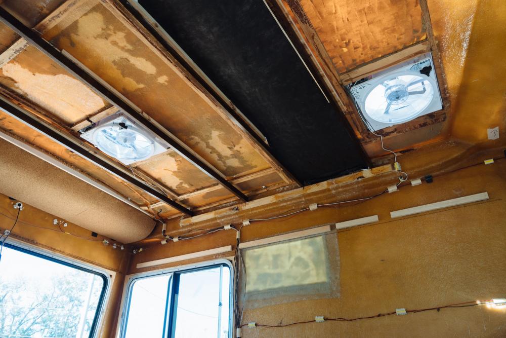

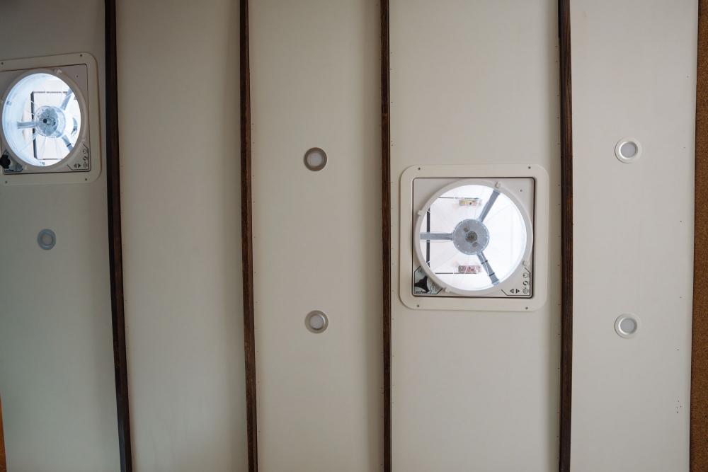

Now the fun part starts! We added a few degrees of difficulty to our ceiling installation by having exposed "rafters". You might have noticed them in some of the pictures. They are dark planks that we are using for additional support for the upper cabinets. Because of the rafters we needed to divide our ceiling into five separate pieces! We're also adding in recessed LED lights in ceiling so we needed to add holes for those AND the holes for the roof vents. The extra fun part (at least for me) was that with the lights going into the ceiling, I got to do some electrical work (my favorite part of the whole process!).
Hole for vents
Good fit!
Holes for lights.
MAK01286.thumb.jpg.0fbf4ef40660c34b5f9eee3fc1ebdd7c.jpgMAK01309.thumb.jpg.2b6261d1764133170712a8d5e595a332.jpg

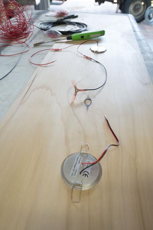

Fresh paint. In the right image they are lined up in order, left is the rear and right is the front.
MAK01321.thumb.jpg.72599ced2d1146a0ffe80ed836db5105.jpgMAK01315.thumb.jpg.b76346106b86da8c00fe2d0793b53614.jpgMAK01314.thumb.jpg.31d5a751b61ecfb789e349c0acf3f955.jpg

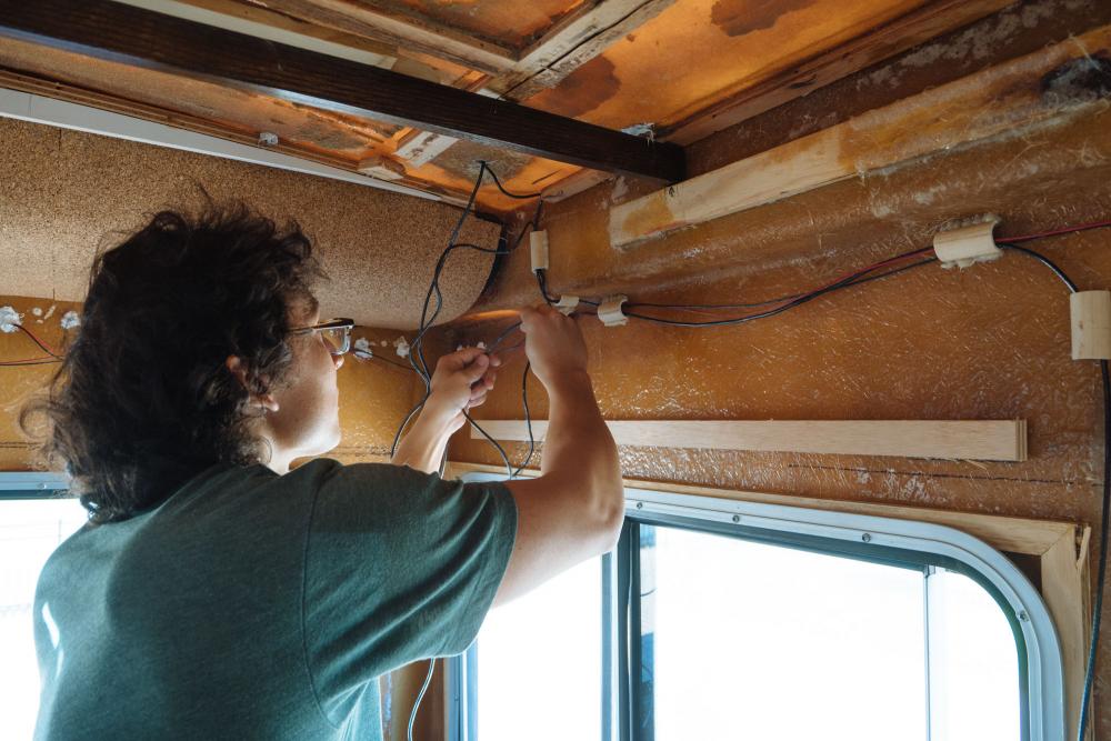

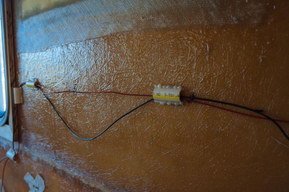

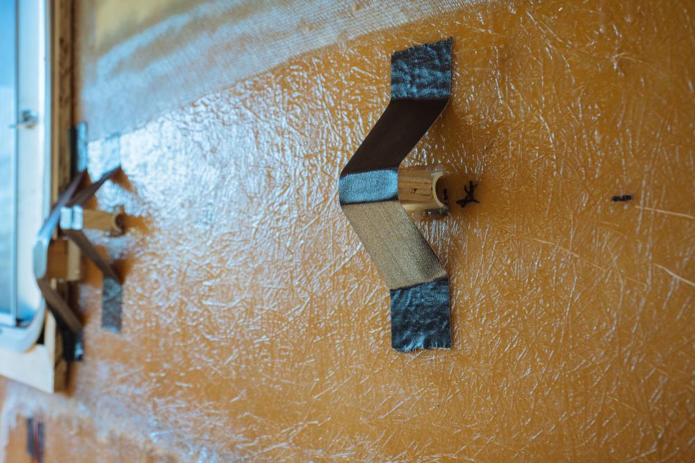

Wiring lights together with some 3 way connectors. Later I found some better ones for this scenario. With the ones pictured I needed to cover the centers because they weren't insulated and I didn't want to risk the positive and negatives touching and shorting the lights.
MAK01325.thumb.jpg.7ef6f86af4810bacf152387c551331db.jpgMAK01328.thumb.jpg.2c762ee1f147860e45507703f4f708ad.jpg
Insulation going in!
First panel in.
Panel 2. We did the panels with lights first so we could get the wiring squared away.
:D
This was a huge step for us mentally. Things had been dragging for a while and to see some progress like this gave us a huge boost. As previously mentioned some electrical stuff had to be done to get these lights installed. We ran all the wires for the lights, fans, solar, USBs during this time so that they could be behind the walls. The inverter, fridge, and water pump we will run through the bench seats. For wiring we laid in some halves of PVC to help keep wires organized and protected. We also used LOTS of zip ties.
Epoxy curing
Epoxy cured and wires in place
Unfortunately I bought some of the unruly 10AWG wire from Home Depot for the solar and I regretted it during this part of the process. It hates making turns and the coating on it is a pain. In the end it's fine, it just drove me crazy during this bit.  MAK01311.thumb.jpg.625aa5e6742c854674cee874ec79bff8.jpg
Testing lights and dimmer switches (it worked)!

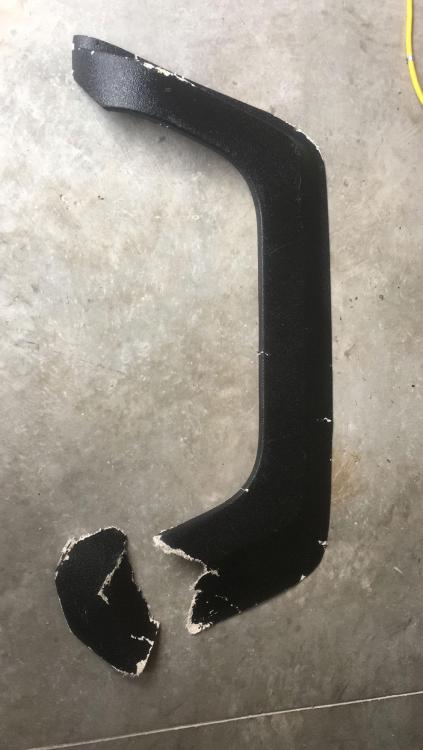

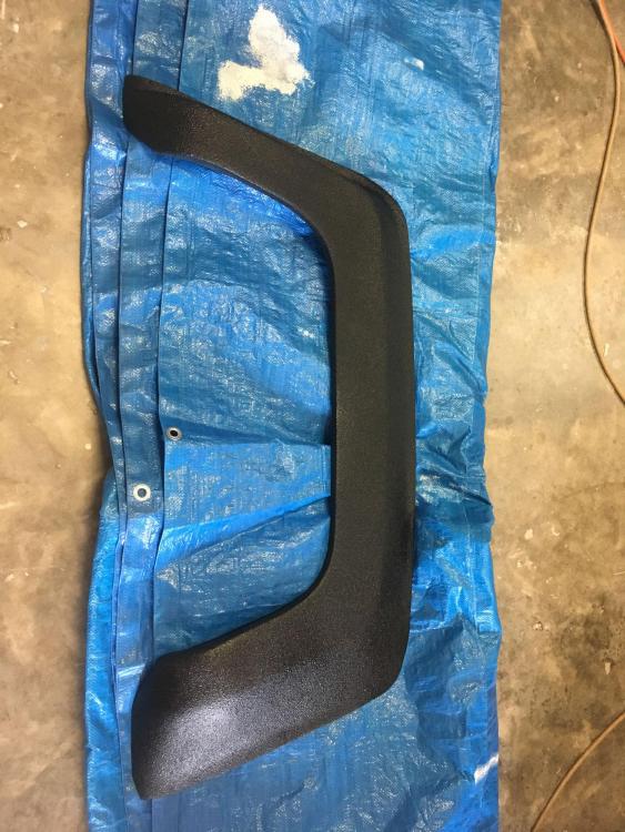

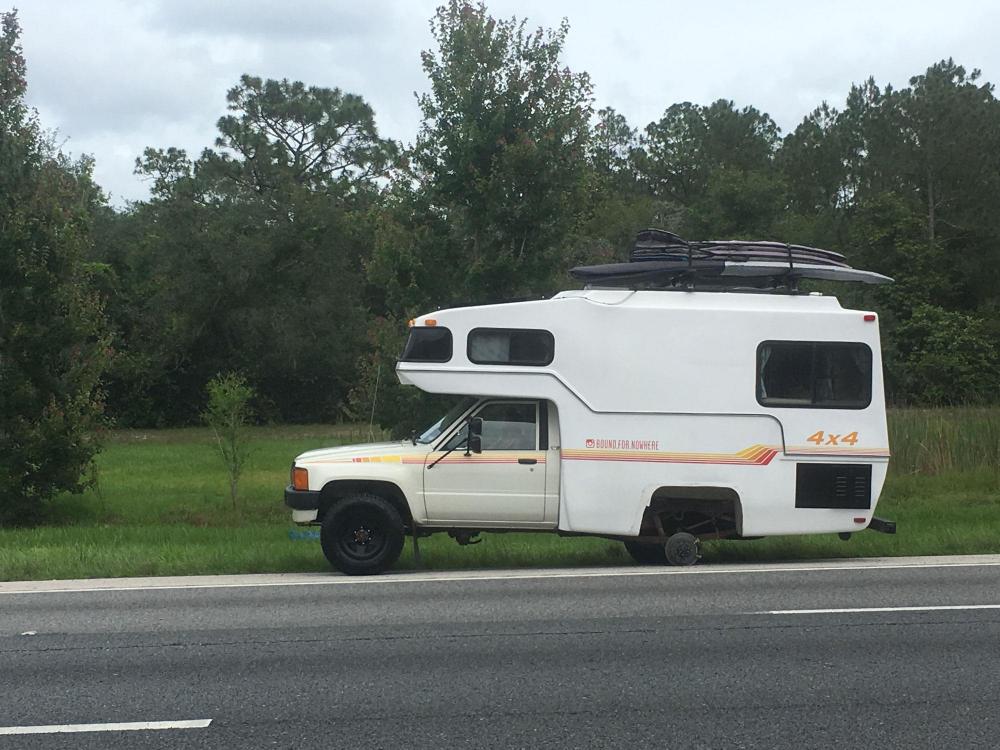

By any chance does anyone have a rear fender flare for a Sunrader. Ours is a 1985 (not sure if there are differences). We had a the wheel fly off on the highway and it left our fender in two pieces. As far as the cause, we aren't 100% sure. We got it back from the shop the day before where they had done the FROR Full Float conversion. Right now, the shop suspects that the lug nuts weren't seated properly (or weren't tightened). Either way, we need a fender. If anyone has one that they'd be willing to sell to us, that would be fantastic. Thank you!
IMG_3592.thumb.jpg.8f9ae5511fb7ff209df058a5972cc7f4.jpgIMG_3594.thumb.jpg.c855d000248a48491f4569c65d42c909.jpgIMG_3595.thumb.jpg.3e279d133aa82301581bf514f08c5310.jpg
Sad day for us. We were officially leaving to live on the road. Obviously, we're going to have put that on hold.
Edited by Boundfornowhere
wow, so sorry for you. hope you get on the road again soon. I have seen fender flares on the internet, maybe E TRAILER ??, the ones I looked at were close in size to what you have, not an exact match, maybe someone can guide you to an original replacement. good luck, hang in there. joe from dover.
4 hours ago, Derek up North said:
Too bad you're not near me or I'd offer to stick those 2 pieces of fiberglass back together for you.
While we're waiting to hear from potential options we're actually attempting to do that. Do you have any recommendations on how you would approach reconnecting them? There's a gap that needs to be bridged that's small on one side, but about 5" on the other.
I don't think I'd even to try to describe how I'd do it because I don't know how I'f do it without being there with the pieces in my hand. I'm guessing it'll take some improvisation.
Fiberglass mat on the inside and Bondo on the outside to fill it. Lots of room inside so make it thick enough to be strong. No one will see it. I hope you saved your gasket that was on there. No more of it anywhere.
The gasket is long gone unfortunately. When we took off our fenders to paint the body they were in rough shape and we decided not to put them back on.
Well if you were ok with them being gone it doesn't really matter.  You can make them look fine I'm sure. Unfortunately it does take time and pretty sure your tired of fixing stuff
Shape Styrofoam as needed, glue it in to remaining pieces. Rough sand it a bit undersized. Use mat or heavy glass cloth. Make it a bit thicker than needed and sand to shape.
If the foam blocks mounting just pour some gas on the foam and it will desolve.

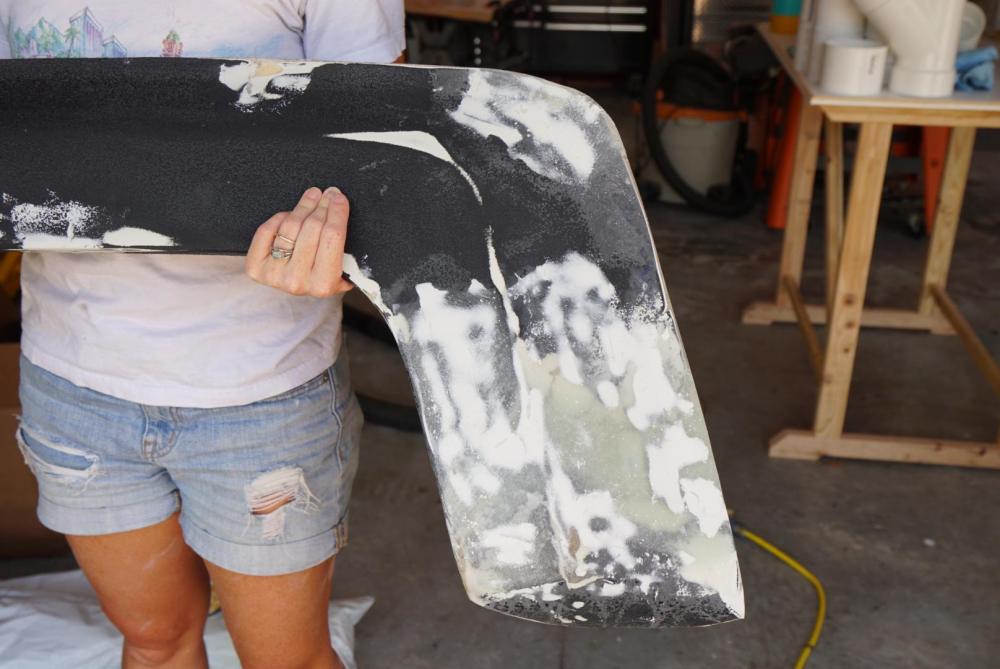

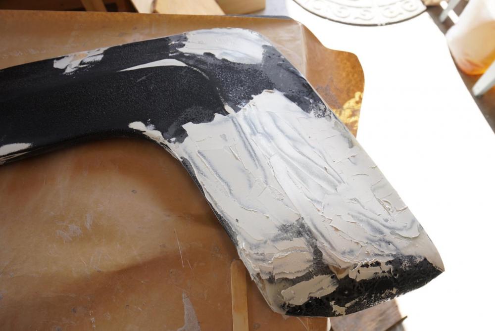

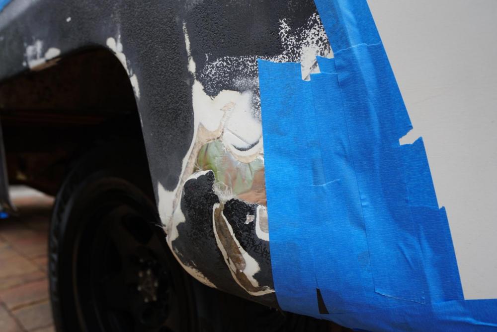

Thanks for all the advice everyone. We got it back together and painted it and I think it turned out really well. Luckily the paint we are using (raptor liner) helps disguise a lot too. We're going to put it back on the body today (weather permitting).
IMG_3595.thumb.jpg.6041d4c3343210ba61a7eaddb62e3dba.jpgIMG_3600_Web.thumb.jpg.8eedb7173ac91aed1517f8ef54bff4a2.jpg
A before and after.

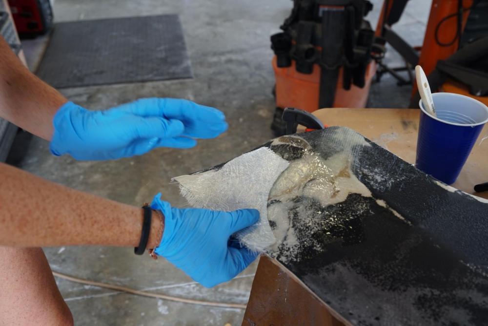

So since it was in two pieces we mounted it up to the body, making sure the holes that remained lined up properly. Then we put in rivets (but didn't actually install them, just used them as pegs) to hold it in place. We also taped them for added security. We then fiberglassed the pieces together at the shortest gap and let it cure. IMG_3610.thumb.JPG.a23e2eb4d5dc37e7c996eaf8c3096f76.JPG
Shortest gap is the left part here.

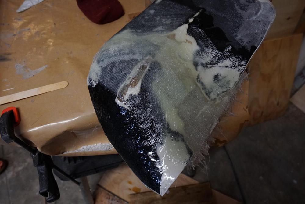

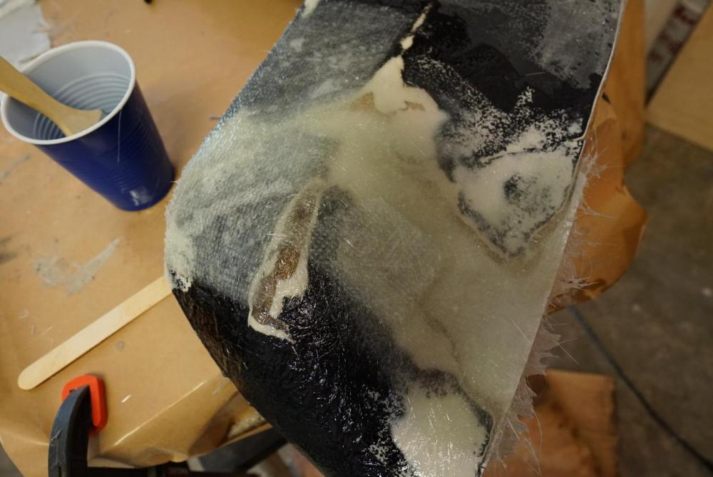

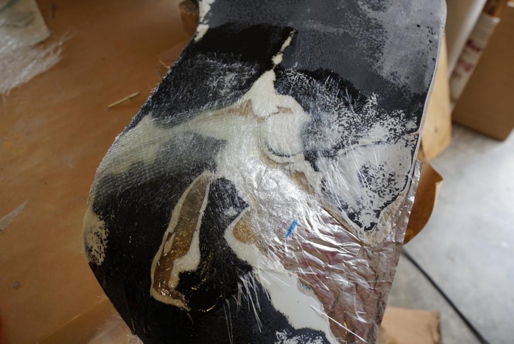

Then we took it off the body and got to work with the rest of the missing area. We used this silver duct work tape that we discovered by accident can peel off pretty easily from fiberglass. Sometimes it sticks a small amount but it's easy to scrape or sand off.
 IMG_3603.thumb.JPG.462adc1db015c4d9c1f79d1bfb00dfee.JPGIMG_3605.thumb.JPG.33dd75fe43bf20c486213c71d281770c.JPG
After getting the front finished up, we moved on to the back side.
Once all that was cured, it got sanded down. We wiped it down and did some surface fairing to fill in pinholes. Then sanded again, and wiped it down.
IMG_3608.thumb.JPG.aa6b31839aad6aa287fdc14c3148e62a.JPGIMG_3609.thumb.JPG.bd6ce5653c1d6ec2990cf372f13e3251.JPG
Then all that was left was to paint it and drill a few new holes. The result of the paint was back at the top of this post.
We'll get back to our regularly scheduled programming soon since we're done now, or at least we were till all this. Thanks again everyone!
Quick pull a mold off both fender flares. In the future you can support your travels selling replacements to unfortunate owners who are in need.  With all the money your going to make you could find a custom rubber molding extruder and get a couple thousand ft of fender flare molding made. Its approaching its weight in gold value. ?
