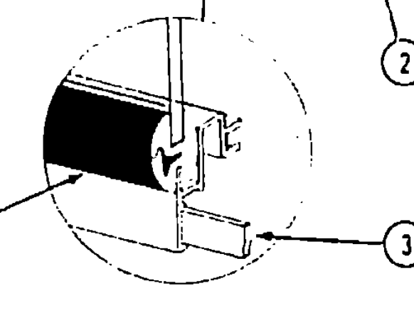

linda s Posted September 25, 2023 Posted September 25, 2023 Think about it. There is no way they installed the glass and rubber seal and then welded to frame together. There must be some way to install it with the frame intact. Here is how it's put together. Difficult but doable Linda S Quote

linda s Posted September 25, 2023 Posted September 25, 2023 Flip that frame over and let me see the other side. The side your showing is the inside. Glass goes in from the outside. Show me your rubber seal too Linda S Quote
Ctgriffi Posted September 25, 2023 Author Posted September 25, 2023 (edited) Not sure how the glass-and-seal could go in without cutting that weld, but I appreciate the feedback and here are some more pics! (Frame will get cleaned/sanded/repainted before assembly, don't worry.) Empty Frame - Front Side Frame w/Seal Partially Installed Seal Profile Edited September 26, 2023 by Ctgriffi Quote
WME Posted September 25, 2023 Posted September 25, 2023 (edited) The glass is smaller than the frame opening. Slip the gasket into the frame, Flex the gasket insert the glass and then install the lock strip. An old school glass guy will have the skill and tools. Edited September 26, 2023 by WME Quote
