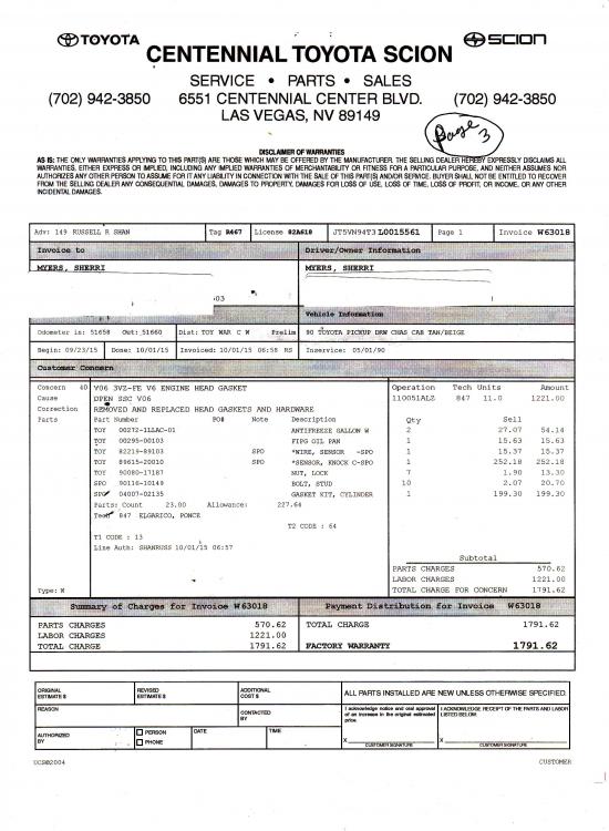

- Over the years, a few people have posted their invoices from having the HG SSC done. 1 included oil (but no filter!), 2 didn't. Maybe you could ask your friend if there's actually a Toyota 'List' of what's included and what's not!

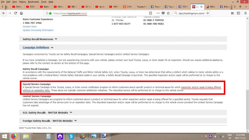

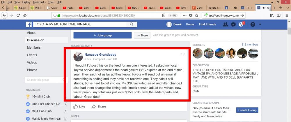

On 10/27/2017 at 8:09 AM, Derek up North said:
- There's a report floating around that the SSC ends at the end on this year yet Toyota's website says that all SSCs have no expiry date.
Sounds as though the report was false. Hoping that someone can confirm this. :)
Or is it just continuing in Canada and not the US. I heard from a group member years ago that when he went to get his done in Calgary they told him the recall had never been issued in Canada. He had to deal with Toyota directly and after months they finally gave him permission to have it done close to home. I guess we will know when they finally start telling people no.
I don't know if it's just a Canadian thing for sure. I've asked several people who are getting the SSC done to ask and confirm, and this is the first person who's taken the time to do so. But from the Toyota USA site, SSCs do not expire. :)
