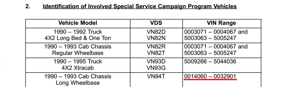

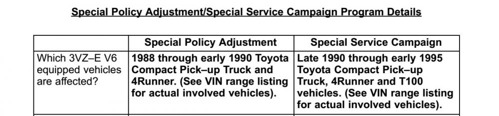

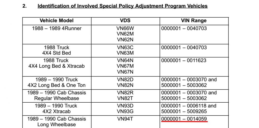

Derek up North Posted March 27, 2017 Posted March 27, 2017 Since I'm still seeing some 'confusion' about which V6s are and aren't covered for HG replacement, here are the VINs (extracted from the Toyota documents) for the SPA (Expired) and the SSC (not expired at this time). I don't think we need to consider the C&C 'Regular Wheelbase', only the 'Long Wheelbase' V94T C&Cs. Edit: I wonder what was built on the Regular (short) Wheelbase C&Cs. The rare V6 Sunrader 'Shorties'? The even rarer V6 Bandits? Quote
linda s Posted March 27, 2017 Author Posted March 27, 2017 Regular wheelbase certainly would be the ones you mentioned but also the Odyssey Starlite , a pop top, and the Odyssey 4X4's Linda S Quote
Derek up North Posted March 27, 2017 Posted March 27, 2017 46 minutes ago, linda s said: ... also the Odyssey Starlite , a pop top, and the Odyssey 4X4's AKA 'Unicorn' motorhomes! Quote

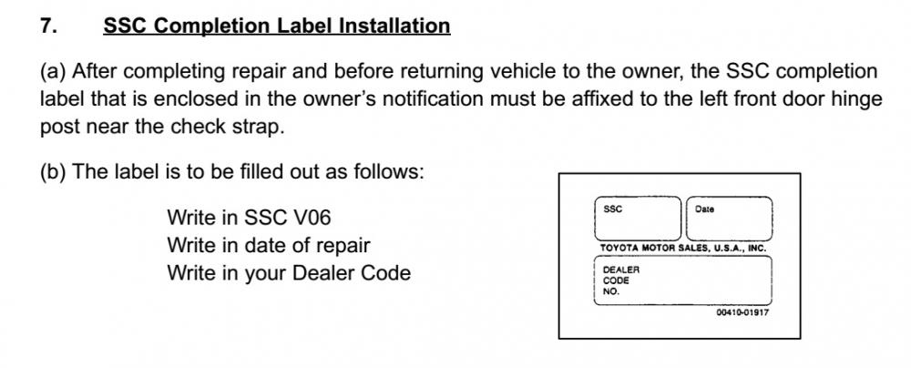

darrel Posted March 27, 2017 Posted March 27, 2017 My 1994 Warrior did have the head gasket special service recall campaign done. Don't recall when. Do not have the SSC campaign label affixed. Darrel Quote
Derek up North Posted March 27, 2017 Posted March 27, 2017 I'm not sure how diligent they were in installing the labels. I don't think I've ever read anyone saying "Mine was done because there's a label." Here's what it looks like, for those like me who have never seen one! Quote
