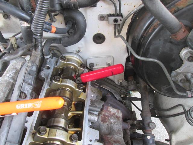

jjrbus Posted June 8, 2018 Posted June 8, 2018 #$%^&#@ Valve bucket too! I found holding the bucket down and removing the shim very frustrating, 25, 30 attempts, start to pull the shim out and zing, the tool pops out. To the point of getting ready to pull the cams to get the job done. I am reading and watching video's about this, a guy doing it on a bench in a shop is not real world example. I looked the situation over and decided that the cheap Ebay valve bucket tool is too thick and the edge that sits on the bucket is not flat enough with a good edge. So decide to grind it down as I cannot possibly makes things worse. https://www.ebay.com/bhp/toyota-valve-tool I ground about 1/3 of the thickness off the tool and carefully filed the end that sits against the bucket, to produce a nice square edge. I started with a 1/3 thinking I could always take more off and/or throw it on the roof! IT WORKED! If you saw me pulling shims out you would think I was an old time Toy mechanic that had done this 100's of times? In the photo I highlighted in black the area I removed material from and where I filed, I tried to remove the same amount from each side of the tool. Also as it was the 7th day I tried calling the Toyota dealer about my parts, 6 times I called, hung up on, put on hold and forgotten about. Eventually got through to parts and was told my parts were ready for pickup, wonder how long they had been sitting there waiting for me to call? Quote

jjrbus Posted June 8, 2018 Posted June 8, 2018 Seen some writeups and videos on the web, all doing on bench or #3 cyl, the easy one! Well here is #6, in the real world, everything went well till this point. I used 3 tools for the rest but there is no room to work around #6, wires and hoses are in the way and the engine lift bracket needs to come off. There is not enough room for the tools, so I got the angle grinder out and chopped them down to a usable length. I was able to use 1/2 the clamp type tool and get the short wedge type tool in place to get the cut down bucket hold down tool in position. The bucket tool cannot be seen when it is in place and if it is a bit out of position it will block the shim from coming out. #6 was still a bit frustrating as nothing wants to cooperate. Compressed air pop'ed the shims out on all but #6, it had to be pried out. Safety glasses are a must on this job as everything is under pressure and wants to spring out of place. I rotated the engine by hand a couple turns and remeasured all clearence's 1. .010 .254mm 2. .012 .305mm 3. .011 .279mm 4. .010 .254mm 5. .012 .305mm 6. .011 .279 Quote
