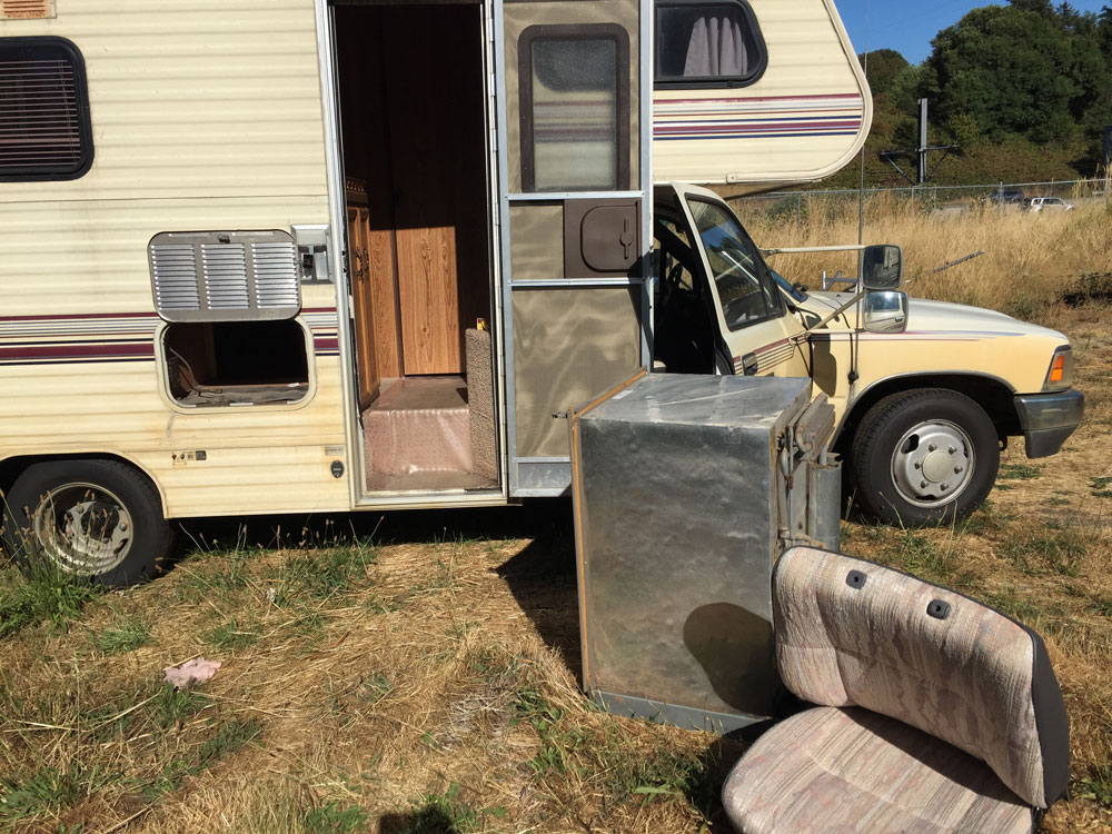

jfunk Posted August 6, 2015 Posted August 6, 2015 I have a 1990 Dolphin with a fridge (Dometic RM 2401) that is not working. I plugged it in to electric while the RV was on power and it "ran" but did not get cold. Also lit the propane and ran with that on max cold and it did not get cold. After running a bit I opened the door to the fridge and could smell ammonia. I mentioned this and was told that any ammonia smell means the unit is dead. After this I was told: Try this before you buy a new one,, Take the refrigerator out of the RV, Turn it upside down and let it stand for for 24 hours. Many times the ammonia gets clogged up preventing a free flow. I am going to give this a try as either way the fridge needs to come out as I have an AC dorm style fridge I plan to put in there and use with an inverter. I am wondering if anyone has advice on the easiest/best way to remove the unit. I am particularly concerned about the gas line. My plan was to turn off the propane at the tank and then unhook the fridge, but I am not sure the proper way to cap the pipe or hose that runs to the fridge if there is no valve there. Thanks! Quote
Derek up North Posted August 6, 2015 Posted August 6, 2015 The 'normal' easiest/best way to remove is through the cab passenger door after removing the seat. Quote
5Toyota Posted August 7, 2015 Posted August 7, 2015 as far as I know tipping them upside down was to try to clear a clogged line. if you smelled ammonia the unit is dead it has a leak. Quote
Maineah Posted August 7, 2015 Posted August 7, 2015 Smell = dead fridge turning it upside down will just allow you to see the bottom of the fridge. A hardware store will have a 3/8 pipe plug that you can screw in the fitting for the fridge be sure to check it with soapy water after you install it. There are several co's that sell rebuilt cooling units that is an option some thing around $400 and some do it your self labor.. Quote

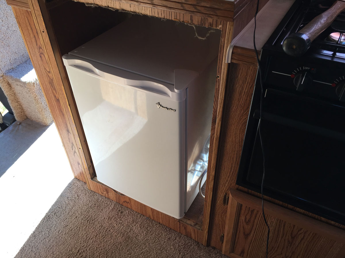

jfunk Posted August 9, 2015 Author Posted August 9, 2015 Fridge indeed was dead Thanks Derek up North for the advice on removing the unit, it would have taken me a long time to figure that out Put a small dorm fridge in where the old unit was. Need to add some structure around it to secure the fridge, but am excited I may have some new storage space around it since it is so much smaller. For the moment I used a 3/8" plug to cap the gas line. I would really like to terminate the line at the stove, but not sure how to do that. Quote
Maineah Posted August 9, 2015 Posted August 9, 2015 It will involve some new copper the plug should work fine for you just be sure there are no leaks. It's not much pressure but it still needs to be checked for leaks just as one would do with new copper line. Quote
kgragert Posted August 10, 2015 Posted August 10, 2015 I would be interested in how that Magic Chef fridge works out, I have the same one and was thinking of replacing the one in my Dolphin with it. Quote
WME Posted August 10, 2015 Posted August 10, 2015 The dorm refer installs have had varying degrees of success. The better one the owner installed extra foam around the sides and top of the unit to super insulate the back and cut down on the time the compressor was running letting the battery last longer. Quote
