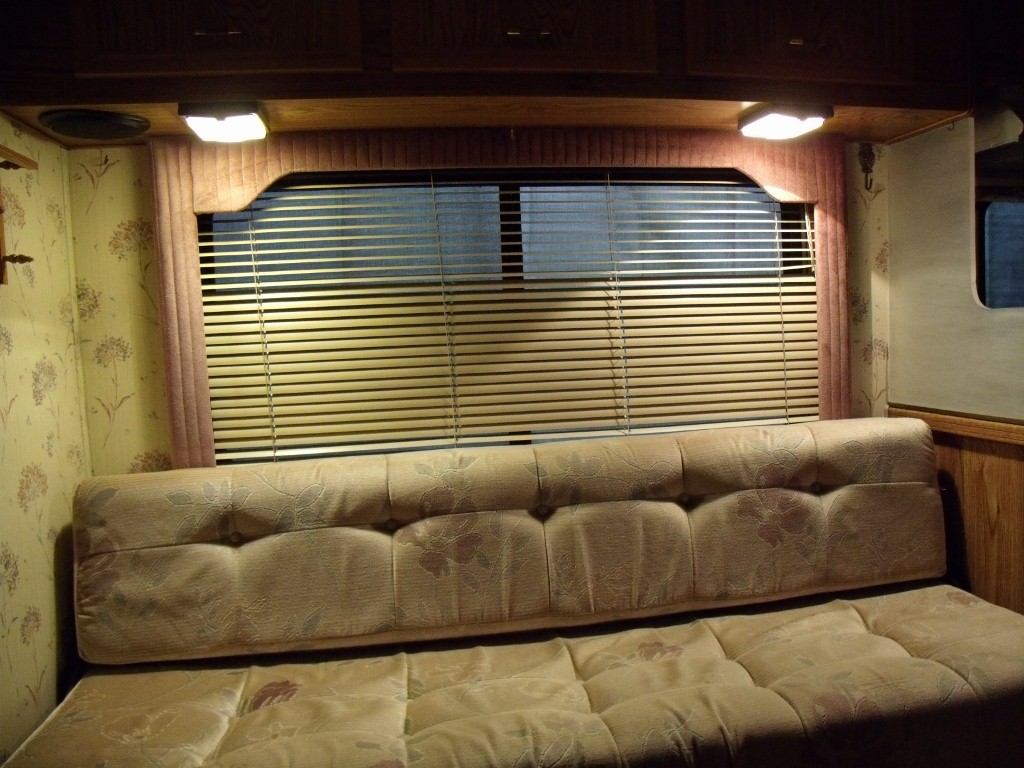

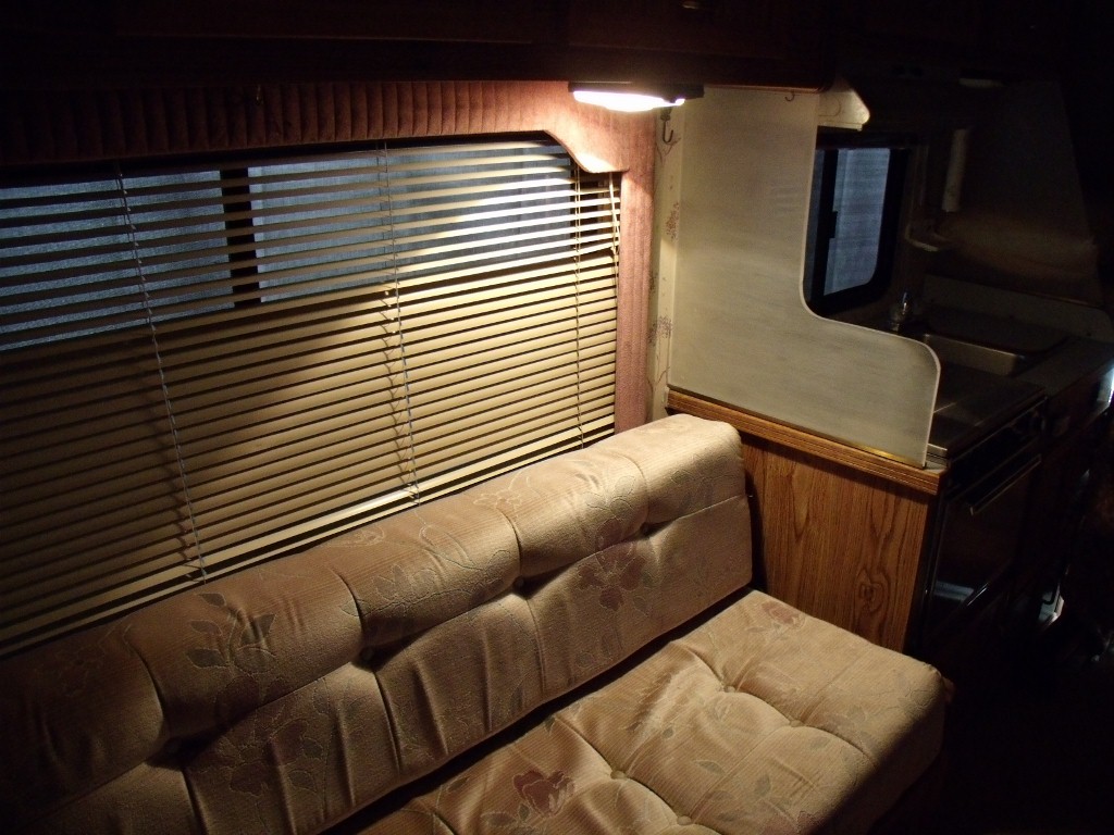

these LEDs that krilov posted about are really nice imo...here are some pics, led is in one and incandescent in the other....which one is led??
I metered them for amp draw, the led pulled .24 amps, the incan pulled 1.38 amps...so u can use 6 led lights for the amp draw of 1 incand !!...so u can sit on the sofa with 1 incan or have the whole rv lit up with LEDs for the same amps!!
the only fault with them is the base does not fit socket so I had to solder the adapter to the switch...but for $5 a bulb I will do it!

I'm going to say the one on the left is the LED.
BUT I'm not saying that because of color (I can see a slight difference in color)
The light on the left looks more dispersed and even than the right. If these are standard lenses (light covers) then have like a magnifying lens in the center to give it a focused beam. You can see this on the right, but its not on the left.

I think the one on the right is the LED. The light looks more directional. The incandescent light throws light around in all directions where as the LED just throws it downward. Also the color in the right side seems like it has less bandwidth. Not as warm as the left.

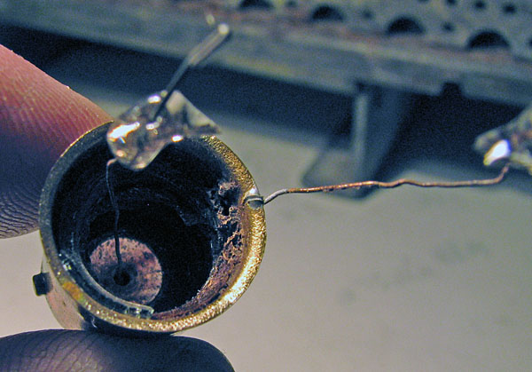

I took my old bulbs and broke the glass out then soldered in the new wires. My LEDS are from superbright and they are NOT polarity specific. In other words positive can be connected to either terminal. I think the eBay ones I believe do have to be connected correctly, positive to positive and negative to negative. I bring this up because I have seen a few RV's where the polarity of the socket (the light itself) were opposite of what they should have been, in other words wired backwards. So check with a voltmeter before you do anything. Normally the center is positive and the outer bayonet barrel is negative. My pics do not reflect this because my LED's do not care. If yours do not light up it might just be that you have the polarity backwards. Note that I removed the pins and soldered directly to the board.

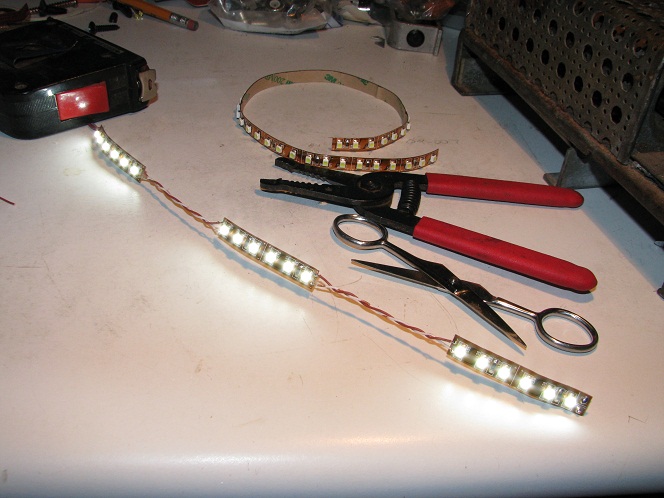

Here is another eBay item. They are LED tape strips. They can be cut into groups of 3 then soldered together to distribute the light. I have some in my cabinets and under my range hood. They have a self adhesive backing to stick just about anywhere. Here are some pics of them. I used the small gauge wire in cat5 cable for the interconnects. Also you have to solder them on the LED side, not the tape side. The tape side has too much glue to get through in order to get to the solder taps. The cabinet lights are set up with micro switches on the doors. When the door is open the led's are on!

OK...the led is the light on the left........and I got the new order delivered today from china...only took 8 days
thinking I will do like Greg did and break the glass on my 1141s and solder the leds to the socket rather than to the switch like I did with the 1st one
