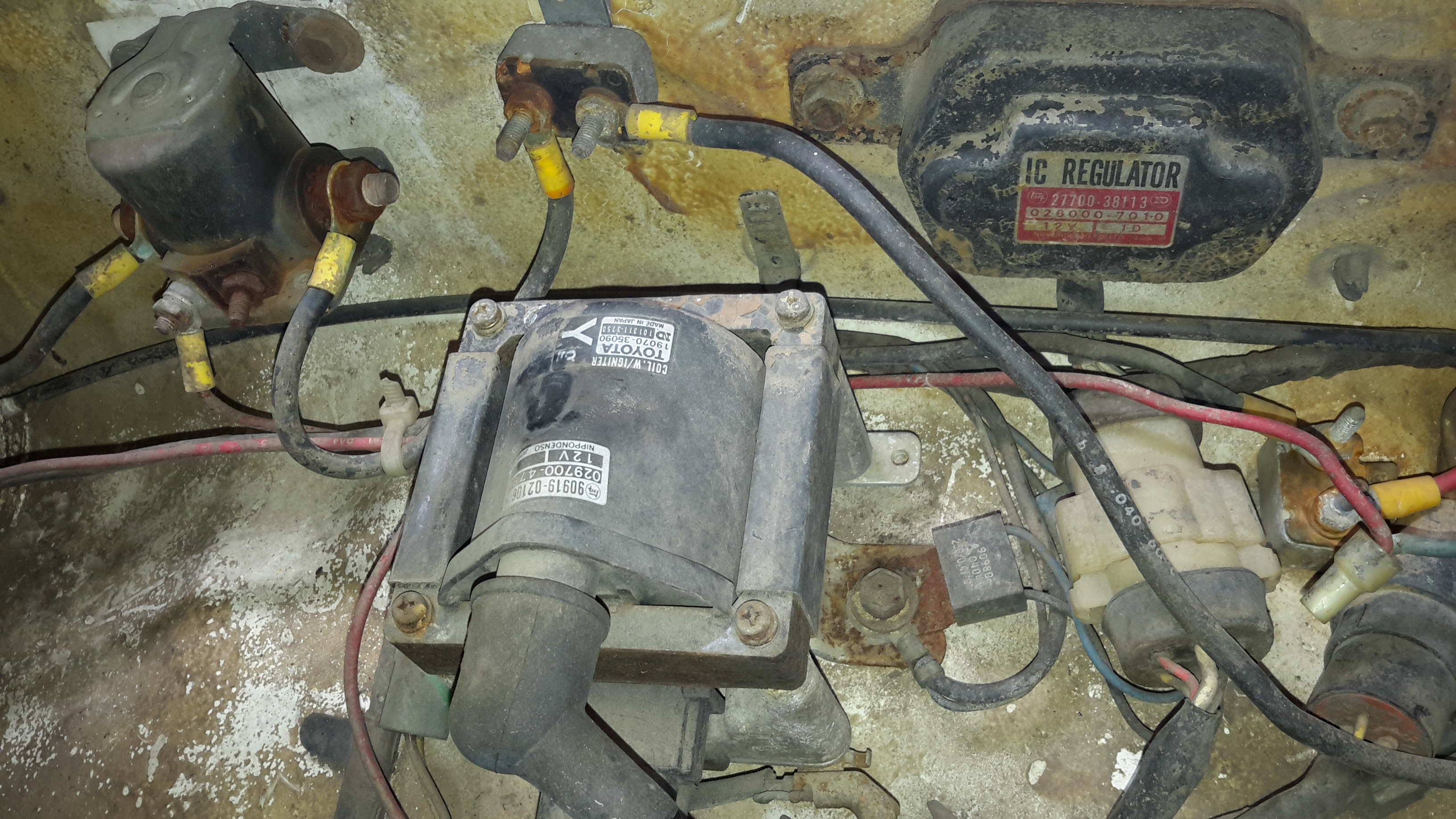

I'll check it out tomorrow and get back with an answer. ok. We checked the voltage on the coach battery terminal. It registered 12 volts. So the isolater relay is toast? Both batteries were charged 2 weeks ago. Both batteries registered 6 volts, when we checked today. I'd like to know where all that power goes. A big short somewhere? My hubby & I are trying to figure it out. All coach lights, pump, ect.. runs off the truck battery only. But nothing seemed to run off of the coach battery, when we had it charged to 95%, but yet it's losing charge. Btw this coach battery is only 2 yrs old. It is an AGM type, but would this make a difference? The truck battery was replaced last year. We keep it on a battery tender on the truck battery 8 months of the year. Maybe the coach battery was toast, when I first plugged it in a couple of months ago..... ?
The middle red wire goes to the coil w/igniter.
Does anyone have a link to a good replacement isolator? Also could you take a pic of it, to make sure that I'm looking at the right thing? I could take a pic, but I'm not sure about how to post it here..... ?
The coach battery checked out at 95%, so is fully charged. Next, I will try to find the possible isolator short, after the t-storm passes. Thanx! ?
We were wondering why the truck battery in my 84 Toy Dolphin was always running down. We disconnected the coach battery and turned on the coach lights. They worked, along with the water pump. We disconnected the truck battery and connected the coach battery. Turned on the coach lights. Nothing worked. How could this be? I have no idea what to look for. It's like they're not hooked up right. We've been having battery troubles lately, where we haven't a few years ago. I did get a tune up done about the same time that we started having battery problems, but I just don't know if it's relevant or not. I know that there is an isolation unit, but not sure where that is or if it's the problem. Thank you for any help, guys.
