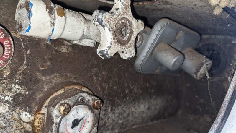

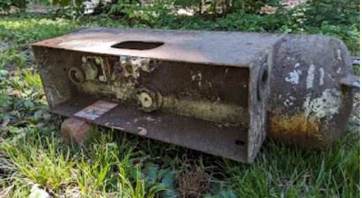

I have a horizontal mounted propane tank that needs some attention.    All of the valves and fittings are original from 1988 I believe.  The fill valve started leaking a tiny bit based on a soap bubble test after it was filled it the other day. The service valve seals when all the way in and out but leaks a bit when opening/closing.  I am planning to use the rest of the propane in the tank, then disconnect the tank at the regulator to service valve connection, removing the tank from the vehicle and then refurbishing it.
The refurb would involve replacing the fill valve, the service valve and the regulator.  The bleed port and float gauge seem to be working ok so I might as well leave them alone.
There are square flange fittings that have some sort of gasket holding the threaded inlet ports to the tank.  I am planning to leave these alone rather than trying to take them apart and replace the seal.
I will clean the tank and re-paint. There is only minor rust and the tank appears to be in good overall condition despite the grime. I’ll use the proper yellow teflon tape to put the new fittings in.  I’ll get the regulator from Lowes per Fred’s suggestion and the other valves from PropaneWarehouse.  I think these are the appropriate parts:
  • Fill Valve:  INLET 1-3/4" ACME, OUTLET 3/4" MNPT, MFG PART NUMBER 1855SD
  • Service valve:  ASME Valve with Relief, INLET 3/4" MNPT, OUTLET Female POL (CGA510), MFG PART NUMBER 3250BC312
The tank is not the removable DOT kind, it is the stationary ASME and so it apparently doesn’t need to be recertified.  I often have found that the U-Haul tech filling my tank will look for or ask what the certification date is.  Usually they just fill it after I tell them this is an ASME tank and doesn’t need recertification, but once they refused to fill it and I had to go somewhere else.  Am I correct that I do not need to have it recertified?  What about purging/leak testing and fill?  Should I get it all done and put it back on the truck and then take it to Amerigas or a similar place to have it purged and filled and then do a leak test with soapy water?
If anyone has suggestions about how I should be doing this job I would appreciate the input as this is my first propane tank refurb.

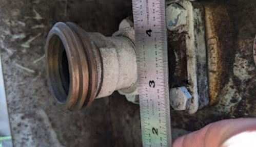

It seems I have an odd fill port size.  Standard sized are 3/4" NPT or 1 1/4" NPT into the tank.   Mine measures 1.2" OD (with calipers, not the ruler), which seems to be 1" NPT according to https://www.ultimatewasher.com/dimensionschart.htm:
This is a 1987 tank, all original parts.  The service valve (with integral relief) seems to be normal size at 3/4" NPT.  For the fill I'm thinking of just using the standard 3/4" NPT part from Propane Warehouse with a 3/4" to 1" NPT adapter like this:
If anyone thinks this is a poor choice or has insight into this NPT fitting size issue for the fill valve I'm all ears.  As long as I don't have leaks it should be ok.  I've not found a Fill valve with 1" NPT.
The tank itself is pretty dirty but I think it will clean up ok.  Issue now is that it's 3/4 full.  I have it hooked up to a turkey fryer burner to get rid of the propane.  Might take well over 24h to burn off at the rate it's going....
I'm also realizing it's going to be difficult to get a wrench into that confined space to get the valves on/off....

Yea, it's big and in the way.  I had to really wangle it around to get it out through the bottom of the rig.
In order to empty the tank I'm burning off the propane with a turkey fryer burner.  Slow but effective.  In the last 16 hours I've burned off about 30% to 40% of what's left.  Still a while to go though...

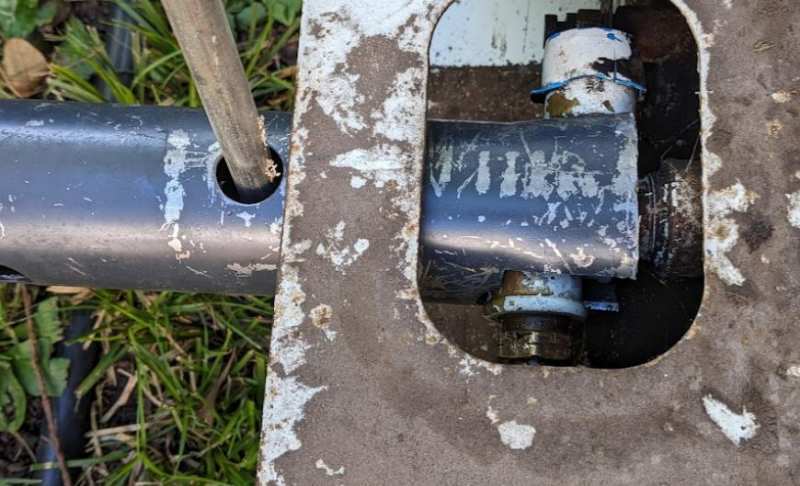

Excellent suggestion!  I looked up the tool and then fashioned one myself from a part I found in the garage.  It was just strong enough to move the valve so I think it will solve this issue of getting the service valve off/on.  The old fill valve has two flats on it for a wrench and I think I have just enough access around that big metal guard to get that off and the new one has six hex flats so getting the new one on should be fine too.  I'll have more room to work on that once the service valve is out too.  Here's my DIY tool:
All is going well and the tank is ready to re-install in the camper.
It took a full 48 hours to burn off the propane in the tank.  I cleaned it up and did a primer/topcoat and then took the valves out and installed the new ones.  I pressure tested by connecting an air compressor to the service valve with some brass fittings and pressurized to 100 PSI and did a bubble leak test.  No leaks were observed.  NOTE: I used DRY air to do this by running the compressed air through molecular sieves to remove the water.  Otherwise you are going to get water in the propane tank doing this step in the same way that you get water collecting in the air compressor tank.  In the humid South a lot of water comes out of the air when compressed.  I'm confident I didn't introduce water.  I then purged the tank with propane gas from a portable cylinder by injecting low pressure  propane into the service port and then venting with the bleed valve.  I did this purge cycle six times so I have only low pressure LP in the tank now.  I can now install the tank, new regulator and new soft hose and then go fill it up.

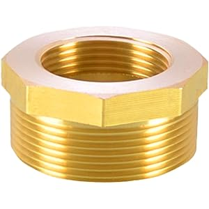

With regard to the odd 1" NPT fill port mentioned previously, it turns out that the fill port from 1987 was an odd two piece fitting with a standard 3/4" NPT into the tank flange but two halves that have a 1" NPT threads.  The new fill valve is shorter so I hope there isn't an issue connecting when it's time to fill.  Here is the new/old valve:
For reference, here is the tag on the tank once the grime was removed:
It's 10.2 gallons.  When it says 1/4 full and time to fill there is still about 2.5 to 3 gallons left.  I typically get about 4.5 to 5 gallons into it at a fill, which would then be a total of about 7.5 to 8 gallons at the 'full' mark, which is right near the spec of 80% propane = max full.
The tank was not too bad under the grime. I used 60 grit sandpaper by hand to get corners but mostly flap disc sander on a grinder to remove the paint/rust.  Took about 3 hrs total for the prep.  Here is the tank just before painting:
Here is the tank hanging where I painted it and it's drying and still getting the last of the propane out with the turkey fryer.  This is quite the redneck setup:
I painted with the old valves on, then took them off and put the new ones in.  I used a big 1-3/4" socket for the fill valve and that tool I made to put the service valve in.   I wrapped the thick yellow PTFE tape 4 rounds over the blue sealant as propane warehouse recommended. Bleed pot and fill gauge were left as they were.   Here are the valves:

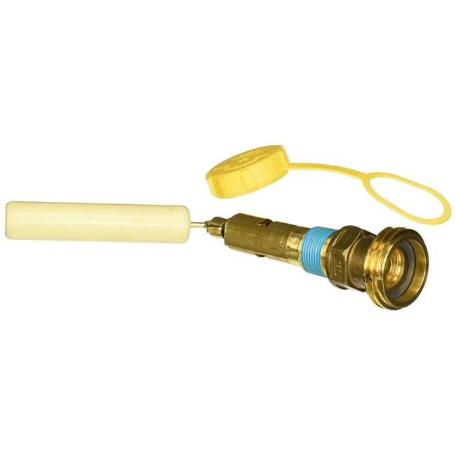

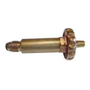

(a) When I look at the photos of the old and new fill valve, I wonder how either could possibly prevent overfilling (beyond 80%). The top part of the original label clearly indicates that there is some device in this tank that CLOSES when the tank is 80% full. This device cannot be the bleed valve since this OPENS to the outside; it does not CLOSE the flow into the tank. So, which part in the camper's propane tank provides the 80% shut-off function?
(b) When I googled for the construction of OPD-equipped fill valves, I keep finding things as the one depicted here:
Manchester-Tank-80-Stop-Fill-Valve-Acces
https://usfireplacestore.com/products/manchester-tank-80-stop-fill-valve-accessory?currency=USD&variant=46420388806826&utm_source=google&utm_medium=cpc&utm_campaign=Google Shopping&stkn=0f430486ccf9&gad_source=1&gad_campaignid=19798880789&gbraid=0AAAAACxnpLM57Y9-EIzoX8w7Zb_Ylcesn&gclid=EAIaIQobChMIiI79hsGYkQMVSLIDAB2VEDt7EAQYAiABEgJ0LPD_BwE
Here the way the OPD function is obvious. The valve closes through the action of a float.
AtlantaCamper, is it your understanding that the fill valve that you installed is equipped with a 80% shut-off feature? If so, do you, or others, have any clue how that works?
