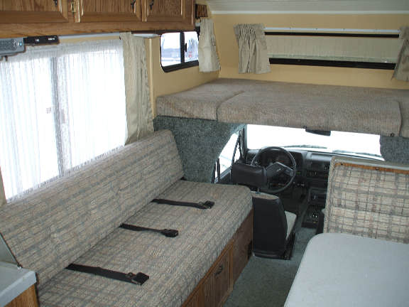

waiter Posted January 31, 2011 Posted January 31, 2011 Just about finished with the interior makeover. Repaint, walls and ceiling New clock New Thermostat New Blinds Washed Shears New Curtains and hardware Tiedowns for Microwave Under-Cabinet TV with AM FM and DVD player Fix Refrigerator Igniter Replace Furnace Blower motor Upgrade DC Converter John MC 88 Dolphin 4 Auto Quote
Derek up North Posted January 31, 2011 Posted January 31, 2011 Very nice. But too clean for me. I wouldn't be able to let my dogs (or myself) in to relax and enjoy it! Quote
waiter Posted January 31, 2011 Author Posted January 31, 2011 Went through today, straightened the door hinges (some were bent) also replaced several of the door lock catches that were missing or broke. Got the inside looking good. I havn't been able to do anything with plumbing yet, Its still to cold. but the gut I bought it from indicated all the water system were OK. so Hopefully no surprises in a couple months whe I put water to it. Quote

waiter Posted February 7, 2011 Author Posted February 7, 2011 Finished up the interior Makeover. The Cab-over has been repaired and the curtains have been hung. Quote
dayoff53 Posted February 11, 2011 Posted February 11, 2011 Finished up the interior Makeover. The Cab-over has been repaired and the curtains have been hung. So, not counting your labor (don't we all work free for ourselves?), what do you figure you have in it, including original purchase and all the repairs and upgrades? I'm jealous - it's beautiful! Quote
waiter Posted February 11, 2011 Author Posted February 11, 2011 I've been keeping track of my expenses. Summary is: Purchase - $5000 Retrieval (Airfare and fuel, New Mexico / Ohio) $620 Upgrades / Maintenance / Repair $2004 Total to date $7,624 This is for an 88 Dolphin 22RE (Fuel Injected) Auto Transmission 56,000 miles. The unit is now up to date and the interior is like new. A couple benefits of buying in New Mexico, there is ZERO rust on this unit. ALSO - The 1600 mile drive from NM back to Ohio, I've gained confidence and trust in the unit. All mechanical are up to date: filters, wipers, thermostat, hoses, fluids, belts, brakes, plugs, cap rotor, add Trans cooler, repack bearings on all four corners Interior repairs include: All new roof vents and covers, Reseal exterior seams, Front door Window/frame, Coach Battery, TV Antenna, paint, curtains and hardware, Furnace blower, Cabinet Hardware, Propane system repair/upgrade (Regulator, hose upgrades (ACME type), Tank inspection, spare Vertical tank) UPgrades: Coach DC Converter, Coach AM/FM/DVD/TV, LED lamps, Truck AM/FM radio, Truck Remote Starter, 1600 watt AC inverter, 600 watt microwave oven, Truck CB Radio and Antenna I still need to purchase new tires. I figure $100 each so that will be about $700. This needs to be done before the next trip in a couple weeks. Quote
