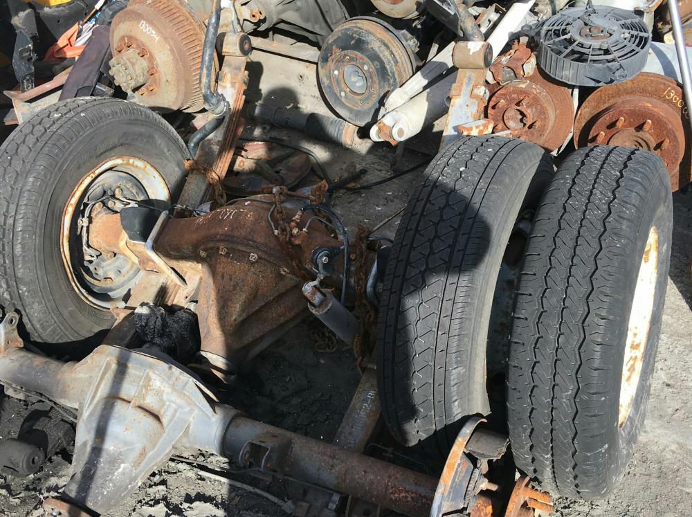

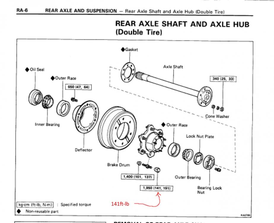

linda s Posted January 12, 2018 Posted January 12, 2018 This is a Land Cruiser axle but looks almost the same. Big difference is the lug pattern. ours are 6x 7.25. Very big spacing. See the big fat hub that comes out in the middle. That's what your looking for. Regular 4x4 Toyota's have 6 lugs but no big hub in the middle of the rear wheel and smaller lug nut pattern Linda S Couple of pics Quote
Derek up North Posted January 12, 2018 Posted January 12, 2018 Factory Service Manual. 1988 & 1993 Quote

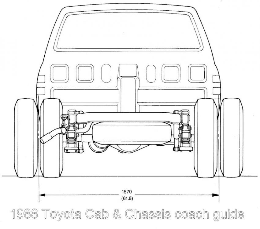

Derek up North Posted January 16, 2018 Posted January 16, 2018 The correct axle is just over 61" wide (WMS to WMS). Quote

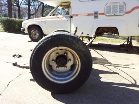

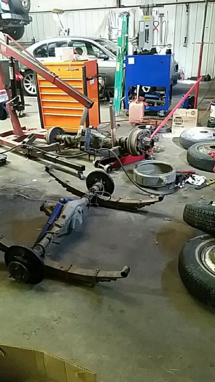

Cossacks Posted January 17, 2018 Posted January 17, 2018 Finally got a pic to load. Bottom of pic is coming out and top going in. Quote
WME Posted January 17, 2018 Posted January 17, 2018 Photo looks right. How about a pic of the "wrong axle". Maybe we can identify it and maybe get you a refund of some kind. Quote
Cossacks Posted January 17, 2018 Posted January 17, 2018 I told the garage in Florida to dispose of it. But thanks anyway. Florida wreckers told me I bought it and no refunds ever. Life lesson learmed. Still can't get the pic to load of it. Quote
linda s Posted January 17, 2018 Posted January 17, 2018 If you found the crappy one using the car-part website it could have been reported to them. I'm pretty sure they don't want their customers to think all their sources are scammers and thieves. Linda S Quote

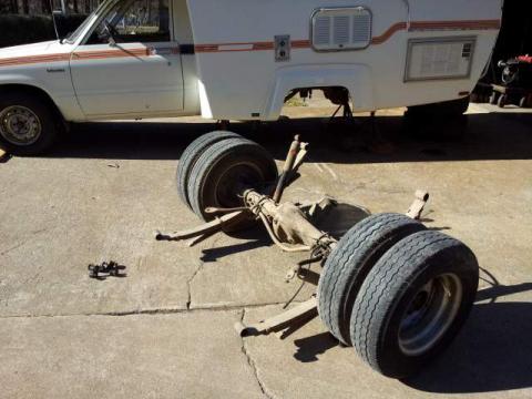

Cossacks Posted January 17, 2018 Posted January 17, 2018 think i got the pic sorted out. it showed up with one wheel missing. Quote
linda s Posted January 18, 2018 Posted January 18, 2018 I can see why you were so baffled at what you got. That is the strangest axle I have ever seen. Looks like the wheels are attached directly to the differential. At least tell us the name of the salvage yard so we can make sure no one of our members ever buys anything from them again. Linda S Quote
Cossacks Posted January 18, 2018 Posted January 18, 2018 Last one on Dereks list South Florida Auto wreckers guy name was John. Asked for 2wd and 4 rims. Got 3 and 19 lunches short. Told no refund. Should be on road tomarrow. The shop is doing all the mods that are needed. Regards Robert Quote
