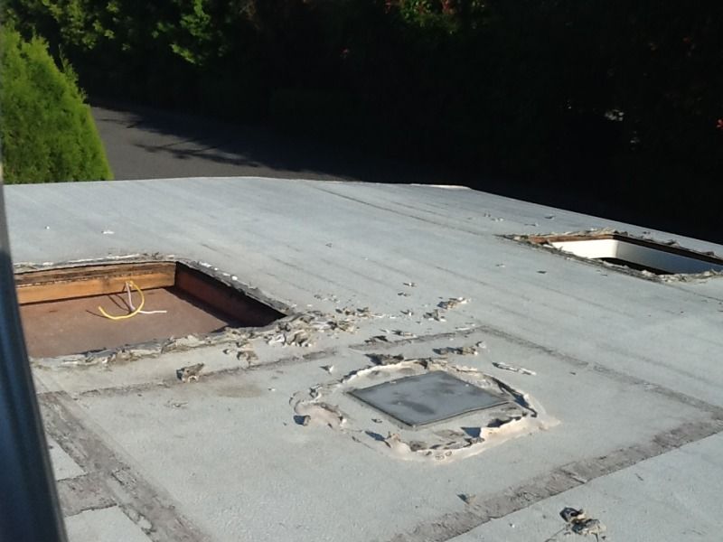

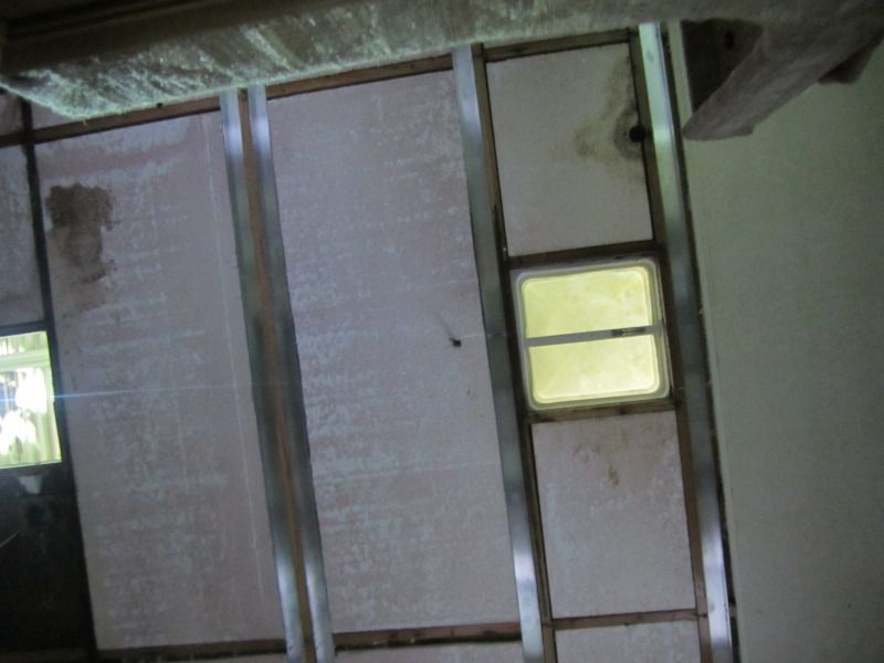

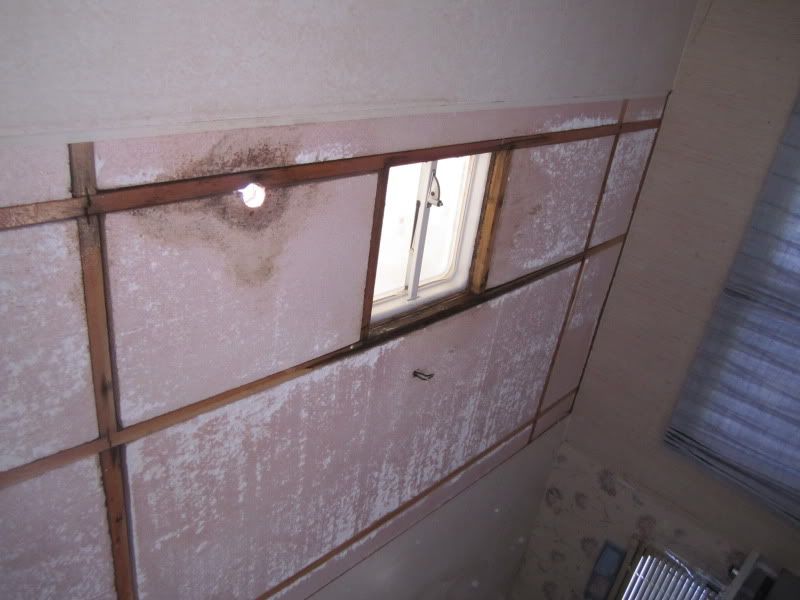

Bunneys Posted May 22, 2012 Posted May 22, 2012 Last year at our first ever Toy-in on Vancouver Island, it rained some... My wife noticed a small drip on her in the middle of the night... I noticed then that there was a fair sized lake on the roof... it was coming in through the TV antenna crank-up thing we never use. So I started to think about removing it and that is where it all started... What I know now... The roof is just 1"X 1" wood... Ya, that is it! a thin covering of aluminum on the top, some foam board (1/8 thick) 1X1 with 1" foam all glued and stapled together. (Under the AC unit there is 1" X1" metal) I had this idea if I just pushed up on the roof while it was stored, it might regain some of it's flatness... I think that made it worse I noticed my cabinets were starting to pull away for the side and that is when i thought I had better do something. I started by removing the cabinets, then the 1/8 paneling on the roof. That was very hard(glued in). The next steep was to cut out some 2" channels so i could screw some 1"X2" aluminum channel in there. With that in, it now is perfectly flat again. :-) I have decided to ditch the AC unit and install the Fantastic Fans... Also I am going to look for some other paneling for the roof. And the thin aluminum is too thin now, many small holes and some rips... I don't think I can take on the big project of removing and replacing it, but i need to seal it up. I'm thinking of using the roll-on bed-liner stuff... here are some pictures of the work so far... Quote
85mirage Posted May 24, 2012 Posted May 24, 2012 i too couldnt believe how thin the roof is. my shasta didnt even have metal for the ac and not nearly as many "sticks" in the rest. I had a couple 1x2 and 1x3 around ac and all were layed down not on edge thereby making them very easy to sag quite a shame! I would reccomend installing a rubber roof over your tin and bring it over the sides and screw in aluminum termination bar around perimeter. Alot easier install if you dont have any protrusions through the roof. Or remove most and the reinstall over new rubber. Fairly easy install. I install them on homes, good luck Quote

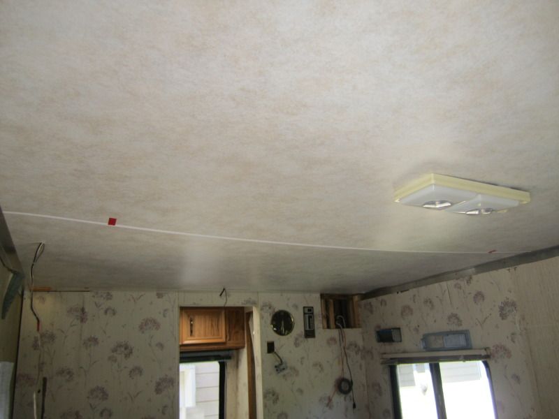

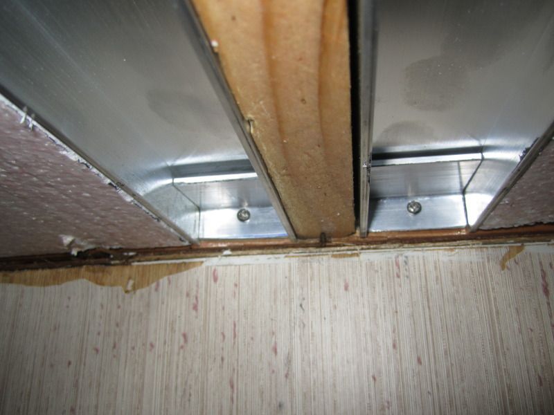

Bunneys Posted July 10, 2012 Author Posted July 10, 2012 Continuing on with the project... I was almost ready to put up the paneling, but thought twice about using the original metal 1"X1" that was used to support the weight of the A/C unit. (It was starting to rust) I thought about removing it and painting but since it would have to come out anyway best to replace it with the aluminum channel too! So that is all done now and the first ceiling panel is installed... (Not an easy one person job) I used Advanced Auto Parts to order the roll-on bed liner... Hopefully it will arrive this weekend and I can start coating the roof soon. Quote

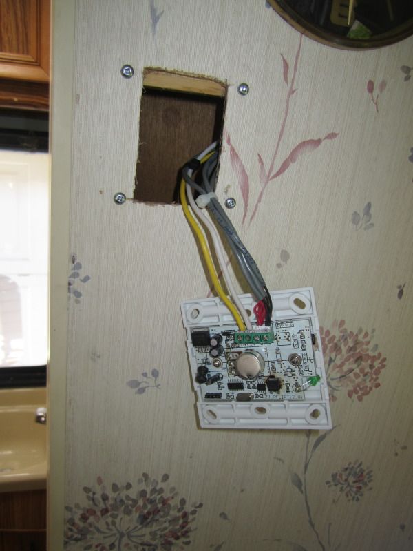

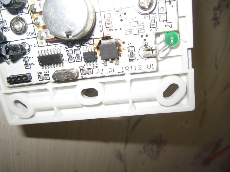

Bunneys Posted July 13, 2012 Author Posted July 13, 2012 The final panel is up! It is not glued like the original ones were and you can tell. I hope once i have the Vent trims on it will help suck them up a bit. I'm having a problem with my cheep ebay LED dimmer. It worked fine when i tested it out before, but now that it is all installed and all the wires are nicely cable-tied together in the ceiling it is either running too many lights (over powered) or there is a short somewhere... I have to do more investigation this weekend if I get the time. Quote

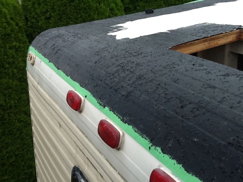

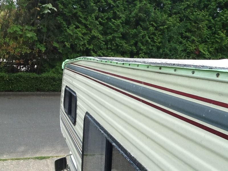

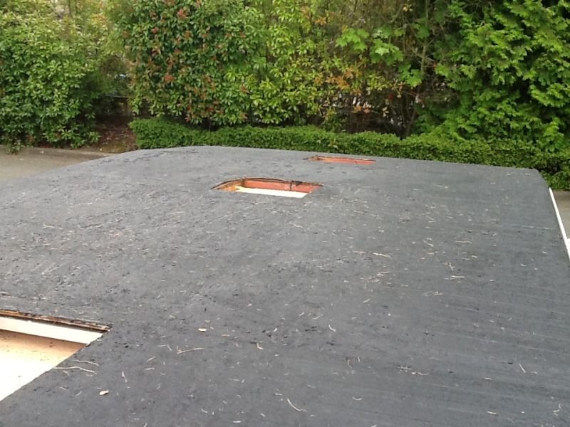

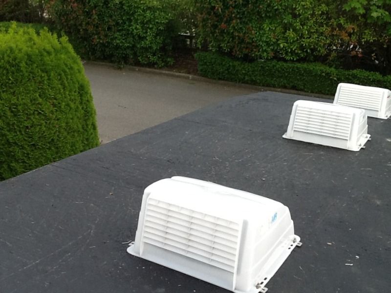

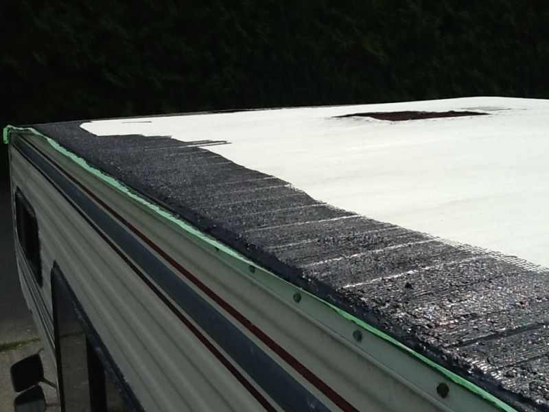

Bunneys Posted August 21, 2012 Author Posted August 21, 2012 Last week, everything went my way... The weather was nice and sunny, my wife took the kids to Birchbay for a week. It was finally time to try out the roll-on bed-liner. I was not too sure what the best way to do it would be, do it with the vents on or off... I finally decided to remove everything from the roof and cover it! The instructions say you must scruff-up the area first... that took the longest... I kept finding putty, silicone, old stickers to slowly scrape off... (and it was very hot on the roof too) That took me 3 days (working after my day job) Next I had to figure out where to start and stop... I decided to put the painters tape just above the marker-lights for the front and back. and use the screw trim channel thing for the sides... (That gave me a place to tuck the tape into so it would stay there too... ) I tried to find a large roller, but no one could find anything close to the small one that came with the kit... One guy tried to sell me a $20 stucco roller, but I'm much too cheap, so I did the entire roof with that little roller... (lucky, I could use the screw-on extension poll) I did try a regular paint roller, it does not work at all... I also stole one of my daughters small paint brushes, that worked great on the edges. "Painting" took me around 3 hours... I notice it took 3 days to harden. My wife took the camera, so i used the ipad thing to take some pictures... I have them, I'm just not sure how to get them off the thing onto photobucket...? I will post them up when i figure it out One can does one coat, after the vents are back on, I might do another coat... Quote
Bunneys Posted August 22, 2012 Author Posted August 22, 2012 Ok, here are some pictures... Lots of dried grass in this picture, I had to cover it one night, they said there was a chance of rain. Once everything is finally screwed on, I will do a 2nd full coat. then paint it to match the rest of the RV. A BIG Thank you pdqmovie for doing this first! Here is his post: http://toyotamotorho...?showtopic=1942 Quote

Bunneys Posted August 22, 2012 Author Posted August 22, 2012 That would be great! but that stuff only covers 32 sq.ft/ kit I would need around 4 kits !! This is the stuff i used Quote
Derek up North Posted August 22, 2012 Posted August 22, 2012 Does Dupli-Color say anything about accepting paint? Just came across this (biased?) comparison:- http://www.monstaliner.com/monstaliner_comparisons.htm Quote
Bunneys Posted August 22, 2012 Author Posted August 22, 2012 I will agree with what they say... When i first opened the can, there was one huge lump... It took me 1/2 hour to stir it together. The instructions say to stir it every 10 min. (I did, and had no problems) However, I would not like this product to be used on a fancy truck, it does not look constant. However, on the roof it is just perfect As for painting, they do talk about it a bit... It is generally not recommended because it is rubbery, but again, on my roof it will hopefully not get the same abuse as a truck bed... Perhaps they should call it RV roof coating and everybody will be happy I guess the bottom line, you get what you pay for.. Duplicolor Bed Armor is a new product made by Sherwin Williams. Bed Armor is a one component water base urethane that contains fine Kevlar particles which really does nothing to enhance durability but acts as a texturizing agent and an alternate to using crumb rubber. Bed Armor claims to be UV protected and we believe this is correct. We were not impressed at all with this product. Even with constant stirring, it was very difficult to keep the Kevlar material from clumping together resulting in a terrible and non-uniform texture. We were quite surprised with the poor results during testing and thought we had a bad can so we ordered another online instead of buying it locally. Same poor results! Shame on you Sherwin! This product is a disaster. Just look at the video on the Bed Armor web site and you can see that the texture obtained from rolling is terrible. They won't even show a close-up of the results in their own promotional video. Contains Bis(2-ethylhexyl) Phthalate, CAS # 117-81-7 which EPA has listed as a "probable human carcinogen" See here for the data http://www.epa.gov/IRIS/subst/0014.htm Bed Armor is available in quarts and 1 gallon kits with roller, tray, brush and scuff pad. Gal kits #BAK2010 @ $80.00 - $100.00. No pot life, 43% volume solids Quote
Derek up North Posted August 22, 2012 Posted August 22, 2012 Well, I sure hope you can get some white paint to stick, otherwise it's going to get awfully hot inside. Quote
90toydolphin Posted August 23, 2012 Posted August 23, 2012 i would think there would be an appropriate primer out there that would help with the sticking. maybe some industrial paint shop could help. then again any quality paint may stick fine. if hail is a regular occurance that may be hard on it, i don't live where it hails much so that wouldn't be something i'd worry about ). looks good and i think should work well too. Quote

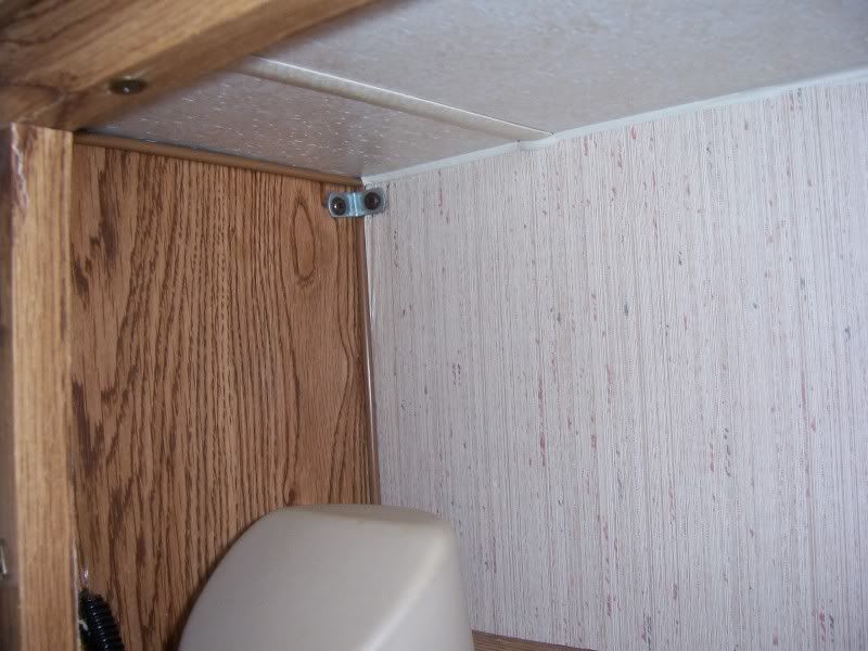

89slumberdude Posted October 9, 2012 Posted October 9, 2012 Very informative and most valuable to me as I have (guess what)?...The same leak from the same place (antenna crank handle)...I took it out and made an alum. plate (about 6" square) and siliconed it to outside of the alum. roof along with a 1/2" thick piece of plywood (as a spacer block) with the center 4" cut out to coil up that antenna cable inside & secured it to the alum roof panel with 8 stainless 1-3/4" metal screws...(see pics)...I did this in case I wanted to use it at a later date rather than just cut the cable off? ...Not a drop has come through since.. I also was curious as to where else it might get water in from so, I took the a/c inside cover off and noticed it was damp around the edges of the installation hole through the roof...I loosened the 4 long bolts,left them with just 4-5 threads still in the frame to help with re-alignment, went outside and pried the a/c unit upwards, (Took several ladder climbs to get it propped up), Wound up using 4- 2x4's x 3' stacked up on each other across the roof to hold/prop the unit high enough to get under it and cleaned off all the old seal... I then replaced it with an expandable gasket you cut to length... I bought at Home Depot...It comes on a roll and after you open the roll, it starts expanding...it is guaranteed to stop leaks as the amount you compress it increases..Great stuff as there is now no leak from the a/c unit either...I will now check the remaining vents for any leaks... Now for the biggy...My question to you is, how do the cabinets come off?... I'll be removing the ceiling sheets and see no screws or brackets holding them in place?...That idea of (sistering) the alum. bracing looks very professional and I had thought about it & as (you have found) the roof sag can't be resolved without the extra support these braces give...This will be my winter project so, maybe we can swap stories at the next Toyota M/home gathering?...Thanks for the great documentation and pics you provided...They will help me immensely along with the procedure for removing those cabinets...Cheers, thanks in advance...Barry... Quote

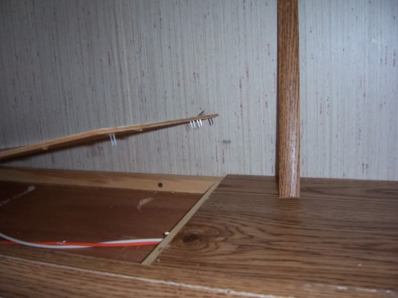

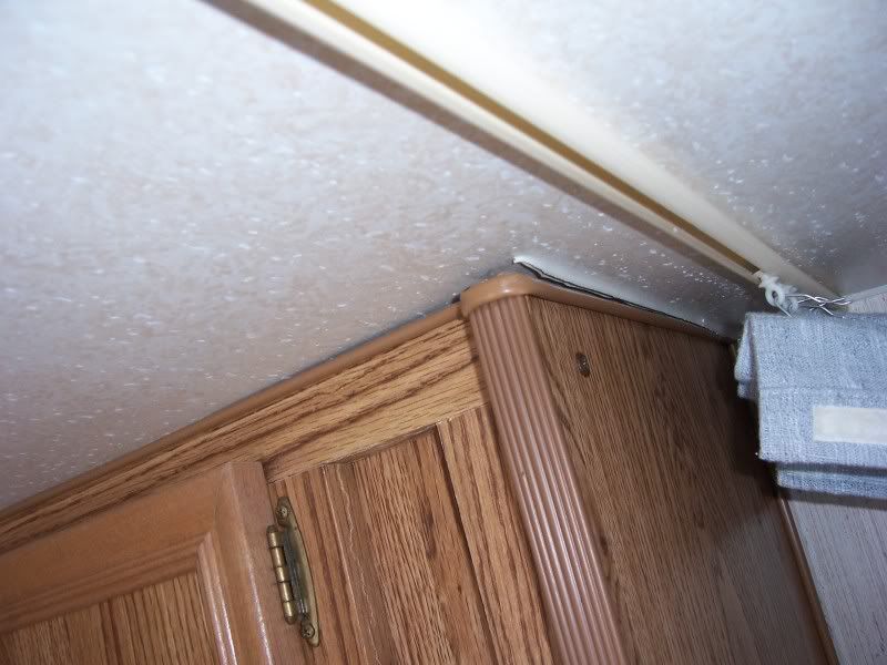

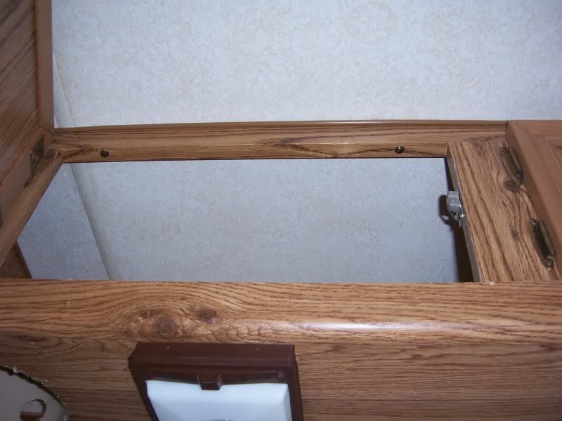

Bunneys Posted October 10, 2012 Author Posted October 10, 2012 Now for the biggy...My question to you is, how do the cabinets come off?... Barry, The cabinets on the Dolphin came out easily for me. They were just screwed in. Most of the screws are easy to see, but some were under the "floor" of the cabinet. The paneling for the ceiling was a bugger, it looks like the the entire roof was pre-made and then screw/stapled to the walls, so there is 1" on either side you would have to cut out. It was not easy, but I have to get at least 1/2 an inch of it out so i could slide in the new panel. Here are some pictures of the cabinets I have, hope it helps! If you would like to come and have a look at our 's feel free to send me a PM, it is still not 100% back together Nice Slumber Queen RV you have! I don't see many of those... Andrew. Quote
