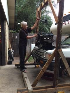

ednelson100 Posted April 7, 2017 Posted April 7, 2017 I am pulling my 3.0 VZE motor because of spun bearing and numerous other issues. Searching Craigs list there are so many good 3.4 5VZE's for sale, no 3.0 3VZE's in my area. My first choice is to replace with a 3.4. Yes, I see a lot on the internet about this with 4Runners, but has anyone actually done it themselves on a Toyota motor home? I think I am most worried about the wiring issues. I also see suggestions about Buick 3.8 for replacement. I am not really looking for more power, just reliability. I am not interested in a shop doing it. Any suggestions would be greatly appreciated. Ed Quote

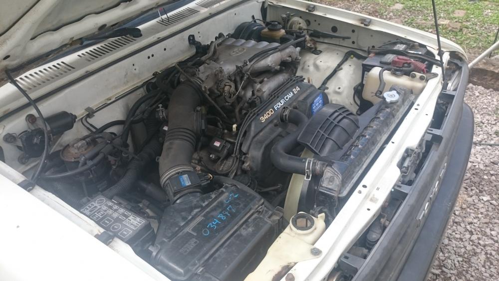

ednelson100 Posted May 5, 2017 Author Posted May 5, 2017 I found my donor vehicle on https://erepairables.com/ for around $1000. Just had to drive 600 miles to pick it up in Mobile AL. Luckily it appears well maintained and the damage was mostly to the driver side wheel-well/fender area and frame bent. 1997 T100 with158K miles It started right up after I removed the smashed up radiator. Compression is good on all cylinders. Will be lifting motor out this weekend. Quote
ednelson100 Posted May 5, 2017 Author Posted May 5, 2017 Let me try again to post the truck picture. Quote
