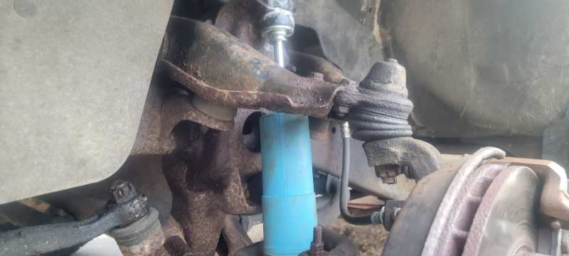

dragoman1993 Posted January 31 Author Share Posted January 31 OK, so I've put everything in, breakdown of what I had to do: The Ubolts were the wrong size, but luckily the ones that were on the RV didn't have to get cut off, so I reused them. The bushings were indeed the wrong ones AGAIN, I had actually purchased the wrong ones the first time, then had to return them and buy https://www.yotamasters.com/shop/suspension/maintenance-replacement/old-man-emu-leaf-spring-bushing-kits-2/, can't remember which one I bought, but that was also wrong, as I had to turn down with my lathe the larger OD of the bushings to fit the frame connection point. I also had to increase the ID of the supplied metal sleeve, as the ID wasn't large enough to fit over the bolt. I also had to trim the bushings to length, as when put on either side of where they belonged, they ended up not fitting where they were supposed to. The front and rear shocks went on without a hassle. Overall, pretty much all of my complaints of poor driving have been remedied by replacing front and rear shocks along with the rear springs. The bushings everywhere were shot, I am unsure if I actually needed to replace the rear springs, as the side by side comparison didn't reveal anything, and the truck is sitting roughly at the same height. The front and rear shock bushings looked basically brand new, I'm unsure if they had gas in them at one time, as when pushed in, they stay in position. They did resist movement however. I do still want to gain some clearance in the rear, any ideas on how to go about that? My departure angle is pretty abysmal at the moment. Attached some photos in case someone can spot anything out of place. Last picture is how she currently sits on level ground Quote Link to comment Share on other sites More sharing options...

dragoman1993 Posted February 1 Author Share Posted February 1 I forgot to take pics after putting in the new springs, Old Man Emu OMESB43 were the bushings I bought that needed to be turned down and cut to length. Here's a photo of the spring right before it went in. Quote Link to comment Share on other sites More sharing options...
linda s Posted February 1 Share Posted February 1 Those bushings don't come up for me. Looks like these would have been the correct bushings Old Man Emu by ARB, Spring Bushing Kit, OMESB6 - Desert Rat. Guess it doesn't matter now that you found a way. Like I said most of us have air suspension bags in the rear and we can easily adjust the height in the back 57113 Airlift Super Duty Air Spring Kit Toyota Motorhome - Shockwarehouse.com Longer shackles might have been an option but you just got the damn things in and I don't know if a suitable size is available. Most look pretty extreme In the front your limited to torsion bar adjustments Linda S Lots of cheaper options online for those air bags Quote Link to comment Share on other sites More sharing options...
