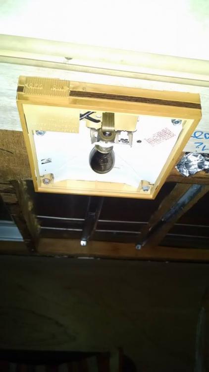

Gaelyn Posted November 16, 2017 Posted November 16, 2017 84 Dolphin, and no clue how to change the lightbulb on interior lights - the reflect-o-light 540. one burned out and someone loosened the bulb trying to get it out, so I dont want to break the first one I swap out. Quote
WME Posted November 17, 2017 Posted November 17, 2017 Needle nose pliers. Grab the base not the glass. Quote
markwilliam1 Posted November 17, 2017 Posted November 17, 2017 I have the same fixtures in Grannie. I made the mistake of replacing the original bulbs with leds. After one light was awhile I noticed a melting area on the cover. Turns out the led melted the light cover which is impossible to replace as they don’t make them anymore. I had to buy new light fixtures which aren’t as well made and don’t have the cool retro look! I put back the original type bulb in all my other reflect-o-lite fixtures. Live and learn. Quote
linda s Posted November 17, 2017 Posted November 17, 2017 Gently push the bulb in and turn is how to remove them. I replaced mine with leds and they are way cooler than original bulbs. New covers are available with slight modification Linda S Quote
