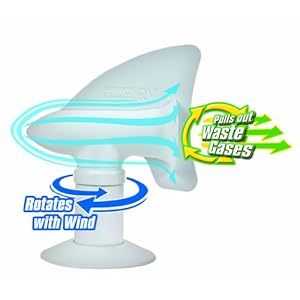

wistoy Posted June 10, 2011 Posted June 10, 2011 I had the same problem - fix was to install "weather vain" type vent cover on both the black and gray tanks, this cover spins facing down wind. No more smells driving or parked, I do keep the bath ceiling vent closed as the vent is very close to the black tank $14.95 at our local Fleet Farm Store - up to $29.95 on the net. Dale PS: I also found a loose conection on the vent stack where it comes down in the closet, Where the pipe makes a right angel to the stool and holding tank Quote

Maineah Posted June 10, 2011 Posted June 10, 2011 I could not agree more with the weather vane gadget they work great makes all the difference in the world works like a venturi and pulls air like mad up the stink pipe at highway speeds and they even work well in a light breeze. Quote

waiter Posted June 13, 2011 Author Posted June 13, 2011 I looked at the stand pipe at the top of the MH today. The way its mounted, on the back curved portion, it acts like an air scoop when traveling down the hiway, and actually pressurize the tank. Its real obvious now that I know what I'm looking at!!! (I'll post a couple photos tomorrow) I ordered one of those weathervaine things from Amazon, I think it was about $15. John Mc 88 Dolphin 4 Auto Quote
darrel Posted June 13, 2011 Posted June 13, 2011 I also have had this problem on occasion. The fix for me was pore water into the shower drain until I here it draining into the black water tank. We do not use the shower except for storage therefor after some period of time the p-trap dries out and poop tank fumes travel upward. Actually the smell is worse than that. Hope this helps someone. Darrel Quote
Bunneys Posted June 13, 2011 Posted June 13, 2011 I ordered one of those weathervaine things from Amazon, I think it was about $15. John, can you post a link to that... Thanks! Andrew. Quote
waiter Posted June 13, 2011 Author Posted June 13, 2011 Camco 40595 RV Cyclone Sewer Plumbing Vent http://www.amazon.com/Camco-40595-Cyclone-Sewer-Plumbing/dp/B003P64XU4/ref=dp_cp_ob_auto_title_0 John Mc 88 Dolphin 4 Auto Quote
