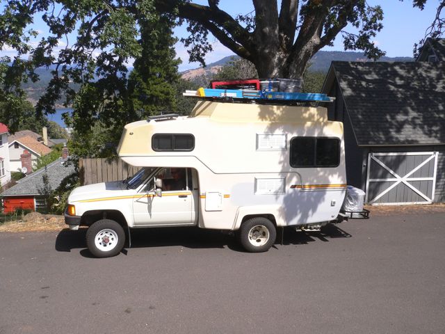

cascadecrud Posted March 3, 2012 Posted March 3, 2012 (edited) Totally stripped down and rebuilt--a 2 year project. New higher roof (I can stand upright!), new windows, glassed-in front windows, new appliances, under the bench AC, solar, cassette toilet... Thought you might enjoy a few pics of "Pokey." 3 after the rebuild and one from before. Edited March 3, 2012 by cascadecrud Quote
bajadulce Posted March 3, 2012 Posted March 3, 2012 Looks great. Paint job and colors are really clean. You did a nice professional job covering up those windows too. For sale? Quote
mission mike Posted March 3, 2012 Posted March 3, 2012 Hi Cascade A very nice job you have made of the rebuild, do you have any inside photos to post? in the before photo is that Mount Adams in the back ground? also looks like the Columbia River Gorge in a couple of the other pics?? thanks for sharing Mike Quote
Dolphinite no longer here Posted March 4, 2012 Posted March 4, 2012 Wonderful work! Looks better than new! Anymore pics? Inside? John Quote
Galvanized Knight Posted March 4, 2012 Posted March 4, 2012 Very fine looking machine. I love the colour you picked. I agree with everyone else ...More pictures! exterior and interior. Thanks for posting GK Quote
