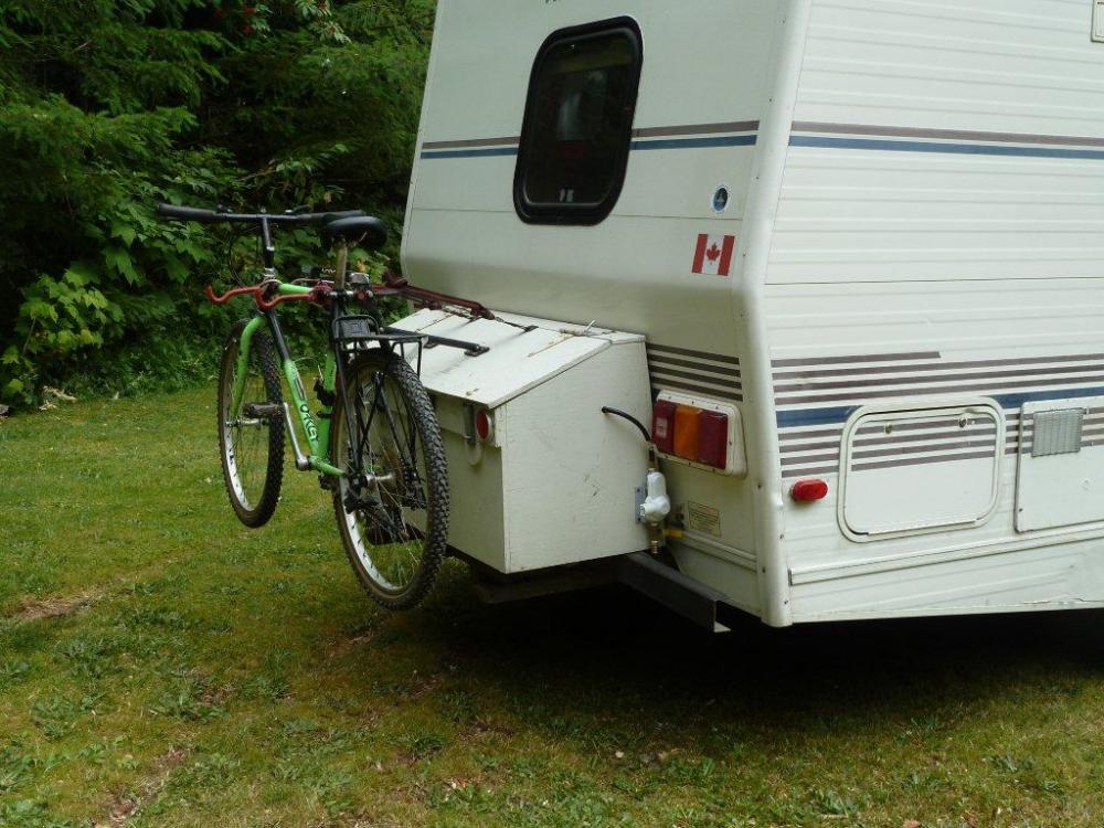

  11. I made a cargo box for our mohome when we bought it about 10 years ago and it has served well, basically a plywood box with a sloped hinged lid, in there we have a spare gas 2gal jerry can, a BBQ tank, a couple of chairs, campstove and other odds and sods for camping, also quite often have a couple of bikes hanging off the back. Mike
