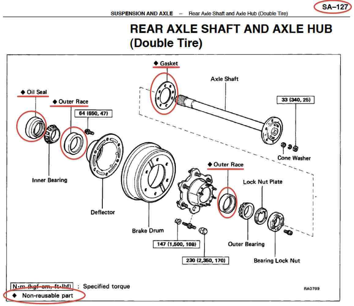

waiter Posted July 6, 2013 Posted July 6, 2013 Brake pads can absorb water and become brittle. He will need to take the rear axle apart to check the rear brakes. Just make sure he is aware that the rear axle bearings are packed. He may want to install new seals, they are cheap.John Mc 88 Dolphin 4 Auto Quote
Stevo Posted July 7, 2013 Author Posted July 7, 2013 EDITED 1) Can a mechanic tell if the brakes have absorbed water or are brittle by just looking at them? 2) Can I buy new axle seals and gaskets for this from O'Reillys, Pep Boys or Napa, or are they only available from Toyota? 3) According to the axle overhaul PDF the Oil Seal and Gasket are considered "non-reusable parts" (see screen capture below). Is there one gasket and one oil seal for each side so there would be 2 Oil Seals and 2 Gaskets needed? Quote
zero Posted July 7, 2013 Posted July 7, 2013 EDITED 1) Can a mechanic tell if the brakes have absorbed water or are brittle by just looking at them? 2) Can I buy new axle seals and gaskets for this from O'Reillys, Pep Boys or Napa, or are they only available from Toyota? 3) According to the axle overhaul PDF the Oil Seal and Gasket are considered "non-reusable parts" (see screen capture below). Is there one gasket and one oil seal for each side so there would be 2 Oil Seals and 2 Gaskets needed? axle1.jpg Brakes aborbing moisture is not a concern. Heck - you could drive through a mud puddle - or launch a boat and get them water-soaked. Using them heats them up fast and dries them. The result of long-term moisture creating rust and stuck parts is the concern. If the vehicle has been driven on road salt - and/or has been in storage parked outside on damp ground -then you might have issues. And yes - they will be easy to detect. All the seals are available from any auto parts seller and often they will come from the same company that makes them for Toyota. You don't need gaskets on the sides but they are available if you want them. Seals are reusuable if you're careful - but why would you want to? Seals are cheap. There are two seals per side. A small stationary axle seal and a larger rotating hub seal. I just bought some from Timken and they were made in Japan by the same company that Toyota gets them from. Quote
