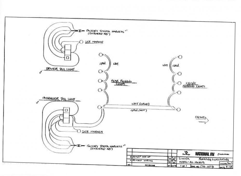

chulho Posted January 22, 2016 Posted January 22, 2016 hi there, i purchased and received your aluminum taillight plates on ebay and they look great! i also got the lights and connectors from superbrightled. i'm a total beginner re: electical systems, and trying to use original wiring to figure out how to install the new led tail-light system. but i'm having trouble determining what goes where... the new led light connectors have red+black+white, and i understand that the black is "dim" and red is "bright". white = negative/ground? attached is photo of "original" wiring. my understanding is that "orange"wire on the left and "black" wire provides power, as i can make signals/brake/reverse work with new LED system, but my parking light (dim) stopped working on the old lights, and i can't seem to get it to work with the new lights either (it could be another problem or i'm just not wiring the new lights properly). any help would be appreciated~ -chulho Quote
bwolfgti Posted January 22, 2016 Author Posted January 22, 2016 hi there, i purchased and received your aluminum taillight plates on ebay and they look great! i also got the lights and connectors from superbrightled. i'm a total beginner re: electical systems, and trying to use original wiring to figure out how to install the new led tail-light system. but i'm having trouble determining what goes where... the new led light connectors have red+black+white, and i understand that the black is "dim" and red is "bright". white = negative/ground? attached is photo of "original" wiring. my understanding is that "orange"wire on the left and "black" wire provides power, as i can make signals/brake/reverse work with new LED system, but my parking light (dim) stopped working on the old lights, and i can't seem to get it to work with the new lights either (it could be another problem or i'm just not wiring the new lights properly). any help would be appreciated~ -chulho If the parking lights didn't work before and aren't working now, i would guess it is a wiring issue somewhere or a blown fuse possibly. Have you checked the fuses? Quote
