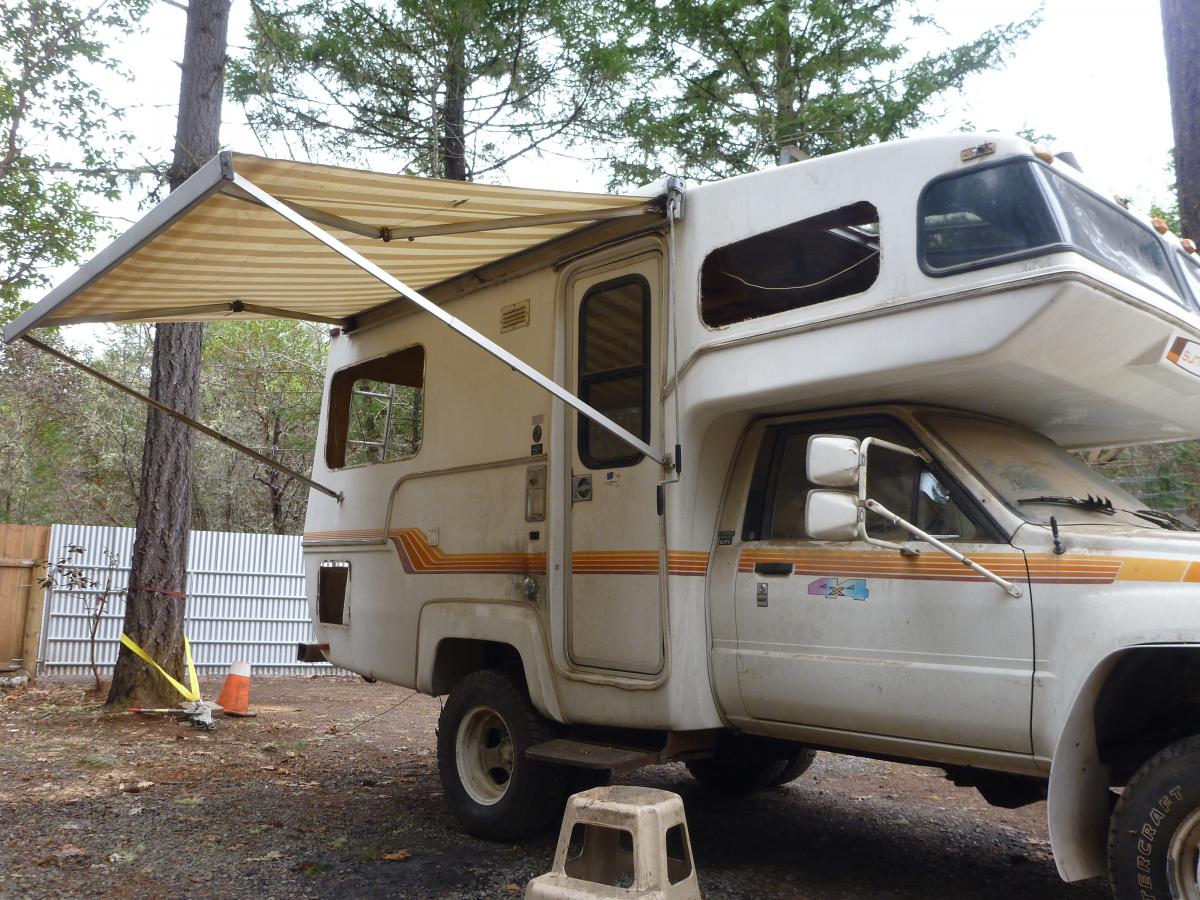

85Diesel Posted May 12, 2014 Posted May 12, 2014 Here's the awning on my Sunrader. I'm thinking I'll really appreciate it when it's raining out and I can step outside without suiting up. Quote
Debbit Posted May 12, 2014 Author Posted May 12, 2014 That looks nice! I can see how it would attach. Thanks! Quote
