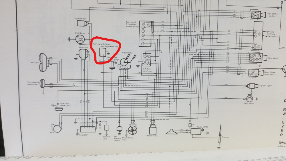

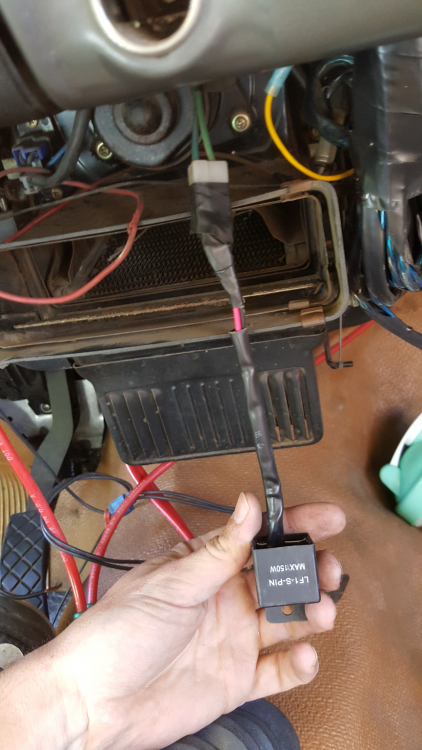

gmg Posted October 15, 2018 Posted October 15, 2018 (edited) On 10/13/2018 at 5:33 PM, fred heath said: Sorry, but there is no exclusive plug and play “ blinker relay” on my 1979 (transion year 1978) Toyota Hilux pickup chassis. Post a picture of your “independent relay” and I’ll be happy to concede to your post. Does your truck have 2 headlights or 4? It has 4 headlights and the vents on the B pillar. Most definitely gen 2 hilux (AGAIN, same as the OP). I decided to pull out my manual and show you the wiring diagram. Circled in red is the "Turn signal & hazard warning flasher unit". Note the two wires coming from it that go to both the "hazard warning light switch" and the "side turn signal relay". The "Turn signal & hazard warning flasher unit" is what needs to be replaced for LEDs to function correctly. The first picture shows the exact relay linked above installed in my 1978 GEN 2 hilux. Note, it is going into the STOCK connector. It is in fact as simple as that and as close to plug and play as you can get when retrofitting something on an old rig. Edited October 15, 2018 by gmg Quote

fred heath Posted October 15, 2018 Posted October 15, 2018 (edited) 2 hours ago, gmg said: It has 4 headlights and the vents on the B pillar. Most definitely gen 2 hilux (AGAIN, same as the OP). I decided to pull out my manual and show you the wiring diagram. Circled in red is the "Turn signal & hazard warning flasher unit". Note the two wires coming from it that go to both the "hazard warning light switch" and the "side turn signal relay". The "Turn signal & hazard warning flasher unit" is what needs to be replaced for LEDs to function correctly. The first picture shows the exact relay linked above installed in my 1978 GEN 2 hilux. Note, it is going into the STOCK connector. It is in fact as simple as that and as close to plug and play as you can get when retrofitting something on an old rig. Well it might work on your truck but it’s an aftermarket (homemade) connector. This is the correct flasher assembly for this truck. So unless the OP wants to try their luck at fabrication, I still stand by my post. So it’s not like later style flashers where you can buy a relay, unplug the old and plug in the new. I’m sure the OP’s unit looks like mine, not like yours.? Edited October 15, 2018 by fred heath Quote

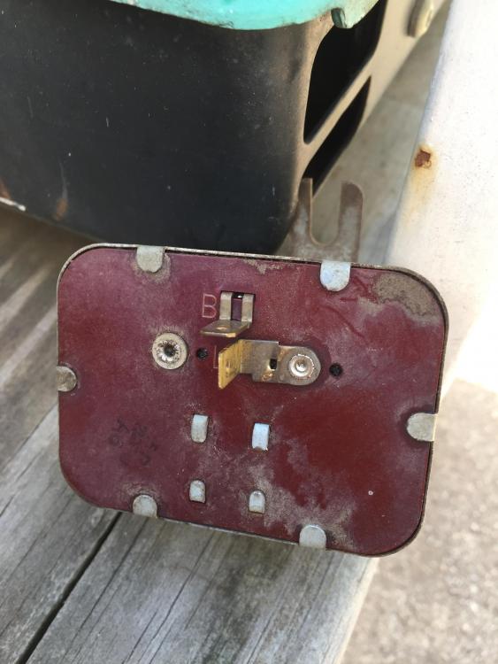

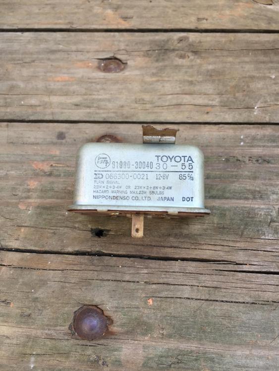

gmg Posted October 16, 2018 Posted October 16, 2018 8 hours ago, fred heath said: Well it might work on your truck but it’s an aftermarket (homemade) connector. This is the correct flasher assembly for this truck. So unless the OP wants to try their luck at fabrication, I still stand by my post. So it’s not like later style flashers where you can buy a relay, unplug the old and plug in the new. I’m sure the OP’s unit looks like mine, not like yours.? Fred, I do not have the time or energy to go back and forth with someone who can not admit they are wrong but I will do it anyways to save the OP from a headache. The picture you posted is a 2 pin flasher that has the same connector orientation as my stock plug that the new relay shown above is going into. In addition, i backed up my claims with a wiring diagram and pictures that you asked for. Not once have you offered any legitimate solution for the OP. I know it may seem like I am inexperienced with so few posts but posts don't equate knowledge. Over the last 8 months I did a shell off complete restoration of my 79 sunrader and swapped a vw tdi engine into it. That included making a standalone engine wiring harness that required tracing, cutting and soldering 100s of wires. So I know my way around a wiring diagram and definitely know this vehicle inside and out. To the OP, if you do want to keep the LED blinkers, I guarantee you that my solution will work. I will even put my money where my mouth is. If it doesn't work I will send you the $10 that the relay costs. That is how confident I am. Please post back and let us know how it goes. Quote

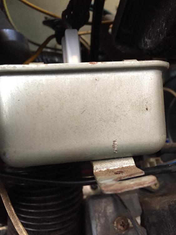

5Toyota Posted October 16, 2018 Posted October 16, 2018 as far as the plug in goes the original flasher in the picture is the same plug as a 2 wire or can even use a low or high low sealed beam plug in I have done this .and yes that is the factory Toyota unit . Quote
fred heath Posted October 16, 2018 Posted October 16, 2018 (edited) I never said it couldn’t be done. I took exception the ease it could be done. The OP is having flasher troubles while using LED bulbs. Maybe it’s the bulbs, maybe it’s the flasher relay who knows. It’s smarter to go back to square one and see what happens with standard incandescent bulbs. If everything works as it should you can now start modifying things. It’s easy for someone who has electro/mechanical skills to modify the harness or fabricate a patch harness. Not so easy for someone who doesn’t. Don’t throw money at a problem hoping it will go away. Keeping in mind the factory relay requires it to be grounded to the chassis. You add a simple two pin relay (usually plastic) without the ground, the system won’t work correctly. I did go back and read my original response. I guess I could have worded it better. Toyota designed the turn/hazard and flasher unit to work in tandem with the original bulbs. Each component is matched to the other. That was the point I was trying to make. @GMG. I really don’t care what you’ve done to your truck. And the blade configuration is different on the Toyota wiring harness. Why don’t you remove the electrical tape covering your harness plug. Bet we’ll see a couple of 1/4” spade terminals there. I’ve done a lot of work on my truck also. I never claimed to be an expert. When it comes to the Toyota wiring harness I have much experience as I had to undo 40 years worth of PO modifications. Edited October 16, 2018 by fred heath Quote
