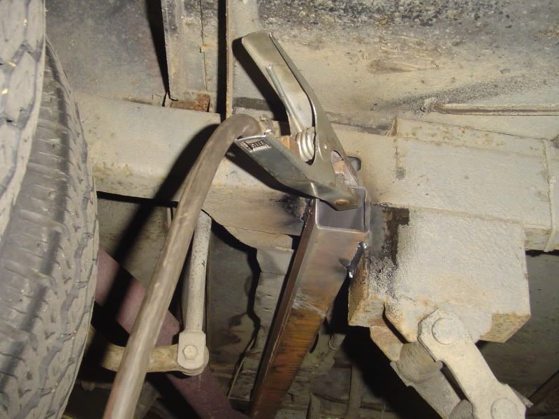

looked under dolphin i just purchased noticed it had air bags at one time! noticed that at rear of spring looked as if someone had welded blocks to frame and then mounted the spring attachment bracket! is this normal or did they do this to raise rear of rv to get away from airbags? if so how safe is this setup? thanks

Hard to say. Any chance of a picture?

Air bags were standard equipment on all Dolphins. Sounds like they failed and some previous owner did some alterations to make up for it instead of replacing them.

Sorry to hear about the crash... I think the spring block is from the rv factory, I have it on mine, here is a picture I took when I was doing some welding work for my hitch...
Posted Image
Hope everything works out good for you.

thanks bunneys. thats what it looks like! now i know its factory and not something else! sure is great to have so many people who know so much about these motorhomes! now just have to figure out how to get some better rear brakes! does your rear brakes seem to work ok? have to try to adjust mine after reading about valve in the rear! thanks agin Rick
