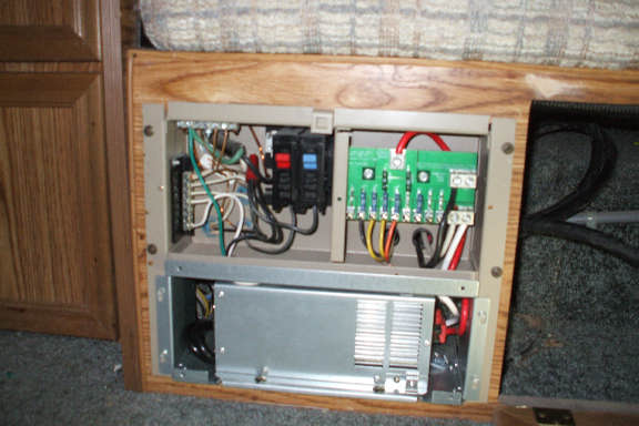

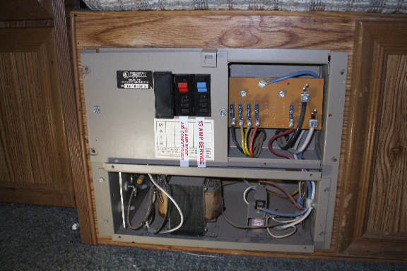

waiter Posted January 17, 2011 Posted January 17, 2011 Upgraded the original Equipment Converter to a new technology power supply. The original unit has a history of cooking batteries and only puts out 25 amp. The new WFCO 9855 has a three stage charging system so it can do a trickle charge all the way up to a 55 amp charge. You can read about it here. http://www.bestconve...t-Kit_p_47.html The upgrade went almost exactly as the instructions said. I say "almost". In my particular unit, there is a 45 amp fuse in the 12 volt line, I had to reposition this fuse and drill some new mount holes. Other that that, perfect. These are the Instructions for doing the upgrade: http://www.bestconve...FCO_ep_8-1.html NOTE - I also added additional Circuit breakers and a MAIN circuit breaker. (not shown in these photos) - Scroll down to see how I did this. BEFORE CONVERSION AFTER CONVERSION REPOSITIONED FUSE Quote

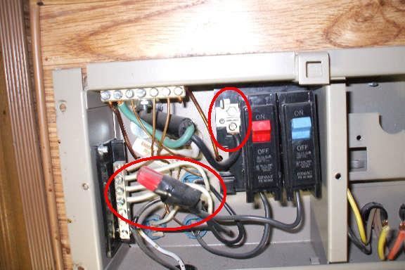

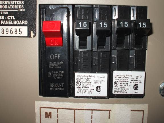

waiter Posted January 24, 2011 Author Posted January 24, 2011 Two additional items you may want to consider when upgrading your converter; Adding an Shore Power Circuit breaker, and putting the 120 Vac circuit on their own breaker. This Mod will cost between $6 and $20 depending how much the circuit breakers cost 2 each - Double 15 amp - $3.00 at Menards. You want the Seimens or Cutler Hammer compatible breakers) I reused the original RED 20 Amp breaker as the "MAIN" 20 amp breaker, and separated the loads that were feed by the Blue breaker and put them on their own 15 amp breakers. This way, I can turn off the different circuits individually if there are any problems. Remember , The breakers are not there to protect the load, the breakers are there to protect the wiring in case the load become defective. WARNING *** UNPLUG AC POWER BEFORE ATTEMPTING TO DO THIS *** This is a photo of the original Converter with circuit breakers; 1) The Shore Power input line (AC Cord) is not fused or protected. It goes to a terminal that feeds the Circuit Breaker backplane. (top middle) 2) All the 120vac outlets, including the 12 volt converter are all tied together with a red wire nut. (left side) and protected by the Blue Circuit Breaker (15 amps). 3) The Red circuit breaker (20 amp) is for the Air Conditioner (I don't have one, I have an exhaust fan) Remove the two breakers (The top pops out, then a slight lift to unhook them form the backplane) Remove the wires from the bottom of the breakers. Remove the Shore Power wire from the lug, then remove the lug from the circuit breaker backplane (3/8 socket). If you don't remove this lug, you can't add the third breaker. You can buy double breakers, I used 15 amps as I don't have an Air conditioner. I removed the wires from the red wire nut and put each load on its own 15 amp breaker. This allows me to turn off individual loads in the event of problems. Install the two double 15s where the Red and Blue used to be, then install the Red on the left position. (Hook the bottom of the breaker onto the backplane, then push in at the top) Connect the Shore Power wire to the bottom of the RED 20 amp breaker. This breaker will become your Shore Power MAIN input breaker. NOTE - The photo on the left shows a 30 amp MAIN breaker, I changed this back to re-used the RED 20 amp breaker as the MAIN. MAIN 20 amp RED #1 15 amp - 12 Volt Power Converter #2 15 amp - Air Conditioner #3 15 amp - Outlets right side (including Frig) #4 15 amp - Outlets Kitchen and Sofa Since I had the sofa removed, I took a photo of the back of the converter Quote
