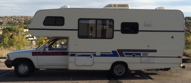

DanRT66 Posted July 20, 2015 Posted July 20, 2015 I don't know if it worked me over more than I worked it over, but I'm close to ready to head out for a nice adventure. New Bilsteins, LoadLifter 5000 air bags, leaf springs re-arched and a helper added, new brakes all around, new rear drums, all fluids updated with Teflon stuff, tune-up, alignment. Interior has new Allure vinyl floors, new upholstery, window coverings, new countertops, new cabover surface, front windows and roof molding re-sealed, 100 watt solar panel, two 6-volt and one 12-volt deep cycle batteries, MPPT controller and 1500 watt inverter. New shower, toilet, bathroom sink. I am tired and poor, but eager to hit the road. Thanks to the members of this forum for helpful tips and information! Quote

DanRT66 Posted July 30, 2015 Author Posted July 30, 2015 It's very good! When I bought it and drove it home to ABQ from Colorado Springs, it was wallowing around like a drunk hippo (I guess, never having actually seen one) and with all the new work and adjustments, it's capable of going places I'd not have tried before. No bottoming out on driveways so far. I'd say it was raised about 6 to 7 inches in the rear and maybe 4 - 5 up front. I had to go buy a folding step to get in and out comfortably. And the stability on the road and in crosswinds - just no comparison to how it was before. Quote
defrag4 Posted July 31, 2015 Posted July 31, 2015 It's very good! When I bought it and drove it home to ABQ from Colorado Springs, it was wallowing around like a drunk hippo (I guess, never having actually seen one) and with all the new work and adjustments, it's capable of going places I'd not have tried before. No bottoming out on driveways so far. I'd say it was raised about 6 to 7 inches in the rear and maybe 4 - 5 up front. I had to go buy a folding step to get in and out comfortably. And the stability on the road and in crosswinds - just no comparison to how it was before. :cool: would love to see some pictures of how it is sitting if you have the time Quote
DanRT66 Posted July 31, 2015 Author Posted July 31, 2015 Ah well - apparently, the radiator shroud was broken earlier and repaired - with electrical tape, which is typical of their work - by a former owner. I didn't see that, the mechanics who went through the engine in February didn't see it. Yesterday, going up a hill on I-80 30 miles west of Laramie, it came loose. The shroud flexed into the (plastic) fan, which shattered, tried to come out through the hood, and trashed the radiator. I am becalmed for likely almost a week. But eventually I'll post before/after of the way it's sitting. Quote

DanRT66 Posted August 6, 2015 Author Posted August 6, 2015 hows your ground clearance now with the airbags, springs, and helpers? Before/after ride height Quote

jjrbus Posted August 11, 2015 Posted August 11, 2015 That is an impressive difference in ride height. Hope it rides and handles better. Communications between road service and there contractors is very poor. The one time I used it they sent the service to the wrong location. Would simplify things greatly if they allowed us to talk to them! Jim SW FL Quote
DanRT66 Posted August 11, 2015 Author Posted August 11, 2015 Jim, when I drove it home from Colorado Springs it wallowed around a fair bit, but now it's pretty tight, and with the new airbags, not bad in crosswinds either. Good ground clearance, too. I have GPS so was able to send the tow company exact coordinates when I stopped, but the driver had a challenge hooking up something as small as this. Breezy ride back to town at 80 in that huge rig; felt like there was nothing back there. Now I'm on the road, I'm finding the Toyota very comfortable (for one person) and easy to live in. Quote

DanRT66 Posted September 1, 2015 Author Posted September 1, 2015 Thanks! I didn't raise it intentionally. The frame and suspension shop that installed the Bilsteins for me adjusted the torsion bars and performed an alignment, all of which had the effect of raising the front maybe a couple inches. Overall, very happy with the ground clearance and the ride, now. The frame shop also rather bungled the installation of new LoadLifter 5000 air bags - the right one was losing ten pounds a day, and they told me, "oh, that's normal". Puh-leez. I took it back, they said they fixed it, and nothing changed. Finally took it to a great shop 1100 miles away, D&D Auto in Ennis, Montana, and they had the fitting changed and the leak put right in the time it took me to do laundry down the street. Makes a huge difference in crosswinds and on curves and crappy roads. Quote
