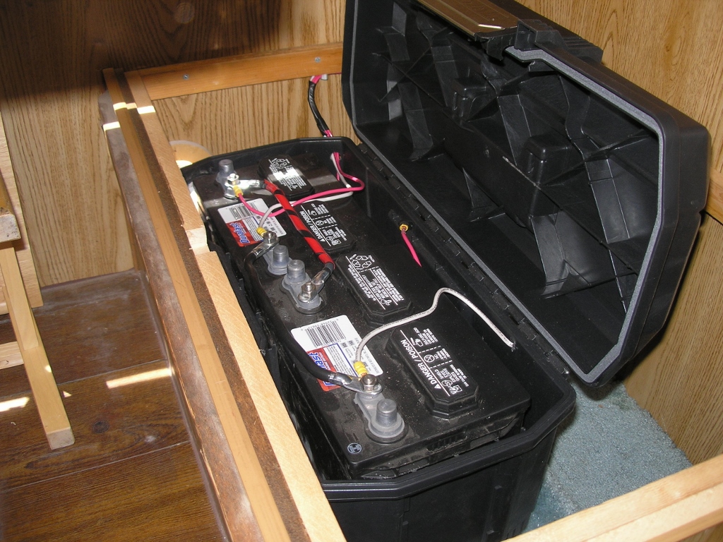

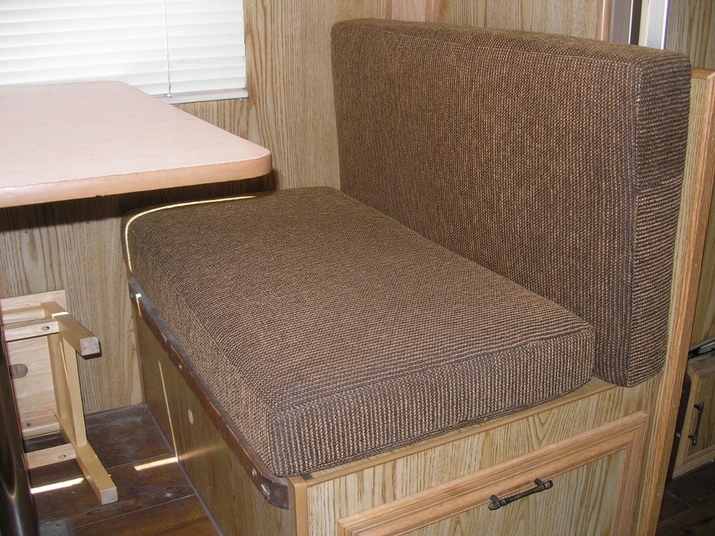

kgibson4 Posted April 23, 2015 Posted April 23, 2015 When I put the solar panels on our '87 Odyssey, I needed space for two batteries and the existing battery compartment only had room for one. I utilized part of the storage space under one of the dinette seats. The tool box was $20 from Home Depot, (much less than battery boxes that I could find on line) and sits on the wheel well. Our local RV supply (Roadrunner) had the vent kit for about $8, if I remember correctly. The location is closer to the solar panels and controller than the existing compartment. Quote
zero Posted April 23, 2015 Posted April 23, 2015 My plan is to install two 6 volt car batteries once the job is done. Any recommendations as to where to place the batteries? Dale Why two car batteries?? Seems that kind of defeats the possible benefits that you could get having two deep-cycle 6 volt batteries in series provides. "Car" batteries won't be deep-cycle and not suited for "house" batteries. In regard to placement - keep in mind that two 6 volt batteries hooked in series to make 12 volts - need to be pretty close together unless you use some very big cable to connect them. Two 12 volt batteries in parallel don't have that problem. Quote

kgibson4 Posted April 24, 2015 Posted April 24, 2015 I think Maineah may have thought the pictures of my battery setup were from the original poster. Quote
1988dolphin Posted April 25, 2015 Author Posted April 25, 2015 The converter arrived today. It had instructions for a converter from a different manufacturer. No help but still was pretty simple. Took maybe 3 hours. I meant to say that I am going to use golf cart batteries. I would love Trojans but can not justify the expense right now. Will get two GC2-RD batteries at Costco at $85 each. I have the same tool box from Home Depot so I think I will use that. I have no room inside the camper so I think I may build in a compartment in the bottom of the closet and vent it to the exterior of the damper.Thanks. Quote
Maineah Posted April 25, 2015 Posted April 25, 2015 I think Maineah may have thought the pictures of my battery setup were from the original poster. I did sorry but I like your install good job. The poster stated . . "My plan is to install two 6 volt car batteries once the job is done." So I am taking him for his word, i.e. car batteries. Also note there are plenty of batteries on the market with "bolts" instead of posts that are not deep-cycle. That even includes those el-cheap lawn-tractor batteries. True but lawn tractor all use bolt on terminals car batteries don't have bolts and deep cycles usually have both. Quote

DanRT66 Posted May 3, 2015 Posted May 3, 2015 I think Maineah may have thought the pictures of my battery setup were from the original poster. This setup looks great, and I'm contemplating something very similar. I've got a 100W solar panel currently charging the single 12v deep cycle house battery; I want to change that out for 2 6v deep cycle and add a 1500 watt inverter. In looking at your setup: are the smaller red and white wires (not tape-wrapped) from the converter or a solar controller, or? Obviously, newbie at this. Thanks. Quote
kgibson4 Posted May 4, 2015 Posted May 4, 2015 Everyone starts out as a newbie. I'm still waiting to graduate to something else. The white and red wires on the far battery go to the solar charge controller. The white wire on the near battery is grounded to the vehicle frame. The remaining red wire goes to the vehicle alternator charging system but is disconnected. Our two 100 watt panels are more than enough to keep ahead of our 12 volt evaporative cooler which is our biggest power draw. We don't watch TV when camping or use a microwave either so we don't have normal power needs. I believe if you are going to use an inverter it should be wired directly to the batteries with much heavier wire than that used for the charging systems. Quote
