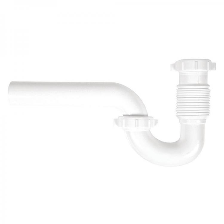

For the trap situation, I bought a flexible trap from home depot that is similar to a bendy straw.
d412099a-30ba-41fd-a4b4-402c8962b256_1000.thumb.jpg.06522eea4400931e4b53523677c4c08f.jpg
This worked, but I don't love it since it's not a thick walled black tubular pipe -- but at least the sewer gas issue is solved for now.  I'll post back if this quick/cheapo solution fails me.

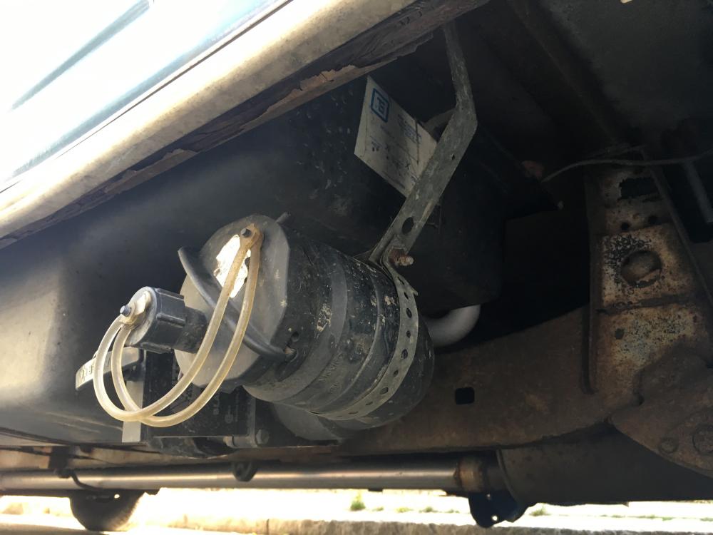

Elsewhere, there are some cheap modifications/fixes, but still not sure if the current tank is original.  Maybe these pics will help determine.
1986 21RD sun-land express waste tank
This is the only outlet of the tank that I see.

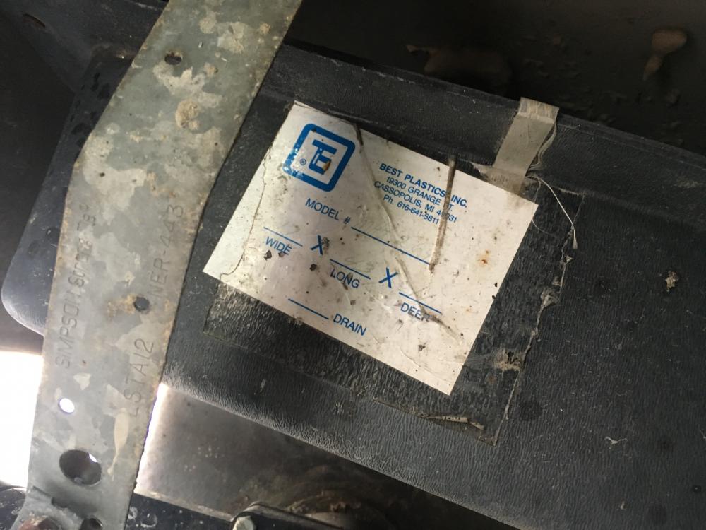

name plate
According to this nameplate it looks like it is 14"x43"x11" or about 30 gallons.  Was Best Plastics ever an OEM supplier?

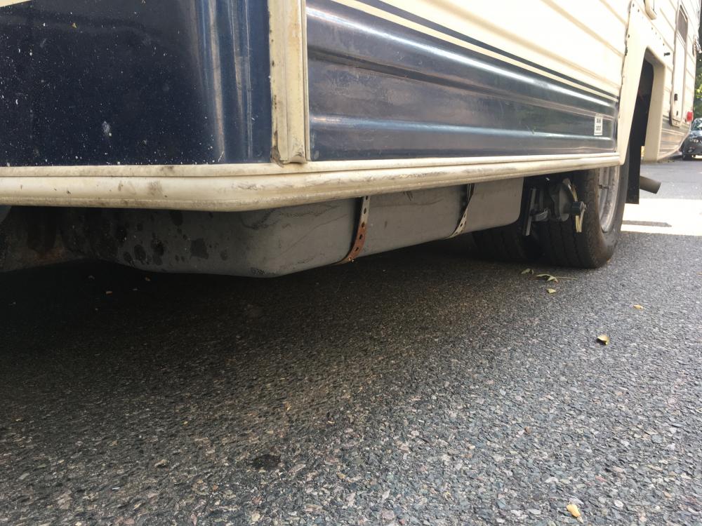

tank hanging don
I'm mindful about driver's-side curbs with how low it hangs.  Other than the height, it seems to fit very nicely.

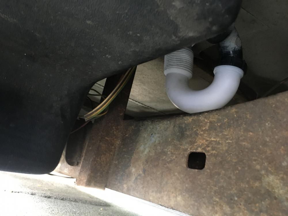

Not a great view, but this is where the shower drain is piped into the tank with the cheapo trap that replaced the leaking one.  There certainly is room for a bypass, and valve, but reaching it requires me to get over my claustrophobia and willingness to get dirty after a shower, which kinda defeats the purpose.

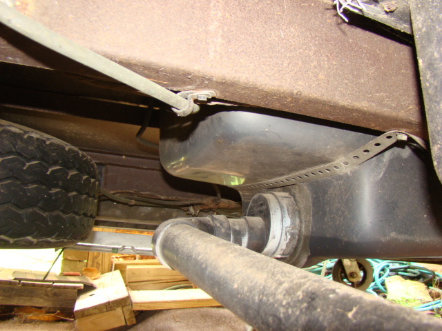

Gray water tank  is 9 gal. Fresh water tank is 13 gal. The black water tank is directly under the commode. The shower is connected to the Black water tank. ; the Gray water tank has a pipe down to the drain valve.  I put wire (Hardware cloth) where rats (mice) were getting into the coach, I put great stuff where pipes entered the coach. I found a very large hole between the commode and the tank where the pipe came down into the tank, thus the welded wire (hardware cloth).
#4490=Gray water tank with drain into drain valve.
#4492= shower "P" trap into black water tank. Donut looking thing is Great Stuff.
#4493= another shot of Gray water tank an black water tank is top right
#4494= Gray tank slider valve going into the "Y" main drain coming from BLK tank.
#44995= Hardware cloth closing in over the Black water tank (keeps critters out).
#44998= showing main drain valve cap and outside of the Black water tank.
#4499= another shot of the Gray water tank, spare tire.DSC04499.JPG.b6999d5103592dafe017474336c33bc5.JPG
Hope this will help you decide something on yours. OH ! I didn't get any measurements !

best plastic was the major supplier of waste and fresh water tanks for RV factories in Elkhart.as for the wheel sun land express put wheels on the frame to keep from bottoming out the waste tanks .mine came with wheels on each side of the frame rails behind the waste tanks. the wheel on his sun land  is not a factory wheel . somebody put a caster type wheel on his. Sun land wheels look like wheelie wheels on each side of the frame
