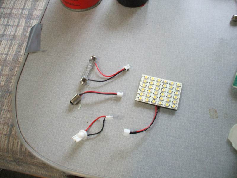

waiter Posted June 11, 2011 Posted June 11, 2011 This topic had been discussed several times. I was convinced that LED lighting was the way to go. They consume 1/10 the amps as conventional 1141 bulbs, and put out the same color and brightness as the 1141 bulb. I had originally purchased one type LED but wasn't satisfied with the color or brightness, it was blue and not as bright. (The bulb on the left in the two photos) Then Krliov, RVDaytrader, and several others found LEDs that were mounted on a circuit card, this LED had color and brightness that resembled a regular 1141 bulb, very nice indeed. (Goto E-bay and search "High Power 36-1210 SMD LED") They cost about $5 each EDITED 9 JAN 2012 - Search e-bay # "320756868072" or "36-1210 SMD LED" Make sure you select the "Warm White" LEDs. The "White" LEDs will be more blue in color. I ordered 10 of these and installed several before the Alaska trip. I originally soldered the wires to a 1141base and used the self adhesive strip to mount the light in the fixture. During the Alaska trip we had ample opportunity to evaluate these LEDs We loved them. However, the self adhesive strip would loose its grip and the LED card would fall down against the lens cover. I decided to permanently mount these LEDs in all the light fixtures in my ToyHouse and rather than use the self adhesive strips, I would glue the circuit card LEDs to the fixture using heavy duty urethane construction adhesive (better than liquid nails) 1) Remove the fixture from the ceiling, cut the old socket off the fixture. Use sandpaper and scratch the surface of the fixture so the glue will be able to bond better. NOTE - While the fixture is torn apart, use this opportunity to spray some contact cleaner/lubricant into the switch. 2) Solder the LED wires to the switch 3) remove the adhesive strip from the circuit card. Clean with acetone, use sand paper to scratch the surface of the card (gives the glue something to bite into.) 4) route the Circuit card wires through the old socket hole and plug in to the switch wire. 5) Verify the LEDs work. 6) squirt glue on the fixture, and also the circuit card. 7) position the circuit card into the fixture. 8) turn the LEDs on. the heat they generate will help cure the glue faster. Let the glue cure for a couple hours then reinstall the lens covers. I'm very happy with the LEDs . They are bright and good color, They conserve my battery when I'm boondocking, and I'll never need to worry about replacing burnt out bulbs or crappy sockets. Look at this posting: http://toyotamotorho...?showtopic=3615 RVDayTrader took some photos of one fixture with this LED and the other fixture with a 1141 bulb. Which one is which??? John Mc 88 Dolphin 4 Auto Quote
waiter Posted June 11, 2011 Author Posted June 11, 2011 FYI - I found the original post for these LEDs. After reviewing it, I found that one of the users (mrgizmow) added a small resistor in series with the LEDs. He said a 67 ohm resistor significantly reduced heat, with very little impact on brightness. I'll give this s try and report back. EDIT - OK, I hooked up some test resistors and tested the light. When hooked up directly (no resistor) I was reading about 0.245 amps 0 ohms > 0.245 amps (3.2 watts) 10 ohm > 0.145 amps (1.9 watts) 33 Ohm > 0.080 amps (1.0 watts) The heat produced was not measured, but should correspond to the power consumed. Light output was not measured but was visibly reduced. The reduced level might be acceptable to some, but I've elected to leave mine as originally configured. John Mc 88 Dolphin 4 Auto Quote

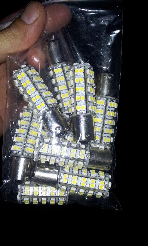

Sunrading Arkansas Posted April 16, 2013 Posted April 16, 2013 Just orders these: http://www.amazon.com/gp/aw/s/ref=is_box_?k=Amico+10+Pcs+Car+1156+BA15S+1206+68-SMD+LED+Tail+Brake+Backup+White+Light+Bulbs Ten for $37 shipped and 280 lumen! I really didn't want to solder anything and i don't think the Cool White color will bother me (the wife will be a whole other story), but for that cheap I figured I'd roll the dice...I'll report back once I get them in. Quote

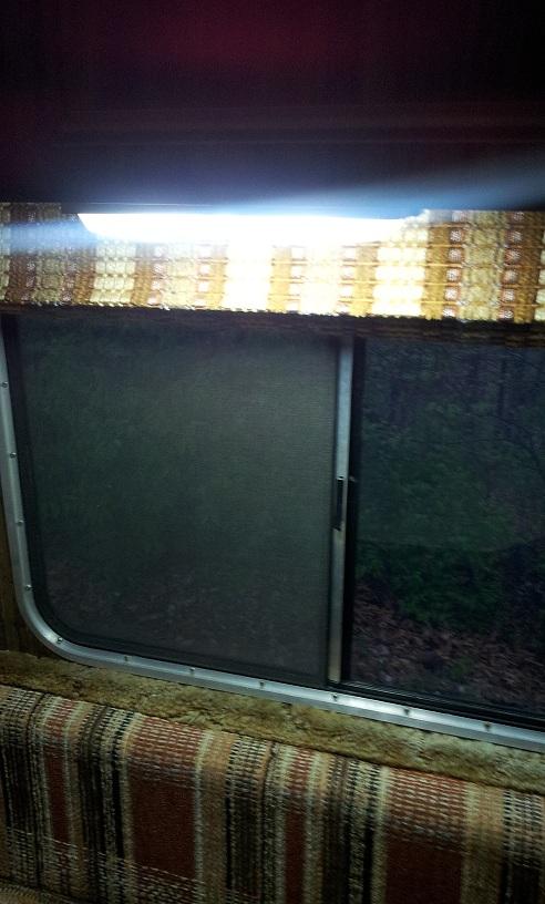

Sunrading Arkansas Posted April 24, 2013 Posted April 24, 2013 Just got my new plug&play LEDs from Amazon (as I had mentioned above) installed... Packaging was sufficient, I guess. Before: And After: Side-by-Side: Out of the 10 bulbs I got (for $37), two were a different color (cool blue) - one of which was loose from its base too (so I will address the seller with these issues). Even so, over all I am satisfied. The LEDs put out an equal or greater amount of light than the origials in a color temperature that is no different than the fluorescence in my home and I didn't break the bank to do it. Quote
Vanman Posted April 26, 2013 Posted April 26, 2013 Sunrading Arkansas Just got my new plug&play LEDs from Amazon (as I had mentioned above) installed... Out of the 10 bulbs I got (for $37), two were a different color (cool blue) - one of which was loose from its base too (so I will address the seller with these issues). Even so, over all I am satisfied. The LEDs put out an equal or greater amount of light than the originals in a color temperature that is no different than the fluorescence in my home and I didn't break the bank to do it. I got this 10 pack today, installed them and just ordered 10 more, very pleased. I did not care for the packaging either, but they all work, so far. The bulb over the range is a #912, 1 A / 12.8 W. So: a 15 SMD LED replacement is 105 lumen 1.44 W; a 28 SMD is 2 W; so I settled on a 20 SMD unknown Watts or lumens. Would like it to be brighter than the bulb is. Quote
