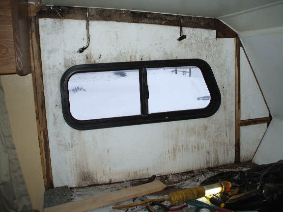

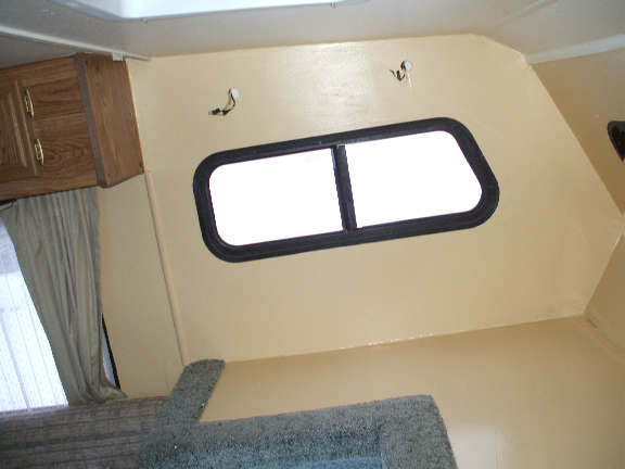

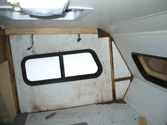

waiter Posted February 7, 2011 Posted February 7, 2011 When I bought this Dolphin, I knew the Top of the cabover was going to need some work. The thin plywood they used had delaminated, ans there was a section across the top that was rotted away. I carefully pulled the delaminated and rotted wood away. ( The two wires hanging from the top are for two reading lamps) A couple Observations; a) I was surprised that the windows were not framed, but simply cut out an opening. The original plywood was glued to the Styrofoam, This does add some structural integrity. Make sure to glue the new stuff to the Styrofoam as well. THE REPAIR I purchased a 4x4 ft piece of 1/4 inch plywood. This is thicker than the original wood. 1) replaced the top support with a new 1x2, I used a polyurethane adhesive to glue the new piece in along the top. NOTE - Test the glue in the corner of the Styrofoam to make sure its not going to dissolve/damage the Styrofoam. 2) made a template out of cardboard to cut the plywood. I took the inner window frame off. Cut and trimmed the template until it fit the framing, and the window frame fit ok. 3) Cut and fit the plywood, I glued across the framing, and also smeared glue on the Styrofoam. Then nailed it to the frame. 4) Used Painters Caulk to fill in some of the gaps and nails. Painted (the two holes are for two lights that need to be mounted. 5) The 1/4 plywood sticks out past the original. A trip to the local lumber store and I got a piece of trim to place over this step, (Its the vertical trim piece in the last photo that runs from the floor to the bottom of the cabinet.) Quote

waiter Posted January 20, 2012 Author Posted January 20, 2012 Just start removing, If your getting into good stuff, use a razor knife to cut a line so the good stuff stays. . a Razor knife cuts through this stuff like butter. Get a couple big garbage bags and keep up with the mess. A couple long screwdrivers to dig out bad wood, also, a pair of good wire cutters to cut staples and nails with. The only problem with thicker plywood is the windows. They may not be able to accommodate the thicker wall. I used 1x2 wood for the replacement frame members, and Liquid Nails to glue it into place. John Mc 88 Dolphin 4 Auto Quote
Dolphinite no longer here Posted January 20, 2012 Posted January 20, 2012 When I replaced the passenger side wall in the cab-over area, I simply used one solid piece of 3/4" AC plywood with a layer if 1/8" door skin glued over it. The thing with the walls in my '85 Dolphin is that 3/4" thick framing is used throughout the whole structure, then 1/8" panelling is glued and stapled over that which makes for a total wall thickness of 7/8". If you go with only the 3/4" ply, the wall will be 1/8" thinner than the surrounding walls. It works out okay if you don't have to butt up to an existing section of wall that runs in the same direction as your new piece. If you're butting up to a wall or panel that runs 90 degrees to the new stuff, you're okay. Make any sense? John Quote

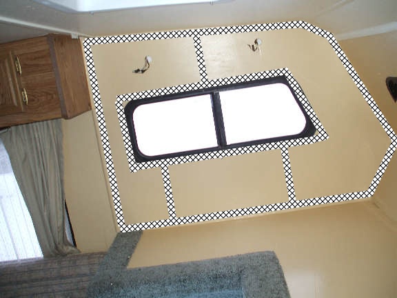

Derek up North Posted January 20, 2012 Posted January 20, 2012 Sounds simple and strong. The only 2 downsides I see are extra weight and a lower R value of plywood vs proper insulation. I'd though of using a sheet of plywood (as you did) but then but then cutting out 'pockets where possible to lose some weight and provide space for Styrofoam insulation. Then 1/8 luan to give the inside surface. Might not be any better than stick-building though. Quote

waiter Posted January 21, 2012 Author Posted January 21, 2012 OH, I see what your saying. Yes. Do a test to make sure thickness is OK. Remove any foam and just use 3/4 plywood?? Yes, Structurally much stronger. Heavy, not a big deal, might add a few lbs to a couple hundred if you did the entire MH. Thermal Insulation, Not as good, but the big problem thermally is air leaks, so this isn't a big deal. I bet the solid plywood would do a better job of sealing up the MH then the stick and foam. Use glue to bond the outer fiberglass to the plywood, also bond the interior veneer to the plywood. (use one of those trouls for the glue that they use for spreading glue on floors How about the problem of running any wire?? Maybe cut a groove in the plywood with a cheep router and staple the wires in the groove before putting on the veneer,. I like it. John Mc 88 Dolphin 4 Auto Quote
Derek up North Posted January 21, 2012 Posted January 21, 2012 Maybe my earlier description was clear enough, but I was just 'playing' with one of John's pictures and thought I'd post it. The checkered lines represent the 3/4" or 1" plywood, the 'field' would be filled with insulation. Quote
bajadulce Posted January 21, 2012 Posted January 21, 2012 Job well done John. Looks clean. I figured you guys had aluminum siding not fiberglass panels and hence the need for "sticks". Wonder if eliminating the framing altogether and sandwiching some rigid insulation between the exterior fiberglass panel and your interior panel would be adequate. This would make for a nice composite construction and would be both strong and light. You won't be able to bond the panels like a commercial product (nidacore etc), but a good adhesive would probably provide a decent bond. Holey plywood? I've seen a few boats with interiors made of cabinets that had huge holes cut into them to reduce weight. Sounds like a good idea too. Quote
