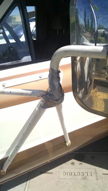

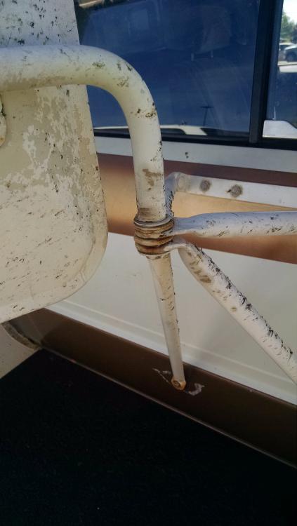

gringostar Posted June 2, 2016 Posted June 2, 2016 Hello all. 1986 mini cruiser. 20 ft. The nuts on the side mirrors are nearly completely rusted. No way to adjust my mirrors. Driver's side is worse. Duct tape lasts about 20 minutes at 55 mph. Where can I get some replacements? Cheap. Quote
Totem Posted June 2, 2016 Posted June 2, 2016 Nappa, autozone? take an angle grinder to the old ones bolt and cut it if its seized ; you should end up with a mount hole it looks like. then use the ones from nearest auto place that has a bolt through mount. Quote
gringostar Posted June 2, 2016 Author Posted June 2, 2016 35 minutes ago, Totem said: Nappa, autozone? take an angle grinder to the old ones bolt and cut it if its seized ; you should end up with a mount hole it looks like. then use the ones from nearest auto place that has a bolt through mount. Ok. So I don't need to replace the whole.assembly just the actual mirror? Quote
Totem Posted June 2, 2016 Posted June 2, 2016 thats up to you; you can use some of the assembly it seems.. so the mirrors seem to be on a "L" shaped mount that goes to the quadra pod thats bolted into the door. to me i would leave the quadra pod part and remove the mirror and L bracket.. this would leave a vertical mount point (where each leg of the quadra pod come together) My current rig has a different style mount but I still used newer mirrors on the factory mount with a bit of ingenuity; seems you could also. Quote
Derek up North Posted June 2, 2016 Posted June 2, 2016 I'll assume that the way it works is that there's a bolt that goes up into the curved part that holds your mirror. The bolt is supposed to hold the 4 'legs' and also be tightened to stop the mirror rotating? And now the bolt is rusted in place and not holding the mirror tight? How about drilling a (small) hole in the curved piece so that you could get some PB Blaster inside above the rusted threads? Or you could always put a torch on it which will usually get any rusted fastener loose. Of course you'll have to repaint. Or you could grab a grinder, but that'll still leave you with the remains of your rusted bolt to remove. Quote
