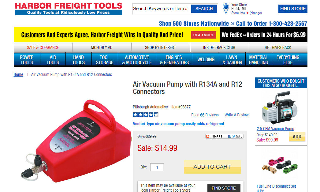

zero Posted February 10, 2015 Posted February 10, 2015 You can buy a "venturi" vacuum pump for $15. Also a cheap electric for $100. Things have changed a lot since we got flooded with cheap stuff from China (and Japan before that). Quote
jjrbus Posted February 10, 2015 Author Posted February 10, 2015 I was eying this' Would be easier to sell. 2.5 CFM 1 Stage Rotary Vane Deep Vacuum Pump Refrigerant AC Air Condition HVAC Seller : taztool (115163 ) 99.1% Positive feedback Follow this seller |See other items | Visit store: Taz Tool Item Information Item condition: New Quantity: More than 10 available / 110 sold Was: US $79.99 You save: $5.60 (7% off) Price: US $74.39 and there is a manifold gauge set for $28 including shipping. It is to the point a tool can be used one time and thrown away. Of course some of them need to be thrown away after one use! JIm SW FL Quote
