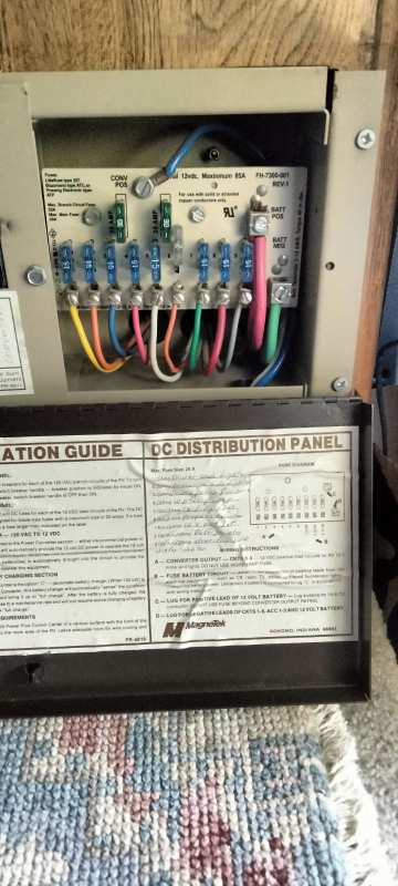

WME Posted April 4, 2024 Posted April 4, 2024 You haven't posted a picture of an inverter!!! Power circuit panel (circuit breakers), power converter and 12v fuse panel Quote

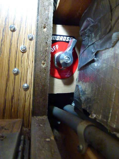

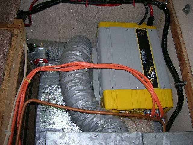

turtle Posted May 14 Posted May 14 8 hours ago, Hoonah said: Which kill switch did you get? The slow drain on the vehicle battery is killing me. I put in a Moroso switch on the coach battery. I mounted it inside the door under the rear dinette bench near the inverter/charger. You can sort of see it in this older pic. I have since upgraded the AC/DC system but the shut off is still in the same place Quote
