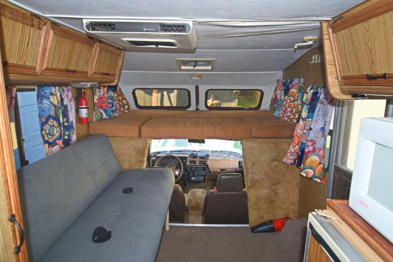

john*thomas Posted May 15, 2021 Posted May 15, 2021 So I noted that I got a 1987 Nissan Odyssey. I'm my searches I've not found a place that has more info on these units than here and Linda in particular. So I thought I'd ask here. I've been cleaning.........what am I missing on the sides of my front doors if anything? Is there supposed to be some sort of seats there? There are stickers on both sides noting that to not use the seats while traveling. Also has my other seat/bed been replaced? Would it really have been a different color? So far everything seems to work. I've not put water in it but what I've tried out has worked. Previous owner smoked and I've almost got the smell out. There were curtains but they are gone. Wife has ordered new ones. Quote
linda s Posted May 16, 2021 Posted May 16, 2021 Yes you have an Odyssey Newport. The resolution isn't good but it looks like seats on either side of the door. Coach issues are all Odyssey things. Yours is just on a different chassis. 1991 Odyssey Americana Brochure - General Discussion - Toyota Motorhome Discussion Board Here's a pic of the chair on one side. http://3.bp.blogspot.com/--PIGRmvA_6o/T57WcseMqgI/AAAAAAAAABs/6smrhMtqmgM/s320/music.jpg looks pretty comfy Linda S Sorry pic won't come up as a pic or a clickable link but copy and paste and you can see it Quote
linda s Posted May 16, 2021 Posted May 16, 2021 Oh and your sofa looks to be original but it is in beautiful shape. They must have kept it covered Linda S Quote

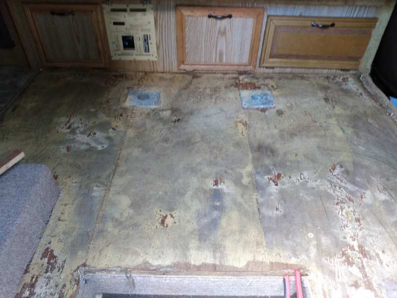

john*thomas Posted September 7, 2021 Author Posted September 7, 2021 My son put down some new flooring for me today. Only took a few hours. We still have a little trim to do but so much better. (old pics are above) I think I have enough to do the back of the cabin divider. I hate that carpet on it. Couple things......as it relates to another thread on spongy floors you can see where my floor is solid. I think I'm going to add a L channel brace underneath just to really firm things up. The new floor has helped also. While I did have leaks you can see where the old carpet had a rubberized pad so the water never really did get to the floor. I almost passed on this because it was so in need of attention when I bought it and the outside still doesn't look all that great but I'm really pretty happy with it now. Runs great and the interior is quite presentable. Quote
Maineah Posted September 8, 2021 Posted September 8, 2021 The AC seal serves two purposes one to keep water out of the camper the other is noise reduction sitting directly on the roof it sounds like a freight train. The seals start life at an inch or more in thickness and are good for maybe 5 years max before they flatten. There is a piece that comes with the gasket that looks like some thing you would throw away it is rectangular the same thickness as the gasket it fit under the long side of the AC unit. Quote
