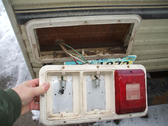

OK, Here's how to make the LED modification:
I removed and cleaned the tail light assemblies and lenses. Keep in mind the outside lamp is the turn signal, and the inside (middle) lamp is the brake light.

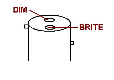

On some of the Super Brite LEDs, you can cut the base off and connect your wires directly to the LED circuit card. I couldn't remember if you could do this with the 1157 series, so I opted to play it safe and just solder wires directly on the bulb bases. I used different colors to keep me straight. My colors don't match the coach colors, so don't get confused.
Solder wires to the metal base and the solder tabs on the bottom of the bulb. Notice how the two guide tabs on the sides of the bulb are at different heights, Orient the bulb to make sure your soldering the wires to the correct solder tab.
post-4544-0-84171300-1299070653_thumb.jp
BLACK = Bulb Base (ground)
YELLOW = Dim (Tail light)
RED= Bright (Brake or turn signal)

I removed (broke them off) the bulb sockets from the fixtures by bending them back and forth until they broke off, Cut the wires and push the wires through the hole to remove the bases.

NOTE- Don't cut the white wire that runs to the three metal plates on the assembly. This wire is needed for the Backup light.
I ran the LED wires through the hole that the original bulb wires went through, and soldered the LED wires to the old Bulb Socket wires. The grounds all get tied together, as do the tail lights. but the outside LED is the turn signal, and the inside (middle) is the brake.

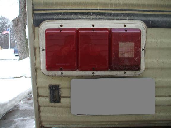

After the glue is cured, pull the tape off, do one final check, then put the lenses back on.
post-4544-0-30187600-1298834812_thumb.jp post-4544-0-01888400-1298834842_thumb.jp post-4544-0-53084200-1298834865_thumb.jp

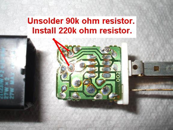

MODIFY YOUR STANDARD FLASHER SO IT'LL WORK WITH LEDs
OK - One of the problems with LED Bulbs, They use so little current, the Flasher thinks there is a bulb burnt out,so it flashes fast.
You can either purchase a LED compatible flashing unit, OR, if your handy with a soldering iron, modify your existing flasher to flash at a slower speed when it senses a burnt out bulb. ( The burnt out flash speed is almost identical to the normal flash speed., but you don't care, as long as it works.

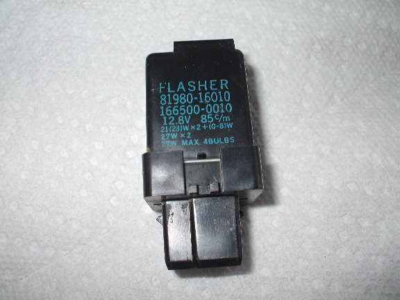

This is your flasher, its located on the drivers kick panel. remove it and carefully take it apart.
post-4544-0-00398400-1298832934_thumb.jp
The 90k ohm resistor shown in the photo is used to establish the flash timing for the Burnt out bulb portion of the flasher.
Your going to replace that 90kohm resistor with a 220k ohm resistor, this will make the flashing time longer, and almost identical to the regular flash rate.
The 90k ohm is very small and tucked up between the relay and two large capacitors.
Unsolder the resistor leads (shown in the photo), and solder the new resistor in place.

Visit Radio Shack and Use the smallest watt 220 k ohm you can find (Ohms isn't real critical, probably between 200k and 240k will work. you can mount it vertical, but may need to put a sleeve on the lead to keep it from shorting out against the relay cage. ( If you can't find a 220k ohm resistor, you can solder two (or more) resistors in series and add their values to come up with the 220k ohms.)
Before putting the relay back together, plug it in and make sure it works at the slower speed.
